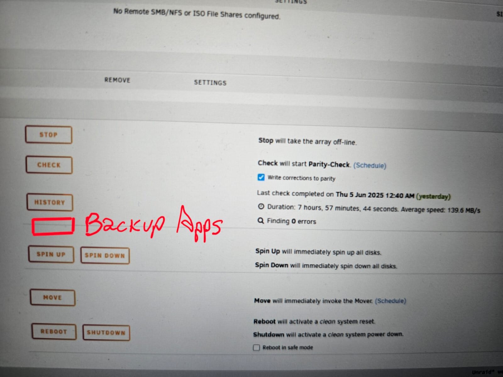

I only use manual backup, I don't use scheduled backup. Would it be possible to add a shortcut to make a manual backup? Does the same happen with the manual move button? It would save a lot of effort
6 hours ago, KluthR said:
Atalho? Onde?
O que você quer dizer com botão de movimentação manual?
something like this
Hm. Dont know if plugins are able to register a button there. But a dashboard tile should be possible.
