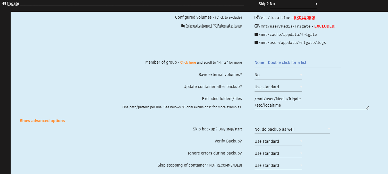

I'm struggling with a frigate container that gets reset on backup. The config file gets deleted and when the container reboots it defaults to standard out of the box settings.
I cant find anything in the backup log. Mapped the log catalog in the frigate container in hopes of catching the bug, but that only shows a boot of a fresh install of frigate.
The same thing happend a while back with a redis and postgresql16 (trimmed for immich) container. The solution in that case was to replace both containers with the same containers form forks.
Ill post some logs if this persist.
Just wanted to check if anyone else have had similar problems.

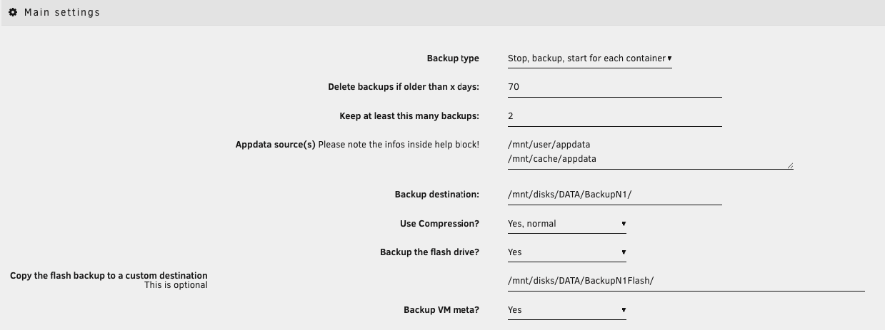

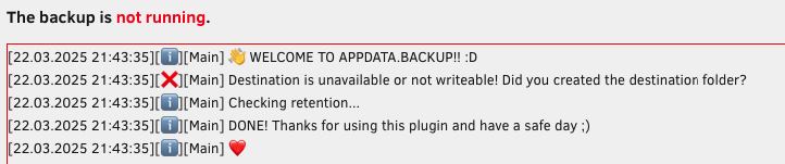

On 3/22/2025 at 9:45 PM, steff_92 said:
I'm trying to backup whole my Unraid conf on an external HDD attached to USB-C port.
I mount it using Unassigned plugin, and made two folder for backup.
When it started manually backup, it get an error for privilegies od something.
I tried everything i know about changing write/read privilegies, changing owner on the folder, recreate them few times, but nothing solves it until now.
Tnx for help.
I found the solution.
I have previous setup destination folder and save the configuration.
When i try now to backup, a change the destination folder, but never click SAVE, instead i try direct manual backup. But the system reads from the saved configuration which is no longer available. I have noticed after few day strugling.
So the answer is, after you change destination driver or some other setting, you must SSAVE IT, and then DO the manual backup.

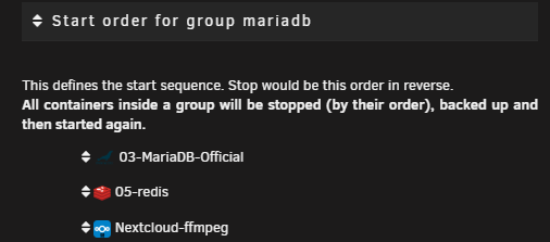

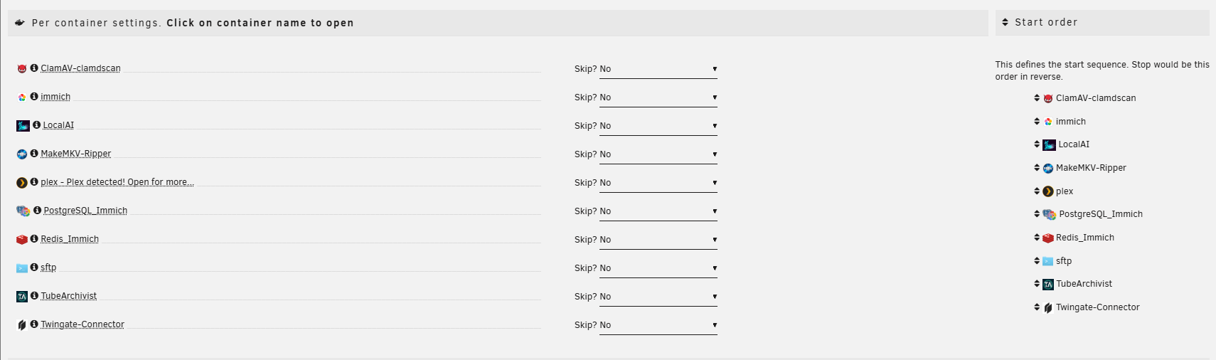

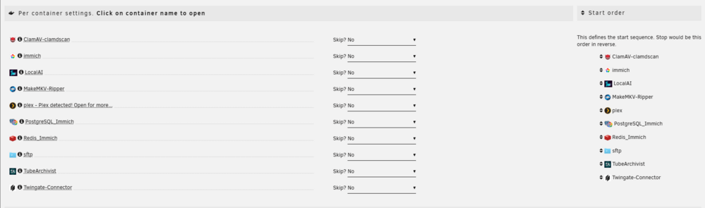

1 hour ago, bmartino1 said:
you will need to make a docker stop script to start before the backup starts and then make a docker start script to run after the backup stuff Finnish to start them in a order....
Not at all, as said just above the plugin supports grouping.
then waht and were are you defining grouping... As I don't see that option and have to use script to stop the docker beforehand to not cause database corruptions...
you referring to the start order?
Immich can't be on if prostgrees and redis are not on...

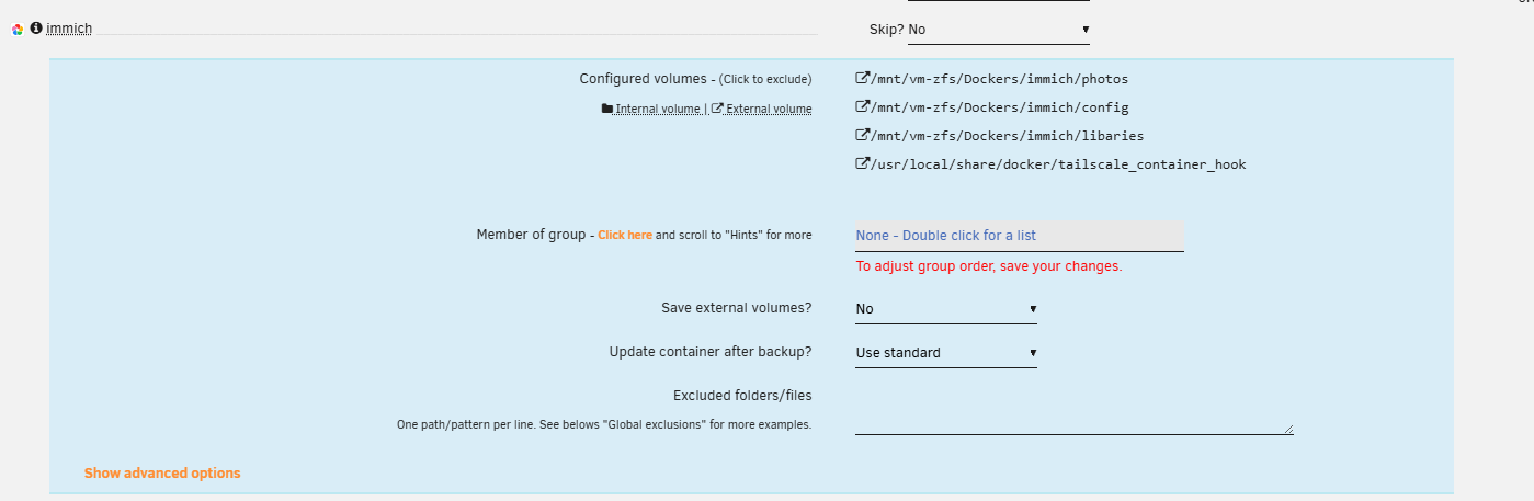

Click on container, set "Member of group", then you'll have them in a separate group you can reorder.
Thank you. hidden menu under the docker name...
new testing to do. Thank you.
sad panda. I double click and try to open the group menu. tried other browers chrome, firefox, edge... incognito modes etc. I can't seem to make a group in the plugin...
Type a group name, save settings, then it'll be available to choose for others.
