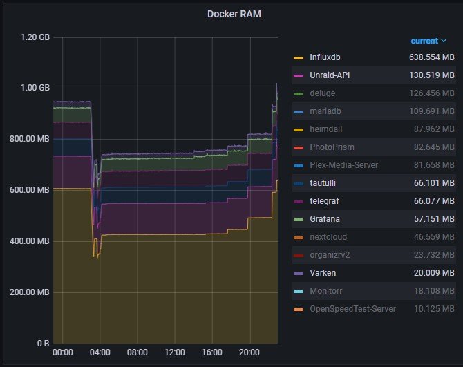

  15. Mine uses between 700-1000MB of RAM for the 6 dockers that compose the UUD. However, over 600MB of that is the Influx docker and I have a lot of devices other than UNRAID writing to my influx docker, so you may likely be around 300MB total. CPU load is between 1.5 to 3% load on a Core i7-4790. It's very periodic, certainly not much of a sustained requirement. Chrome tab to load it is about 195Mb, compared with 105Mb for this page.

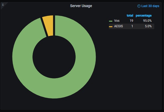

  16. I have gotten Varken/UUD working with multiple Tautulli servers, which are selectable as a variable in the dashboard. If anybody is interested in trying to do that, let me know and I can write up the steps. There is one current limitation, as far as I can tell - Varken can be configured to access multiple Tautulli servers but can only notate them as 1,2,...n. To make that meaningful in the dashboard I had to use either rename transformations or name/value overrides to switch from '1' to the friendly name of the server. The server name does not seem to be stored anywhere in the Influx table for Varken.
