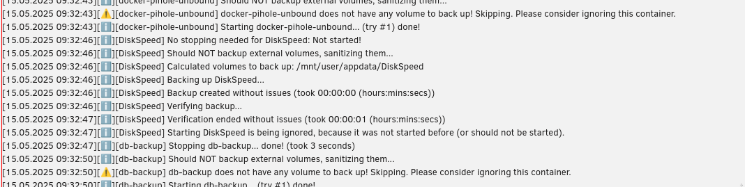

[13.05.2025 03:24:39][❌][immich_machine_learning] 'immich_model-cache' does NOT exist! Please check your mappings! Skipping it for now.
[13.05.2025 03:24:40][ℹ️][immich_machine_learning] Should NOT backup this container at all. Only include it in stop/start. Skipping backup...

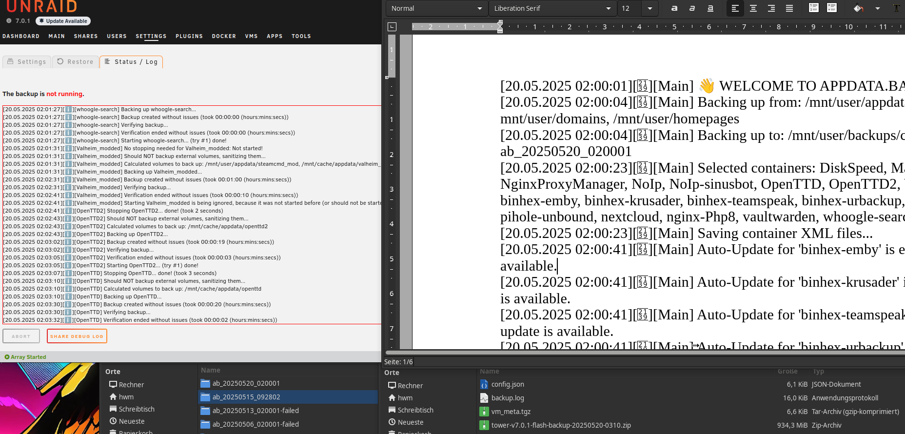

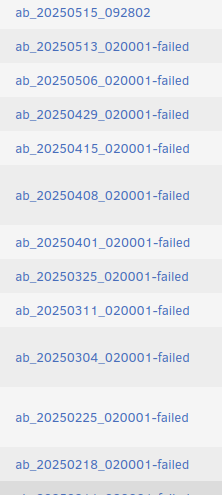

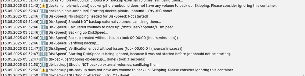

where do i find the log files (this log is just from a manuall backup, i can't find the backup specific one's, if they exist)? i have backups with -failed at the end and there is no logfile attached to that failed backups.
or is it just because of those warnings:
Edited by Holle88
No. Those warnings do not let them fail

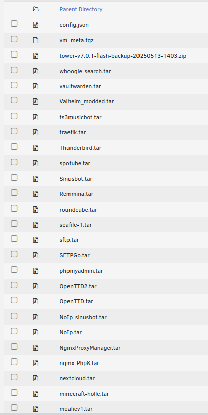

the log should be copied over to those directories. Nothing in there? What is inside of those failed ones?

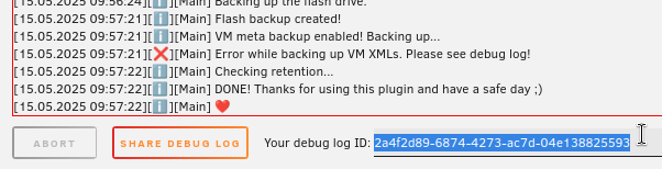

the manual backup just worked fine which i did yet and with ERROR that the VM XML could not be read ( which is clear, because i stopped VM service which mount the libvirt to my libvirt.img which then there is no access).
but it (the manual backup i did now) is also not marked as failed anyway.

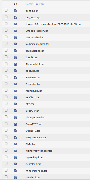

there is no logfile contained in the directories (there is just a config.json with the backupsettings itself).
the backups itself looks intact (this is one of the "failed" one's)

but that's what i am telling you: it is not the issue and also in the failed one's the VM metadata is perfectly backed up. the Error was now only on the manual backup because the virths VM service was not running AND it is NOT marked as failed....
Edited by Holle88

@KluthR nvm: the manual backup i did, fixed all my problems: backups not marked as failed anymore, i can see the log from the last automated backup in the browser log and there is now a logfile in the backupdir.
so i have not changed anything in settings just done the manual backup and everything is working properly in automated backups now again.
it looks like the manual backup has reset some value or variable that caused the problem. just wanted to let you know.
