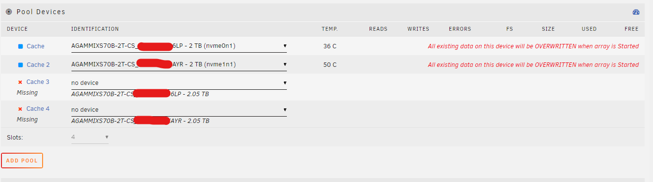

  8. It doesn't appear so, I get quite a nice red warning All existing data on this device will be OVERWRITTEN when array is Started bridge-diagnostics-20231023-1030.zip
  9. Thank you they were removed, However now the NVMes are listed as Cache 3 and Cache 4. How can I move them up to 0 and 1?
  10. I've upgraded my system from 2 sata ssds to 2 nvme ssds. When I started up the array I added the 2 nvmes to the same pool as the existing 2 satas. i.e. there are now 4 drives in the pool. As far as I can tell they are raid 1. Clicking cache says: Data, RAID1: total=206.00GiB, used=204.18GiB System, RAID1: total=32.00MiB, used=48.00KiB Metadata, RAID1: total=2.00GiB, used=1.14GiB GlobalReserve, single: total=341.97MiB, used=0.00B No balance found on '/mnt/cache' Current usage ratio: 99.1 % --- No Balance required I want to remove the 2 satas. I thought I could just stop array and says pool has 2 disks but I can't lower it. So what's the procedure to simply remove the drives and let it 'rebalance' (I think) to just the 2 nvmes? bridge-diagnostics-20231022-1536.zip
