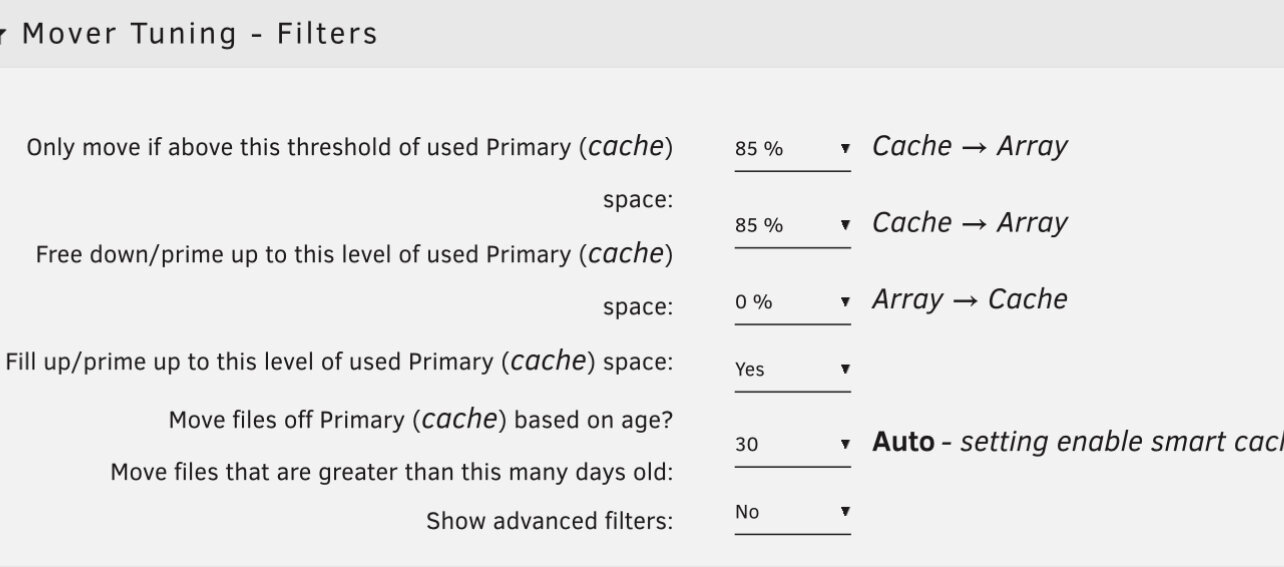

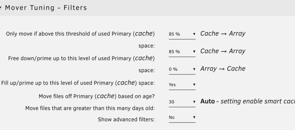

Can anyone tell me if i have this right? The way ive set it, it only moves stuff that’s older than 30 days IF 85% or more of the cache is full, right? The old mover tuning had a “force move it over xx% of cache” which i really liked bc that way if i have no files over 30 days old it wouldn’t keep them in cache if it got more full than 85% or whatever i set it to. IMG_6491.thumb.jpeg.1e2d835befdaac0e5696587fc59fcd6c.jpeg
I can tell you that you are on the wrong support thread.
You can go directly to the correct support thread for any of your plugins by clicking its Support link in the Plugins page of your Unraid webUI.

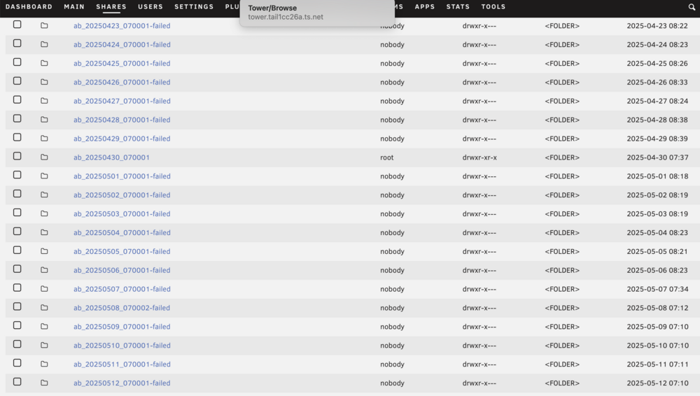

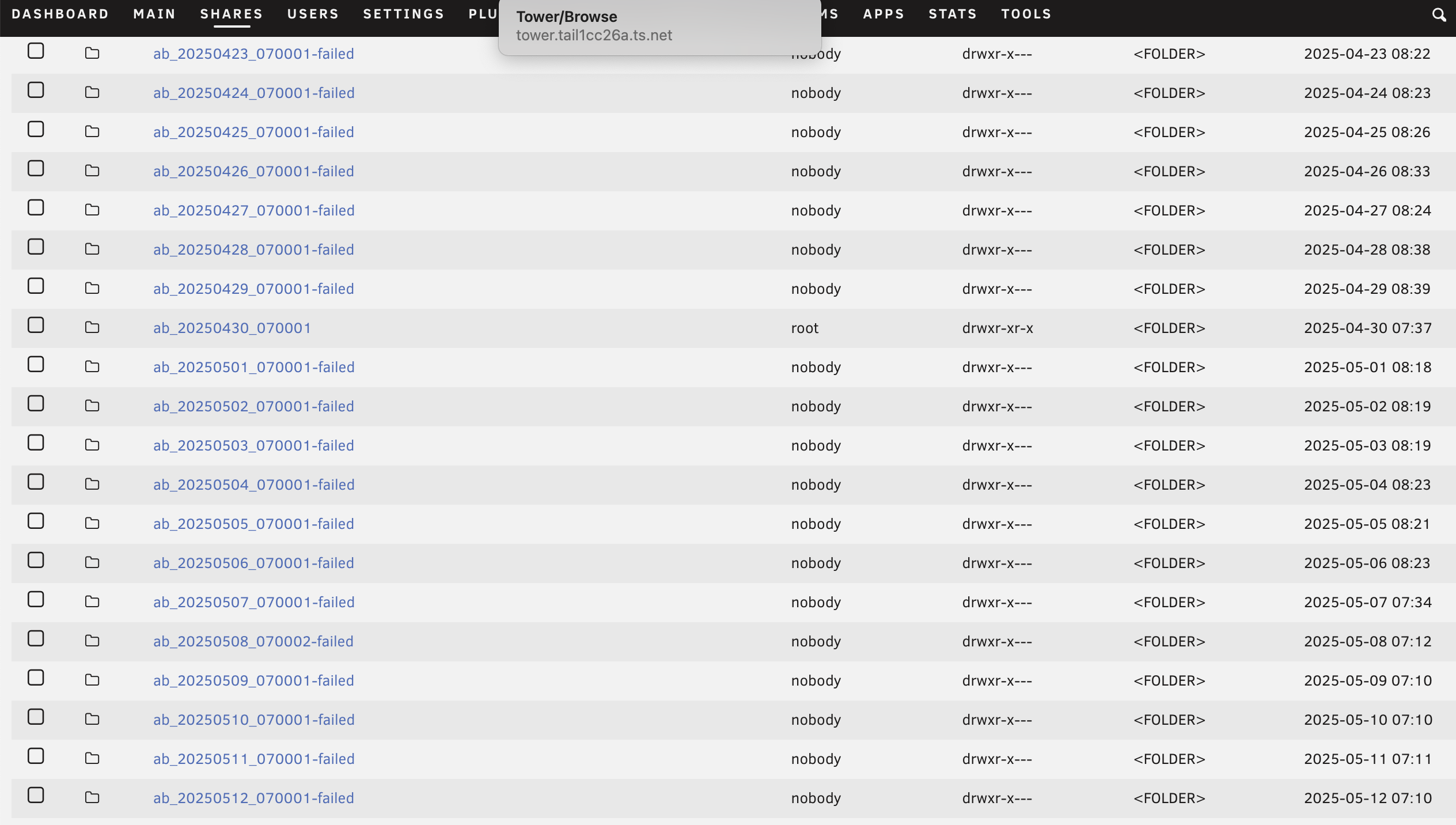

Greetings....Been thus this for a long time, so thanks!  I did receive my first error ever last night where none of my dockers restarted.  I can not seem to find the local degug log, looked and looked and can just find the backup log which tells me to look in the debug log. ;)   (I can find no TMP directory anywhere.)   But it seems I can share it with the developer for help...So...HELP!  ;)
If I reboot the server, all dockers come back started.  If I try running a backup, they fail again to restart.
(I am not out of drive space anywhere.)
9b514ef6-4d0c-45be-8da9-6c709178a192   Looking forward to a response.
Thank you.
UPDATE: So I restarted the server again and tried a manual backup again and it seemed to work without issue.  Still would like to know what the degug log reported as to an issue.  Pondering.
David
Edited by David Bott
/tmp/appdata.backup/
They'll be gone if you rebooted though, so copy straight away if you have an error again.

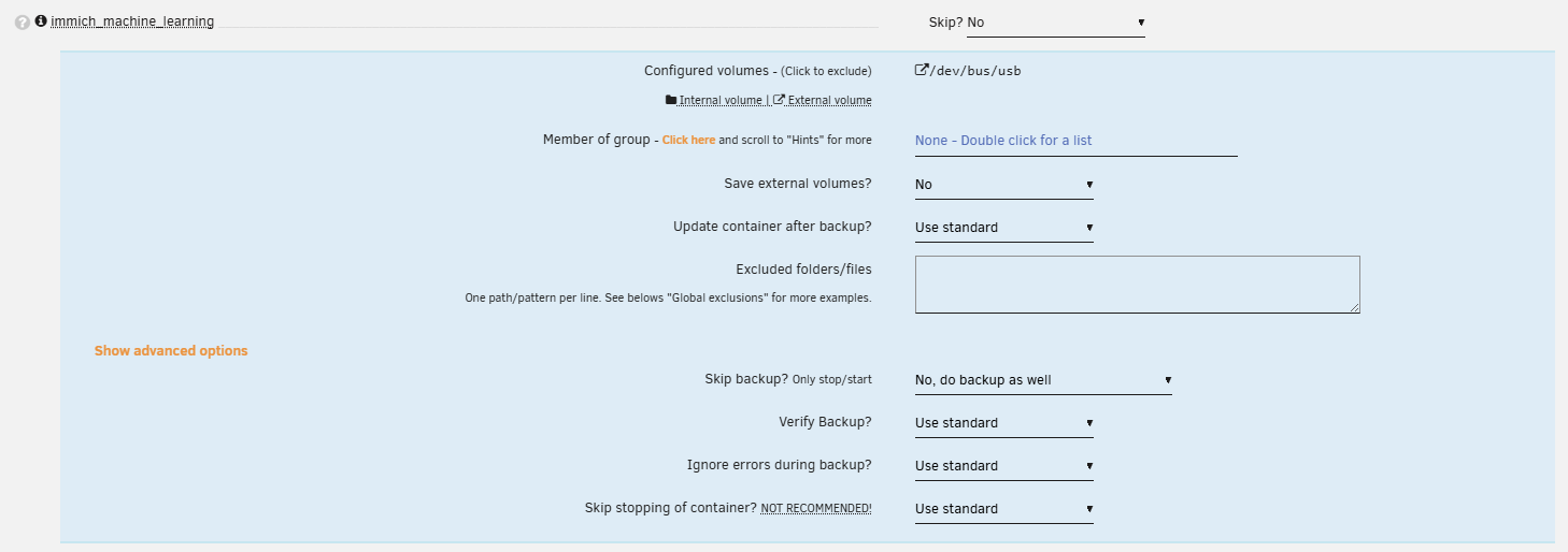

In the last two days, my Appdata Backups fails with an error message.
Before, it was working fine, nothing changed to the immich compose, so I am not really sure where this is coming from?
Maybe you guys have any hints?
Appdata Backup fails at this point:
[10.05.2025 03:25:56][❌][immich_machine_learning] 'immich_model-cache' does NOT exist! Please check your mappings! Skipping it for now.
[10.05.2025 03:25:56][ℹ️][immich_machine_learning] Should NOT backup external volumes, sanitizing them...
[10.05.2025 03:25:56][⚠️][immich_machine_learning] immich_machine_learning does not have any volume to back up! Skipping. Please consider ignoring this container.
My compose has a volume mapping
  immich-machine-learning:
    container_name: immich_machine_learning
    image: ghcr.io/immich-app/immich-machine-learning:${IMMICH_VERSION:-release}-openvino
    volumes:
      - /dev/bus/usb:/dev/bus/usb
      - model-cache:/cache
The volume itself is available on the host
root@cloud:~# docker volume inspect immich_model-cache
        "CreatedAt": "2025-01-11T15:26:28+01:00",
        "Driver": "local",
        "Labels": {
            "com.docker.compose.project": "immich",
            "com.docker.compose.version": "2.29.2",
            "com.docker.compose.volume": "model-cache"
        "Mountpoint": "/var/lib/docker/volumes/immich_model-cache/_data",
        "Name": "immich_model-cache",
        "Options": null,
        "Scope": "local"
root@cloud:~# ls -la "/var/lib/docker/volumes/immich_model-cache/_data"
total 4
drwxr-xr-x 4 root root 4 Feb  5 16:36 ./
drwx-----x 3 root root 3 Jan 11 15:26 ../
drwxr-xr-x 3 root root 3 Feb  5 16:36 clip/
drwxr-xr-x 3 root root 3 Feb  5 16:36 facial-recognition/
In the settings, there is no immich_model-cache volume specified nor deselectable
Edited by mil4N
Yes. Named volumes are not supported at this moment. Only bind-mounts.
