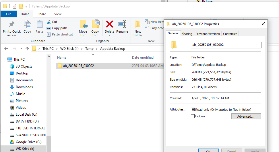

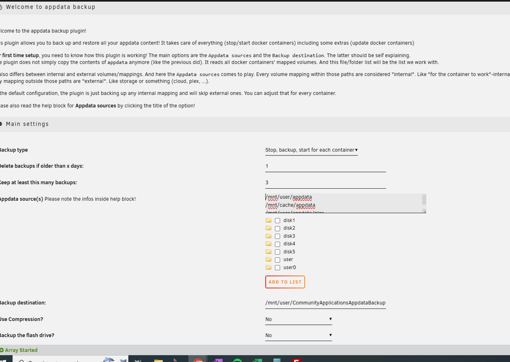

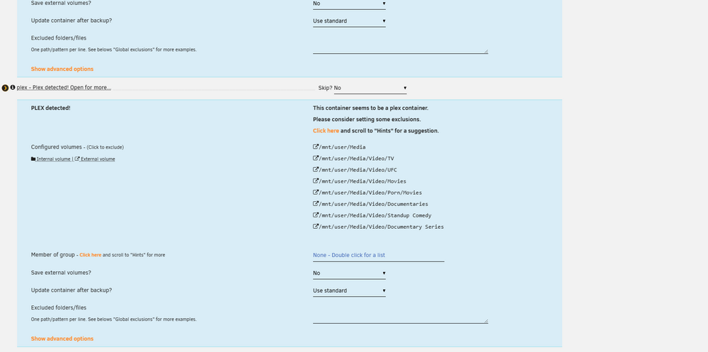

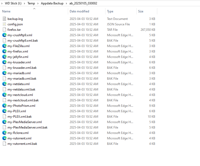

I have my current appdata set to back up 3 days worth of data:
This equals 72.1GB. All I have is firefox, plex and netdata dockers. My Plex alone is 32.8GB and photoprism (which I don't use anymore is another 32GB) but I am confused because the appdata backups are only 260MB and most of the data is from my firefox docker, wtf.
Also, if you see my unraid config above it's set to delete older than 1 day but to keep up to 3 days and below, I have one backup a month only. I am very confused an hoping someone can ELI5

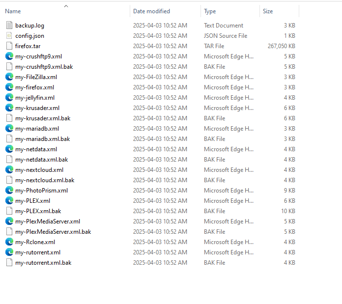

What's in the folders? What's the scheduling set to? You told it to keep 3 folders and you have 3 (plus something that's probably from something else than this plugin from back in 2023).
It's set to the 5th of the month, which makes sense about monthly now
this is in the folders:
Edited by sanfark

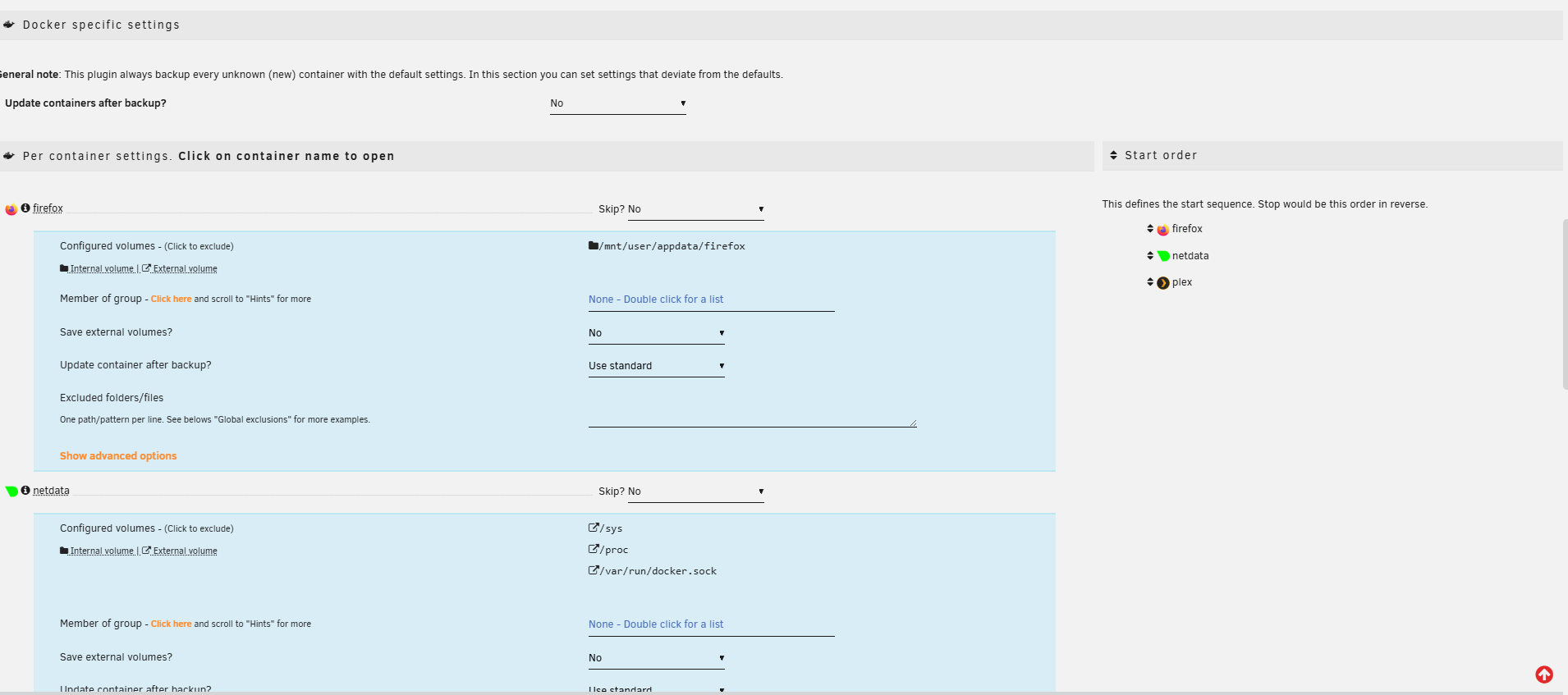

That shows only firefox being backed up. But that doesn't seem to be on the destination directly, seems like a copy somewhere else that may or may not include everything for some reason.
So my appdata is not actually being backed up. Plex is at risk (all I care about)?
Is there some sort of logs I can provide that can help? I simply downloaded this plugin, set it up once and let it go. Doesn't seem like it's doing what it's supposed to be doing
You still didn't show how you set it up. What are the container-specific settings? What data is on the set destination itself? How does stuff end up on your I: drive? That wouldn't be the plugin doing it.
Plugin does what it should unless configured wrong.
How does stuff end up on your I: drive?I
It does not. just copied appdata backup from server to my I drive so I could see the size and look through it in windows. I:\ drive is a separate windows PC
You still didn't show how you set it up. I don't know what else you are looking for, let me know and I can provide
I am backing up (just realize I essentially have /mnt/user/appdata/plex twice):
/mnt/user/appdata
/mnt/cache/appdata
The data was the one in picture I shared.

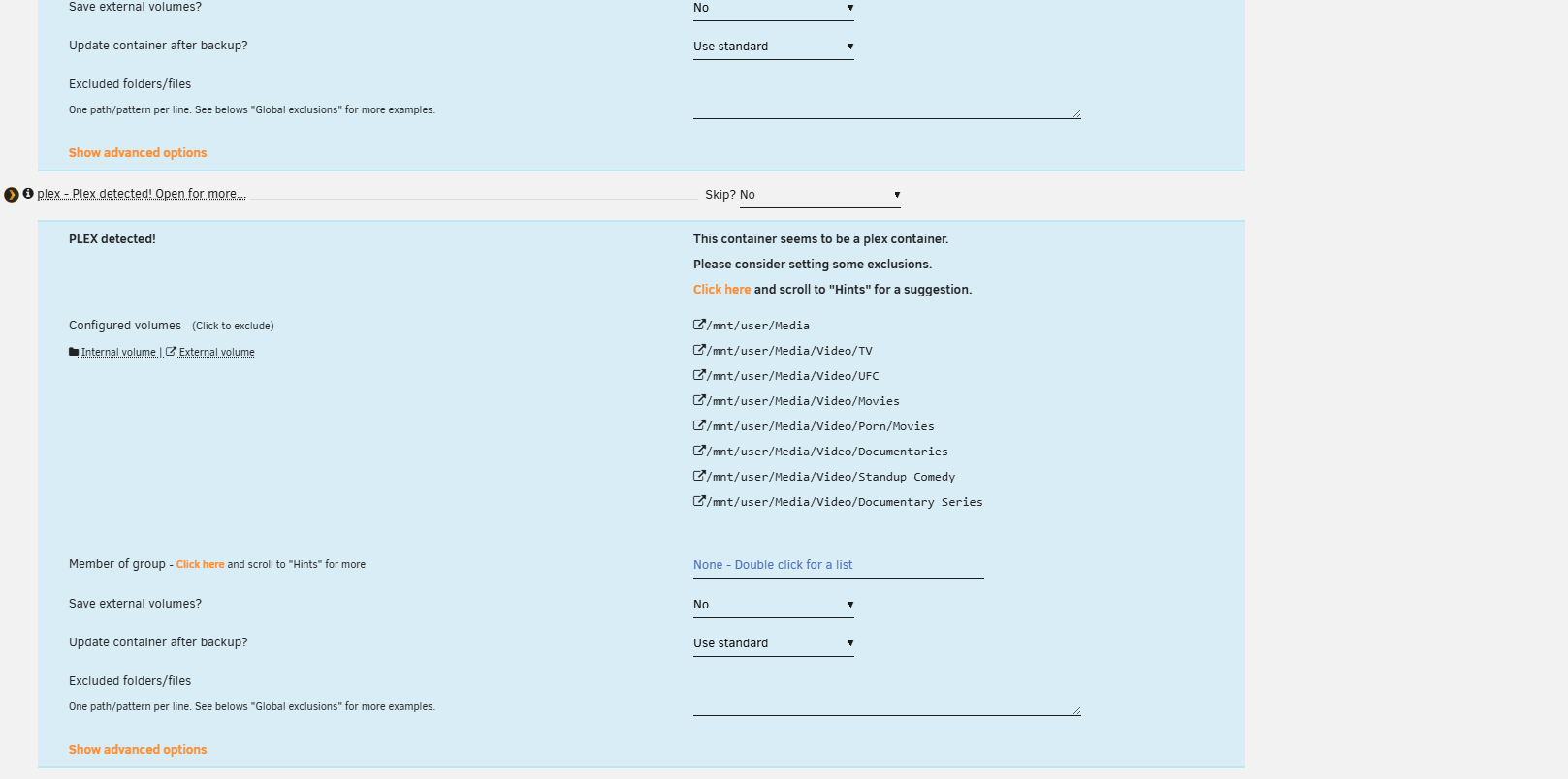

/mnt/user/appdata
/mnt/cache/appdata
Are you talking about appdata sources? Then The first both are sufficient.
The best in this case would be: Let it run (if not already) and share a debug log.
That one's redundant
That shows Plex does not have any configured appdata path, so it seems the Plex template itself is configured wrong, unrelated to this plugin.
There should be an appdata path, that would then show with the "Internal volume" icon and be backed up.
I was asking for checking on unraid itself in its file browser or terminal in case whatever method you used to copy to your external drive skipped some stuff. But it's moot, the issue is above.

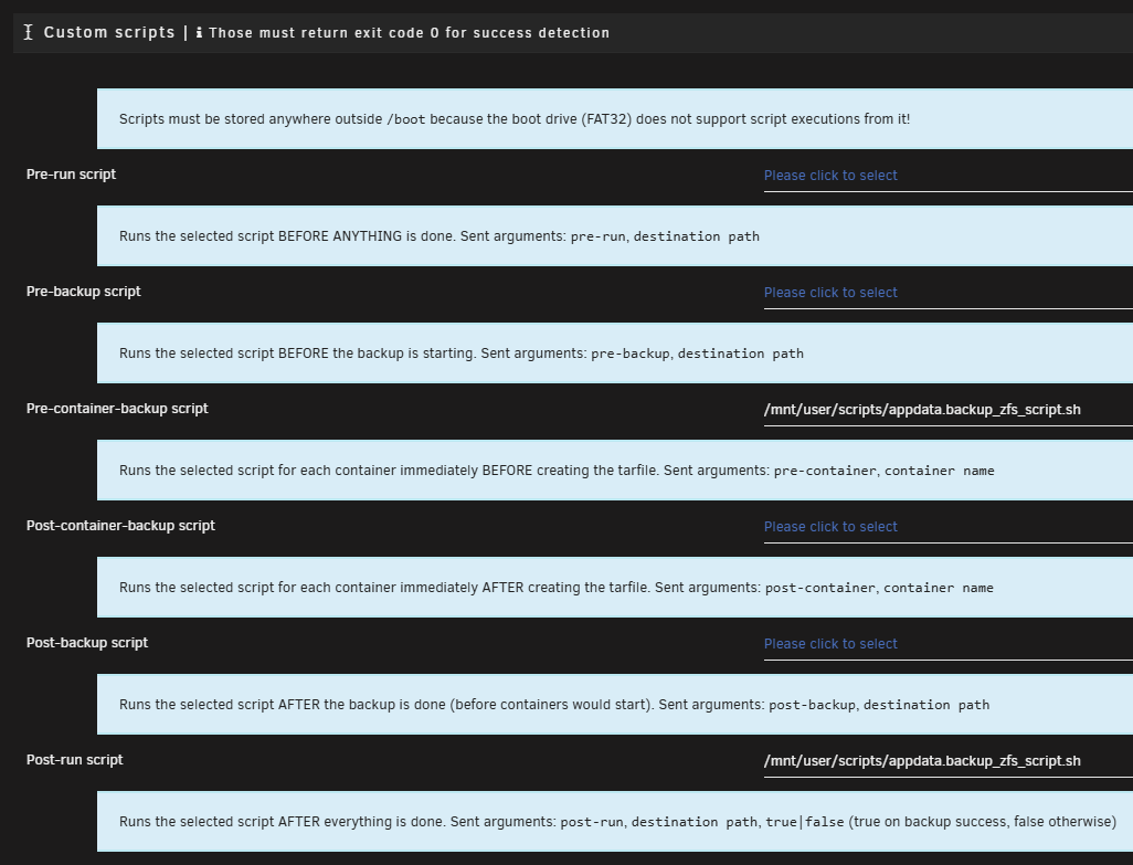

What are the arguments that can be sent to a custom script?  What is the argument for a filename and/or full path?
Is there a list of common post scripts?  I'm looking for a script that will copy the backup file to a second location.
You can click on the script types to expand the help option that shows all the available arguments (see screenshot).
Here is an untested 'post-run' script to rsync the backup folder to another destination. I made it fairly quickly with AI but it looks solid.

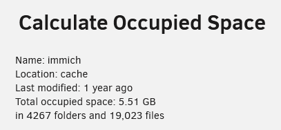

i noticed that the duration of the backups in the log dont check the day... my Immich Backup took about 25h but log says about 1h. Nothing important, just wanted to share this
25 hours???
Something seems off, unless you are a professional photog with dozens of TB of RAW photos on your server.
I have just a basic Immich install.  My appdata folder for Immich is 5.5GB and backs up and verified in just over 1 minute.
