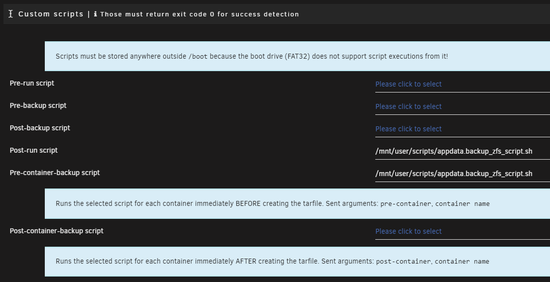

  12. I went ahead and did the pull requests on GitHub. I did three pull requests, one for each file changed, as I have not done a pull request before, and I did not realize that I could have just done one pull request. It was a learning experience, I know now. To keep with the "pre/post script" theme, I added two custom script options. One for running a script before a container backup, and one for just after a container backup. In hindsight, a 'true|false' for the 'Post-container-backup script' would have been consistent with the other post-backup option. In any case, I look forward to seeing any type of "per-container" script that ends up in a future release. Thanks!
  13. That sounds good then, I will change the variable name and create a PR. Before I do, I currently have the per-container script immediately *before* the tarfile is created, but perhaps it would be better served immediately *after* the tarfile is created? It is irrelevant in terms of the zfs snapshots, but perhaps there is more usefulness for other custom scripts after the tarfile is created. There could always be multiple "per-container" script options, but that is perhaps a bit overkill.
  14. I am curious if there are any plans to release the "per container" script option with the next release of the plugin. Long story short, I edited the code myself to create this option, but it would be nice to see this built-in. The reason being, I wrote a custom script for the plugin that I want to share on GitHub. As a "per-container" script, it creates ZFS snapshots of docker containers while they are stopped by the plugin, and then as a "post-run" script, it will optionally create ZFS replications and optionally create tar files from a temporary cloned dataset of the most recent snapshots that were just taken (allows tar backups while dockers are running). Rather than suggest that the user have to edit the PHP files, perhaps it's best I just wait for the feature to be added to the plugin first if it is just around the corner, otherwise I suppose I'll just release the custom script as is. Thanks!
  15. Thanks for this plugin. It's been great! I have a question regarding custom scripts. Would it be possible to be able to run a custom script after dockers are stopped but before anything else happens? Currently, 'pre-backup' custom scripts run before dockers are stopped, and 'post-backup' custom scripts run after backups are done and dockers containers are updated. The reason being is that I wrote some custom ZFS scripts (snapshots, etc) that would ideally work best at the time dockers are stopped and before the update dockers feature happens. I know that 'update dockers' is an option, but I like having my dockers update using the plugin and would like to keep using that feature if possible. Thanks!
