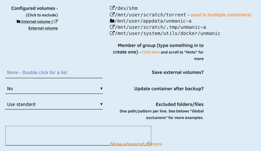

It says to check my mappings but I can only see how to exclude folders, not include. The included folders appear to be auto-generated. I've not really had to make any changes to the plugin previously as it's just kind of worked! Any ideas?
Then excluding them is what you want. Seems to be Docker volume names rather than folders.

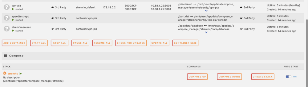

How can I configure Appdata Backup to run docker compose down, back up my stack (with some folders excluded), and then run docker compose up?
When I configure it to back up individual containers (vpn-pia, speedtest-app, stremhu-source), it breaks. I have a specific startup order, and there are also health checks defined in the Compose file, which may be causing the issue.
The only reliable approach seems to be bringing the stack down, performing the backup, and then bringing it back up.

Use pre/post backup scripts to stop/start stacks?
I thought about that. I can also include the stacks directory using Include extra files/folders, but how do I exclude a specific directory in the same way?
Group the containers of the stack so they're all stopped together, and use excludes on each of them as required?

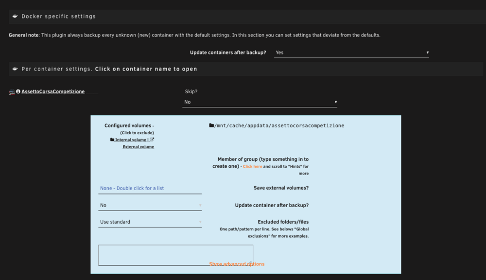

I woke up to a several-hundred GB backup and counting.
Turns out, because of strange wrapping, when I thought I was setting "update container" in fact I was setting "save external volumes."
Makes sense now. Thanks.
Yeah, the UI is still broken for 7.3...
And Iam very sorry to say that Iam not able to fix the UI thing for now. Maybe someone can provide a PR on github

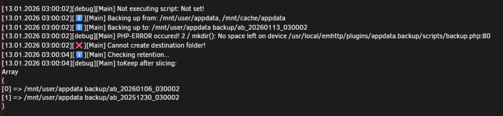

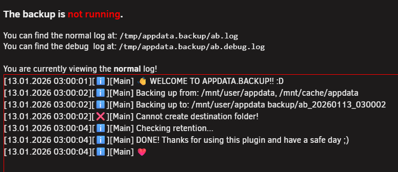

Hi all
One of my servers has just reported an error when Appdata Backup ran overnight.
The error says "Cannot create destination folder";
Any thoughts on why this is erroring and where to start looking to fix it?
Thanks
Edited by SliMat
Says no space, so check drive utilization and the min free space setting for that share.
