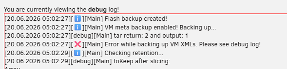

Every day I get a notification of an error with my unraid backup, it says to check the debug log but the error message is the same. How do I go about finding out what the problem is please? The only VM I have running on this server is my OPNSense instance.

[21.06.2026 03:28:55][][sonarr] The container has a delay set, waiting 10 seconds before carrying on
It says to check the debug log, but this is from the Appdata backup debug log.
If I then go into Docker I can start sonarr without issue. I get this with some, but not all, of my docker containers that run under gluetun. Can anyone see what I am doing wrong here?
Edited by showstopper
The amount of posts in this thread is huge, sorry if this has been asked already. Now that there is an internal boot option, is it safe to assume the 'Backup the flash drive?' option works with a boot drive in the same fashion as the flash drive? Thanks
The path to the boot files is just the same as it was before, /boot, so as far as the plugin knows, there is no difference.
On 6/22/2026 at 1:09 PM, showstopper said:
This app is amazing! I have been using it for years but I am definitely now doing something wrong!!
I have gluetunvpn running and I have some dockers that use this network. When the backup runs some of the other containers fail to start. I have been trying to troubleshoot this, but I am now a little stuck!!
I have noticed that I did have my apps the wrong way round in the 'Start order' So now Gluetun is at the bottom and my other containers are at the top. So this means the gluetun gets backed up first, updated and started.
So gluetun backed up at 03:03 and succeeded
[21.06.2026 03:03:00][debug][GluetunVPN] Volume '/mnt/user/appdata/gluetun' IS within AppdataPath '/mnt/user/appdata'!
[21.06.2026 03:03:00][][GluetunVPN] Should NOT backup external volumes, sanitizing them...
[21.06.2026 03:03:00][][GluetunVPN] Calculated volumes to back up: /mnt/user/appdata/gluetun
[21.06.2026 03:03:00][debug][GluetunVPN] Target archive: /mnt/user/backup/appdata_backup/ab_20260621_030002/GluetunVPN.tar.gz
[21.06.2026 03:03:00][debug][GluetunVPN] Generated tar command: --exclude '/usr/local/share/docker/tailscale_container_hook' -c -P -z -f '/mnt/user/backup/appdata_backup/ab_20260621_030002/GluetunVPN.tar.gz' '/mnt/user/appdata/gluetun'
[21.06.2026 03:03:00][][GluetunVPN] Backing up GluetunVPN...
[21.06.2026 03:03:00][debug][GluetunVPN] Tar out:
[21.06.2026 03:03:00][][GluetunVPN] Backup created without issues (took 00:00:00 (hours:mins:secs))
[21.06.2026 03:03:00][][GluetunVPN] Skipping verification for this container because its not wanted!
[21.06.2026 03:03:00][debug][GluetunVPN] Not executing script: Not set!
[21.06.2026 03:03:00][][GluetunVPN] Installing planned update for GluetunVPN...
[21.06.2026 03:03:03][][GluetunVPN] Starting GluetunVPN... (try #1) done!
Here you can see that sonarr started at 03:28 and failed to start:
[21.06.2026 03:28:36][debug][sonarr] Volume '/mnt/user/appdata/sonarr' IS within AppdataPath '/mnt/user/appdata'!
[21.06.2026 03:28:36][][sonarr] Should NOT backup external volumes, sanitizing them...
[21.06.2026 03:28:36][][sonarr] Calculated volumes to back up: /mnt/user/appdata/sonarr
[21.06.2026 03:28:36][debug][sonarr] Target archive: /mnt/user/backup/appdata_backup/ab_20260621_030002/sonarr.tar.gz
[21.06.2026 03:28:36][debug][sonarr] Generated tar command: --exclude '/usr/local/share/docker/tailscale_container_hook' -c -P -z -f '/mnt/user/backup/appdata_backup/ab_20260621_030002/sonarr.tar.gz' '/mnt/user/appdata/sonarr'
[21.06.2026 03:28:36][][sonarr] Backing up sonarr...
[21.06.2026 03:28:43][debug][sonarr] Tar out:
[21.06.2026 03:28:43][][sonarr] Backup created without issues (took 00:00:07 (hours:mins:secs))
[21.06.2026 03:28:43][][sonarr] Skipping verification for this container because its not wanted!
[21.06.2026 03:28:43][debug][sonarr] Not executing script: Not set!
[21.06.2026 03:28:43][][sonarr] Starting sonarr... (try #1) Container 'sonarr' did not started! - Code: Server error
[21.06.2026 03:28:48][][sonarr] Starting sonarr... (try #2) Container 'sonarr' did not started! - Code: Server error
[21.06.2026 03:28:53][][sonarr] Starting sonarr... (try #3) Container 'sonarr' did not started! - Code: Server error
[21.06.2026 03:28:53][][sonarr] Container 'sonarr' did not started after multiple tries, skipping. More infos in debug log
