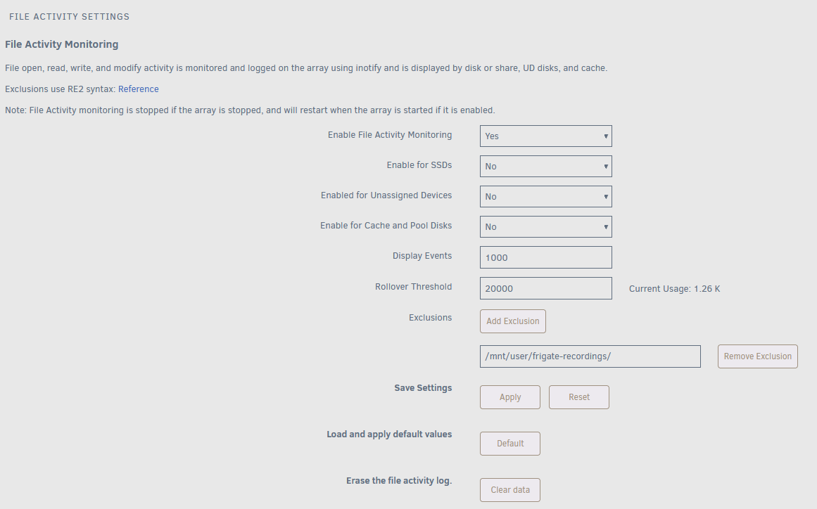

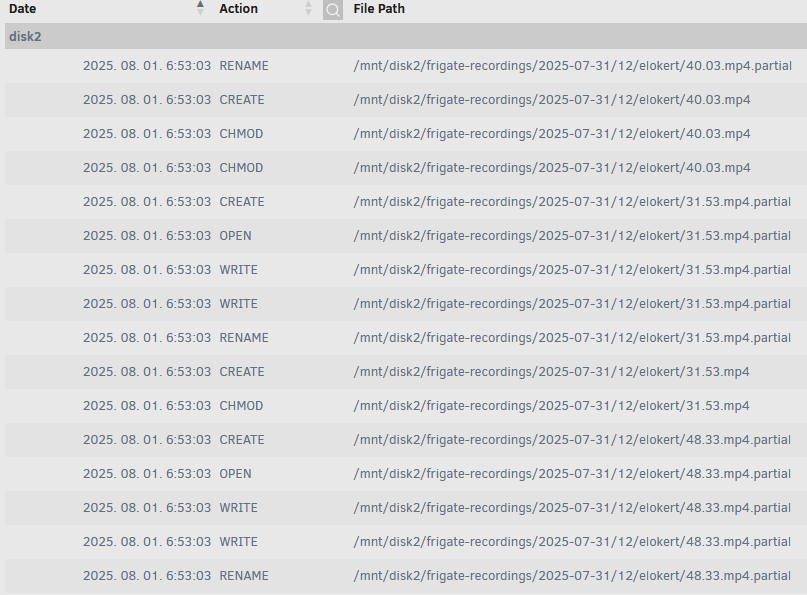

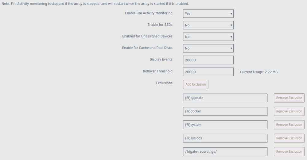

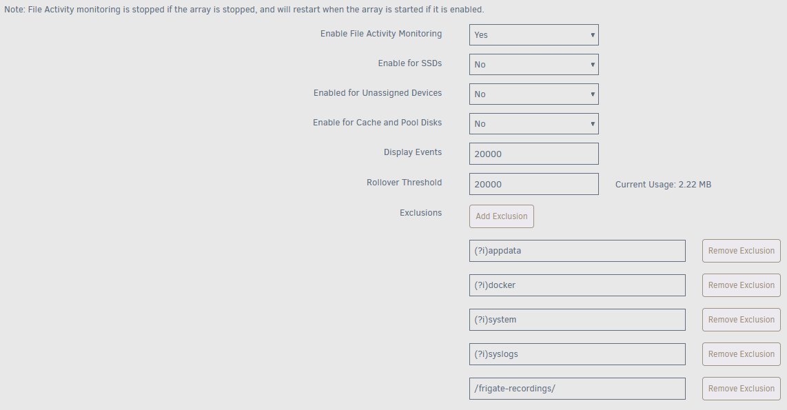

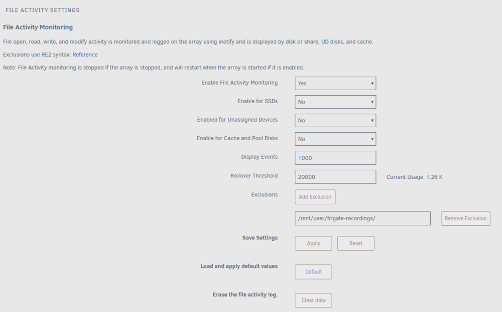

  9. I tried it, but it picked up the folder that was excluded:
  10. Hi! I'm trying to add a share as exception, but it does not seem to work. Am I doing it wrong?
