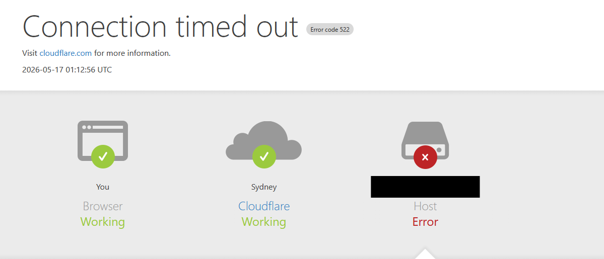

[Support] kru-x - wordpress
I have cloudflare forward to Nginx Proxy Manager which then points to Wordpress. I have had no issues for years and then it stopped connecting and times out. I checked the logs and keep getting errors about the ServerName which I'm assuming is the problem. AH00558: apache2: Could not reliably determine the server's fully qualified domain name, using 172.18.0.14. Set the 'ServerName' directive globally to suppress this messageI have checked the domain name in wp_options in the MariaDB database. It is the correct domain. I cannot work out how to fix this. Does anybody have any ideas?
I got the same issue. I haven't changed anything. It had been working fine for years. I'm assuming an update has caused this. How did you end up fixing this? EDIT: I have checked wp_options in the linked MariaDB database and it has the correct URL.

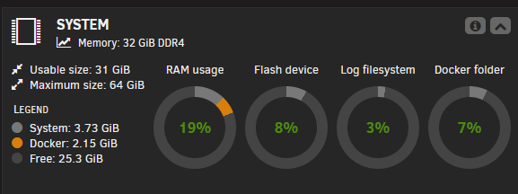

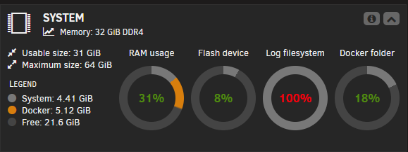

Log Filesystem is full
Pretty sure that is unmanic. Increased the limit to 4gb. Hopefully that should be sufficient.
Hi all, Still a noob at this. I have had Log system at 100% for a while now. Trying to work out what is causing it to fill up. I have not changed it from 128MB. Diagnostics file attached. I think it might be to do with my cache (which I recently replaced). Where would I start to work out what the issue is? Cheers Bobalot tower-diagnostics-20260214-1508.zip
