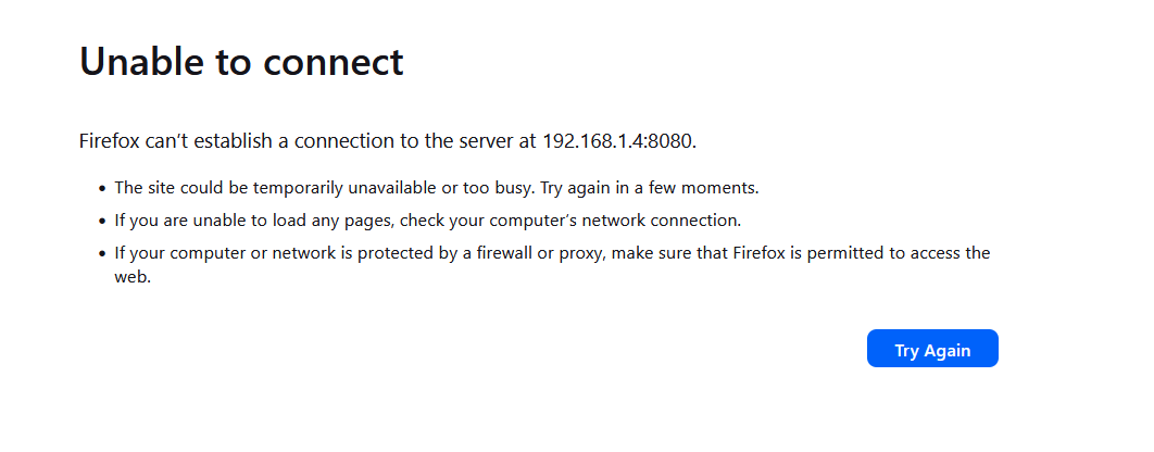

I managed to fix some of them by changing the WebUI from http://[IP]:[PORT] to the hard coded address (192.168.1.4:XXXX). It must have been that plugin. Had to go to work. When I get back from work, I'll remove it all together and see what happens. Most of the dockers are accessible now. A few not working. Not really sure why that plugin is causing and issue if it didn't before my old SSD failed.

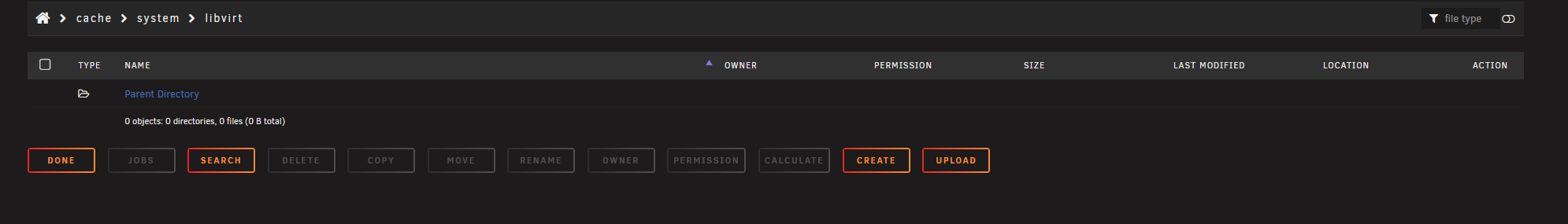

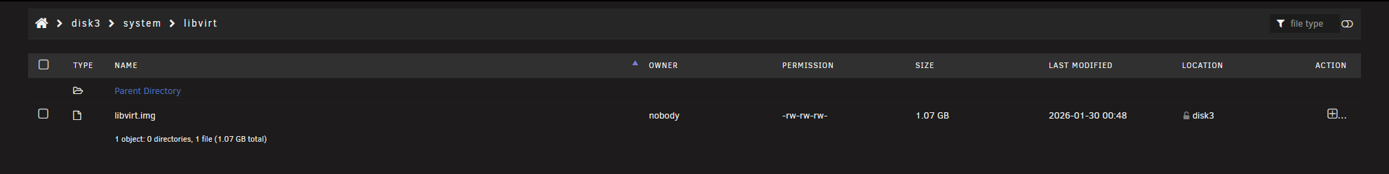

Weird. I thought I have VMs turned off. Thanks. I have turned it off.

That hasn't worked in Foldierview2 for a while (before the SSD failure, plugin needs the dev to update this bug) but I did try that in the apps menu for the dockers that were installed (selecting the docker and clicking webui) and it didn't work. Been checking some other dockers, this issue seems to be limited to anything on the custom docker.

I just type in my IP on the network and the port. It's from another computer on the network. I just noticed that I can access my unmanic docker (which isn't on a custom network - not sure if that is relevant).

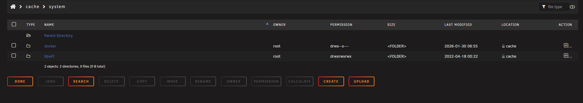

By order. I didn't have a corrupted image. The SSD was dead. I put in a new SSD. A new file system was created and I restored a back up of Appdata using the Appdata backup tool. I restored the previous dockers using the reinstall function in the app area. It has used my old settings. At first, I forgot to create the custom networks and the dockers didn't work. I quickly realised and did recreate the custom docker network. I restarted the dockers but still don't have access.

Hi all, My cache drive failed and I replaced it and used Appdata backup to recover my dockers. After re-installing them all, they appear to be working but I can't access any of them. It just says "Unable to connect". Not really sure how to fix this. Any advice would be appreciated. Cheers. tower-diagnostics-20260130-0751.zip

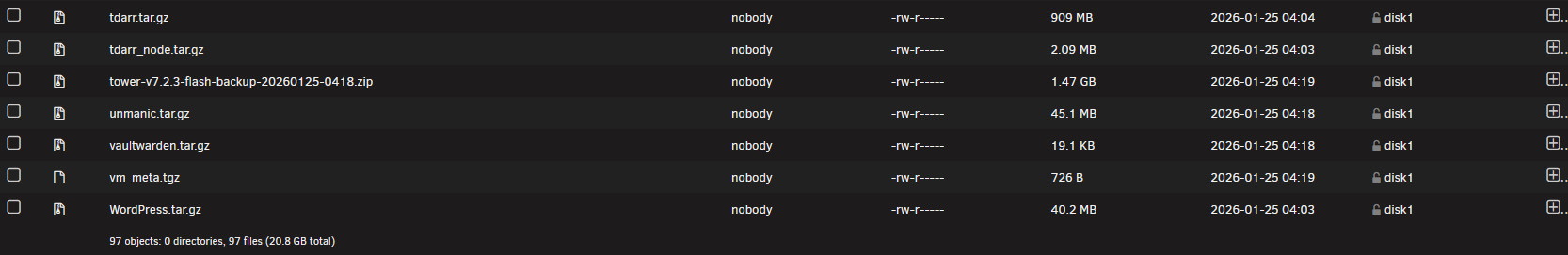

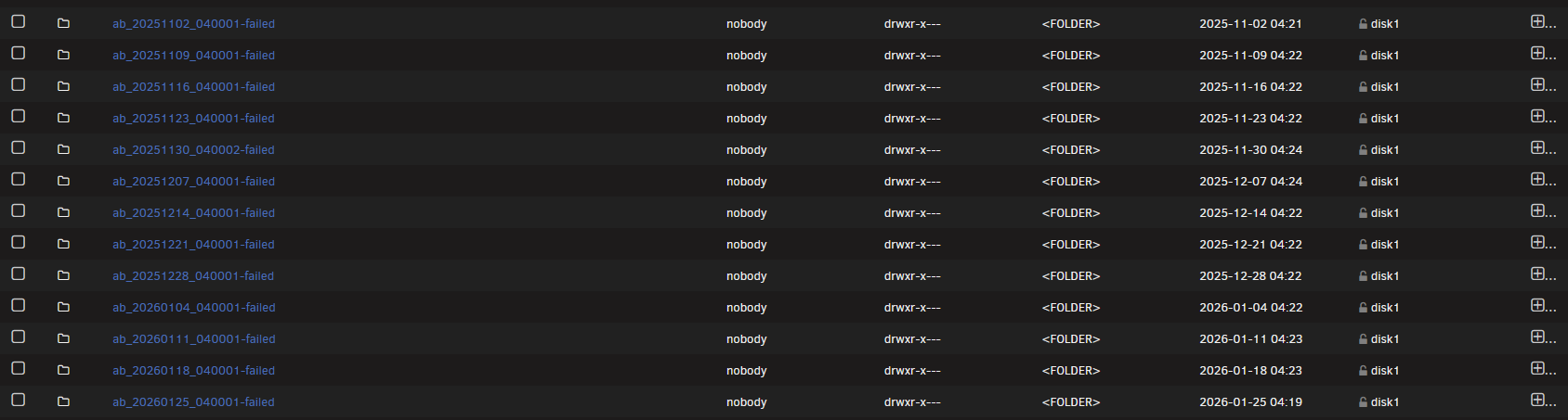

You are right. [25.01.2026 04:04:42][ℹ️][tdarr] Verifying backup... [25.01.2026 04:04:57][❌][tdarr] tar verification failed! Tar said: tar: Removing leading `/' from member names; mnt/user/appdata/tdarr/logs/Tdarr_Node_Log.txt: Mod time differs; This is the only one. Not a major issue if I don't have that one.

I checked the log and the only error was at the end: [25.01.2026 04:18:51][ℹ️][Main] Backing up the flash drive. [25.01.2026 04:19:56][ℹ️][Main] Flash backup created! [25.01.2026 04:19:56][ℹ️][Main] VM meta backup enabled! Backing up... [25.01.2026 04:19:56][ℹ️][Main] Done! [25.01.2026 04:19:56][⚠️][Main] An error occurred during backup! RETENTION WILL NOT BE CHECKED! Please review the log. If you need further assistance, ask in the support forum. [25.01.2026 04:19:56][ℹ️][Main] DONE! Thanks for using this plugin and have a safe day ;) [25.01.2026 04:19:56][ℹ️][Main] ❤️

Hi all, My cache SSD failed and I replaced it. I'm trying to restore my Appdata but I just realised all my back ups have "-failed" against it. But when I open the failed folder: It actually has a lot of stuff in it. Is there anyway to fix this "-failed" folder?
