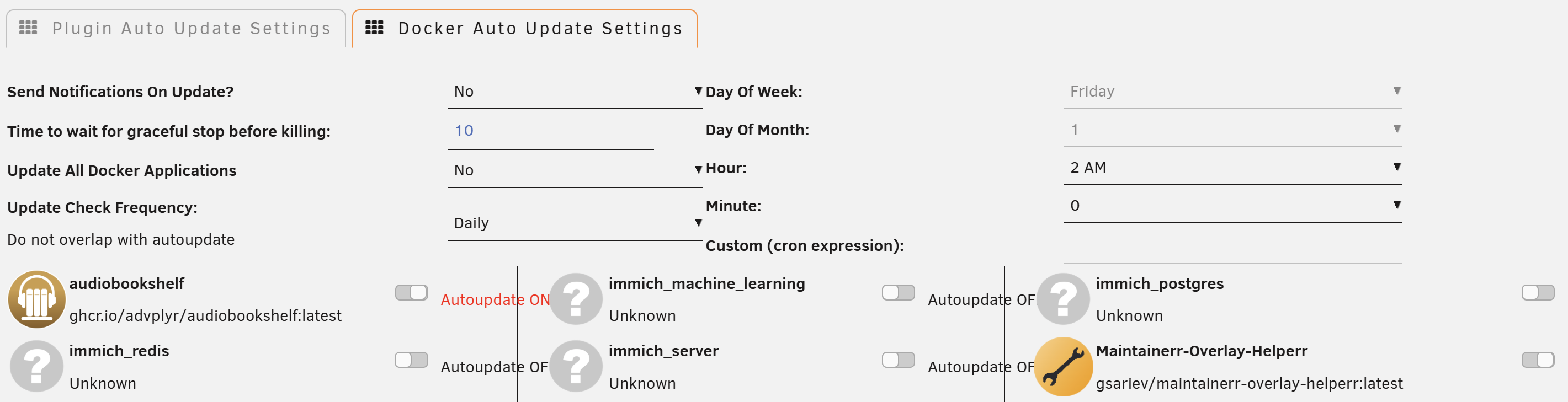

  3. the containers i see in the "docker auto update settings"-list in this plugin is not in the "previous apps" list. but i deleted everything there, but the containers (immich) still show up in the plugin. Edit: added diagnostics if anyone could help out. and a screenshot showing the immich "containers" in the plugin that shouldnt be there. unraid-diagnostics-20260226-1655.zip Edit 2: apparently a reboot of the server is needed to clear the list in the plugin of containers no longer present. so for anyone coming here with the same issue, reboot the server.
  4. i deleted all immich containers but they're still showing up in the "docker auto update settings"-list in this plugin for some reason. any ideas on why?
