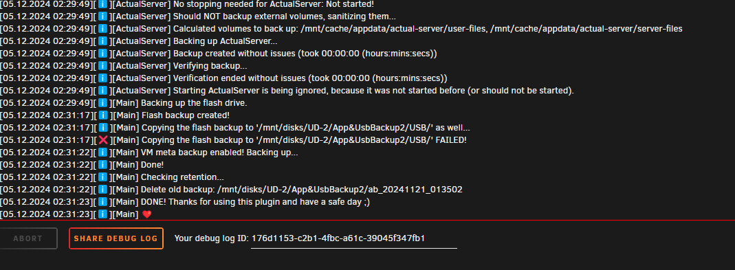

So if you remember my server was often crashing backing up USB stick - today USB stick backup just FAILED and I was able to get a log..
Does this perhaps tell you anything useful?
176d1153-c2b1-4fbc-a61c-39045f347fb1
Edited by blaine07
No. The process just wasnt able to do a simple copy to the destination. A syslog from that time would be maybe more interesting.
