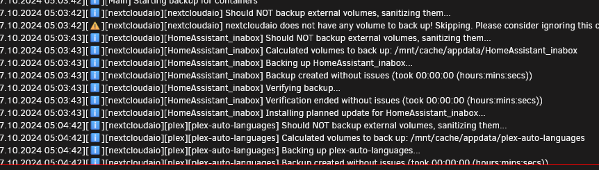

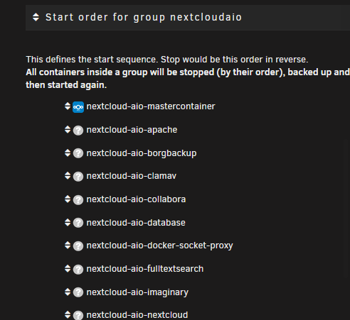

hi anyone know why its doing it like this?
the [nextcloudaio] is the tag i created for nextcloud-aio-mastercontainer. there's no docker exactly called nextcloudaio.
so its giving out an error saying there's no volume to back up
Share debug log

However, it seems to be a bug. All of your nextcloudaio members should be ignored. So the group is left empty. I bet I did not catch this state. It seems the backup script skips some group magic and keeps nextcloudaio as a container name.
remove the group when you not plan to backup any member. The bug will get fixed when Iam back from my holidays.
Put plex and tautulli in one group. They share volumes with each other. There should also a warning in the container settings secrion.
So for now i just remove all the nextcloud-aio group tag. Not plannining to have them back up, dont think i even can since there's nothing can be back up. there's only nextcloud-aio-mastercontainter and it created the the other nextcloud aio containers . I back them up using nextcloud itself.
Thank you btw for checking it out. Will wait for an update then.
