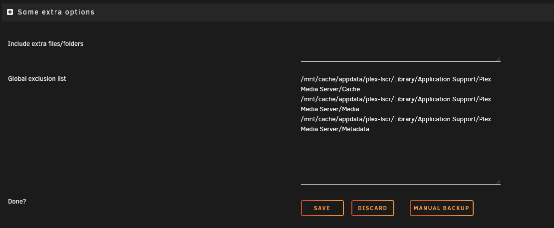

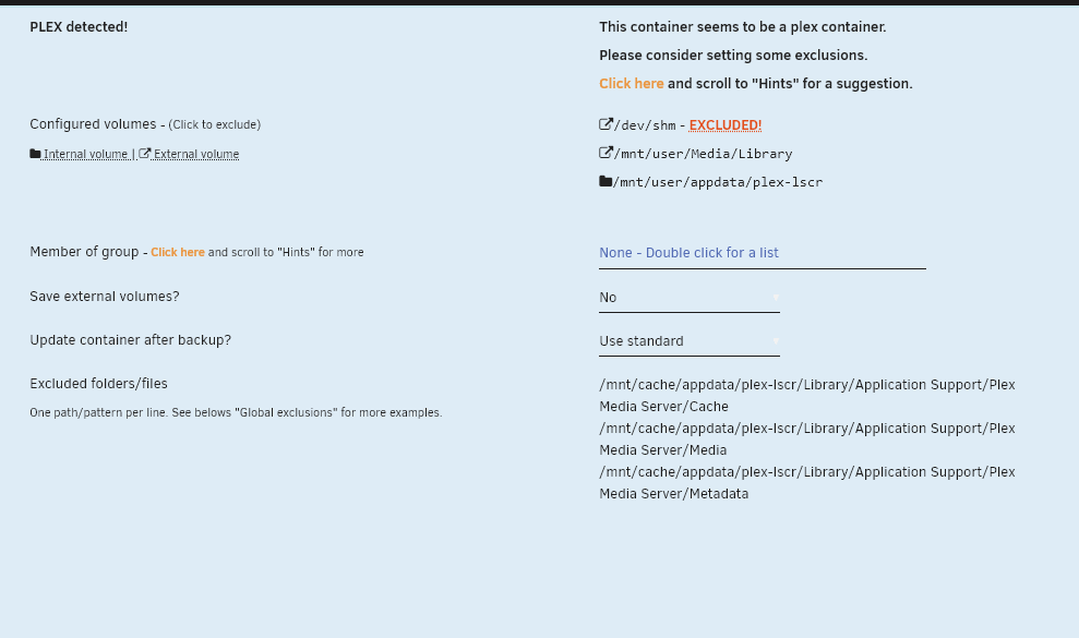

So I've tried searching and it may be early morning brain:
In regards to Plex I recently learned about excluding the Cache, Media and Metadata folders using appdata backup, I thought I had it set up correctly but my most recent backup still is backing up the excluded paths.  I have tried to add them into the global exclusion list & into the Docker settings directly.  What am I doing wrong?

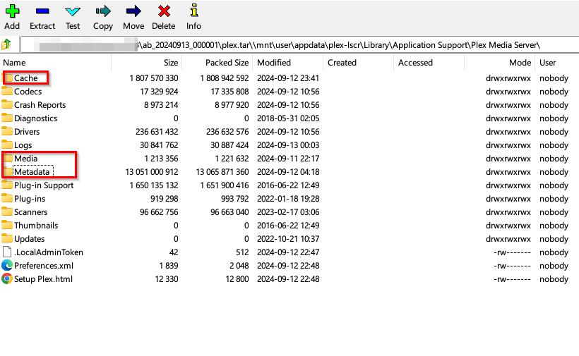

Opened up the most recent TAR:
[13.09.2024 00:03:43][ℹ️][plex] Stopping plex...  done! (took 3 seconds)
[13.09.2024 00:03:46][ℹ️][plex] Should NOT backup external volumes, sanitizing them...
[13.09.2024 00:03:46][ℹ️][plex] Calculated volumes to back up: /mnt/user/appdata/plex-lscr
[13.09.2024 00:03:46][ℹ️][plex] Backing up plex...
[13.09.2024 00:08:03][ℹ️][plex] Backup created without issues
[13.09.2024 00:08:03][ℹ️][plex] Verifying backup...
[13.09.2024 00:12:03][ℹ️][plex] Starting plex... (try #1)  done!
^^Log from my most recent backup this morning.
You're excluding /mnt/cache paths when they are set as /mnt/user paths in the container
Yep thats what early morning brain does, i didnt even realize what I had done.
Thank you.

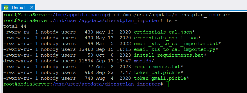

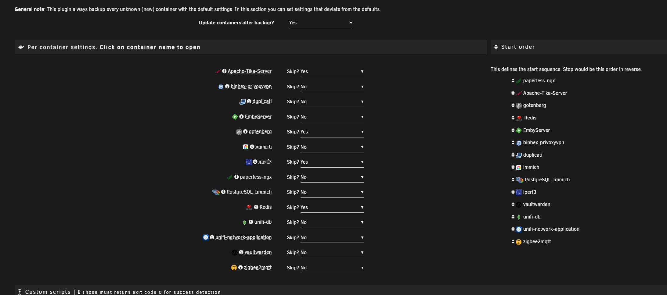

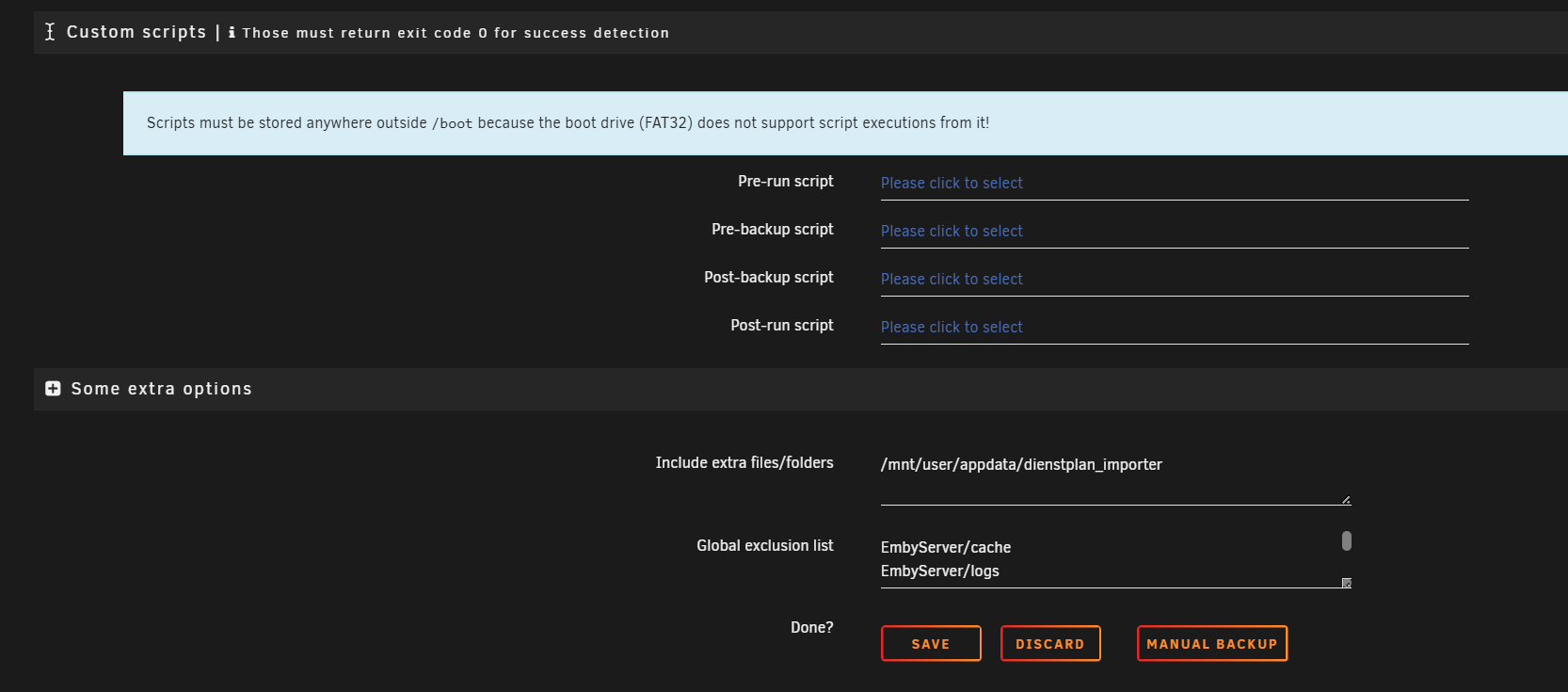

Hi, i am such a people, want to backup a manuall created folder in appdata, and added it like this:
/mnt/user/appdata/dienstplan_importer/
Also tried without slash, with wildcard, ... nothing works. Also from cache folder (where it lives) doesnt work.
As you said, there is no hint/error/warning that it was not backed-up, it's just missing.
Any hint's how i can include this folder in the backup?
On 8/29/2023 at 5:38 AM, KluthR said:
Good point, have to test that.
Any hint's how i can add this folder to the backup?
PS.: have now made an workaround with an user script

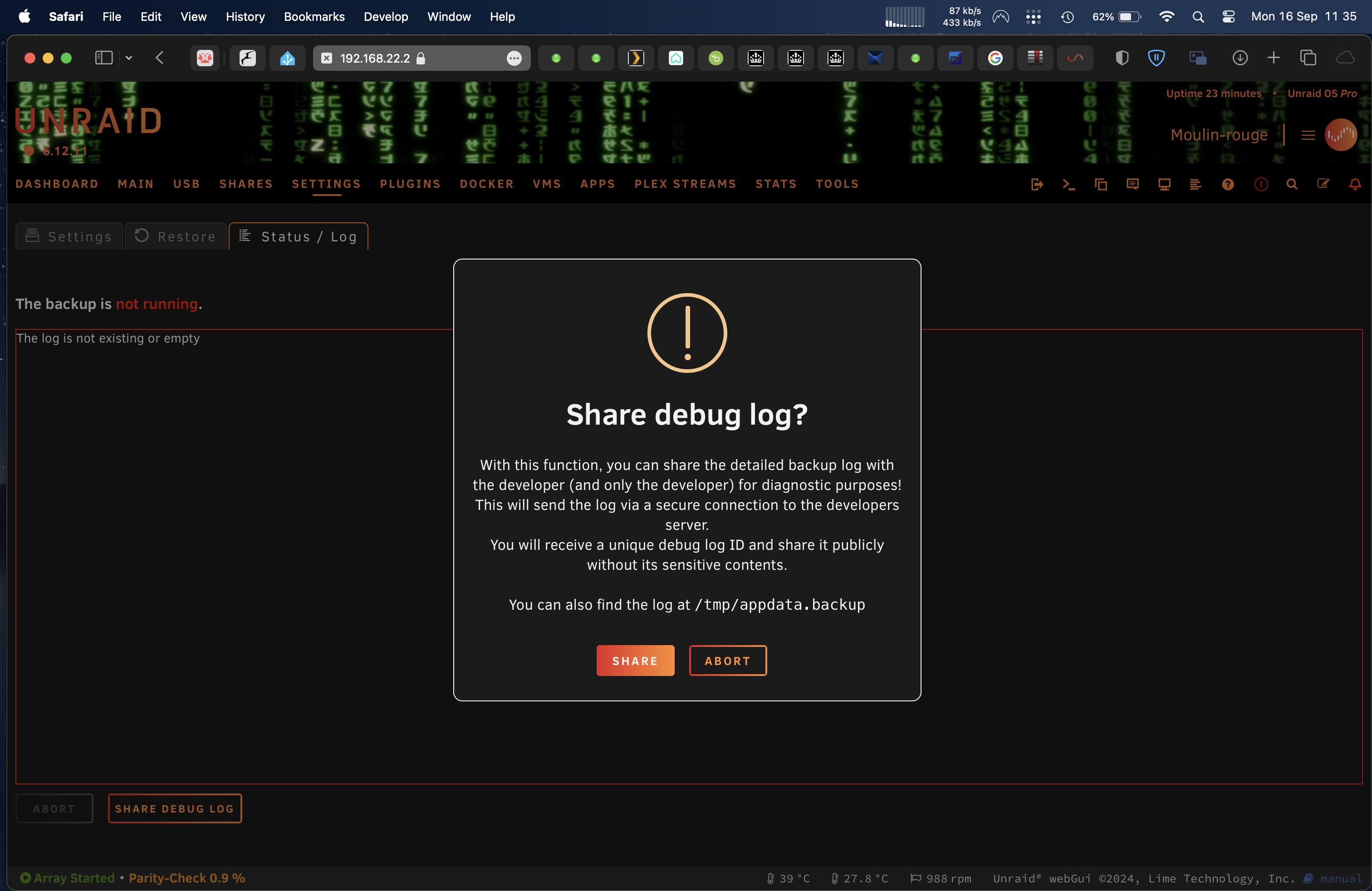

  • Trying to troubleshoot a system lockup during backup...
  • Would it be possible to improve the logging?
  • Make it save to the SSD app folder rather than TMP folder?
  • Also if possible make the syslog name each docker as it is restarted?
  • The share debug log doesn't seem to DO anything...
The log gets cleared after reboot.
you can check the syslog after reset, the syslog is stored on the flash.

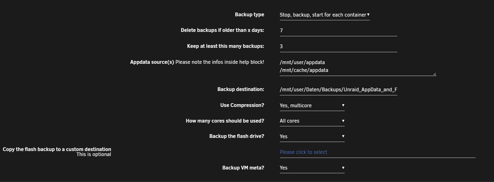

I dont get it. I cant get it to backup plex at all, says theres nothing to backup.
068dc71c-9751-4d93-89cc-2ff02f20669e
Your sources setting is wrong. Did you understood how it works? Did you read the help block?
Your appdata layout is also custom, you dont use a "appdata" share with holds the regular appdata. For your setup to work, set the allowed appdata sources to
  • /mnt/user/
and set Plex container excludes to "/mnt/user/data_store". The sources field is not be meant to hold every appdata container path.
That should do it.
You also maybe want to create a /mnt/user/appdata and store Plex's and tautullis appdata in there. Then you can change the sources path to "mnt/user/appdata" and clear the excludes fields (as external volumes get ignored by default).
Let me know if this helps.
Where?
if you specified the share path (/mnt/user/appdata) and the final path as „extra backup files“ path, it should work
DO NOT add the final path to the sources list.

33 minutes ago, KluthR said:
Where?
I have NOT added "/mnt/user/appdata/dienstplan_importer/" (which hold's the extra files i want to include in the backup) to the sources.
Just added "/mnt/user/appdata/dienstplan_importer/" to "extra backup files".
But it does'nt include it in the backup and also NO hints (error/warning/...) log entry will be shown.
So i can't share a log, because i does'nt have an hint's about an issue.
That's the same behaviour as stated by @samsausages back in ~2023.
Can you please try to reproduce it?
thx
9 hours ago, KluthR said:
Please share a debug log from a recent run.
I have shared it, the id is: 6bdd1a47-e72d-43a9-aa78-89dd8153fc2c

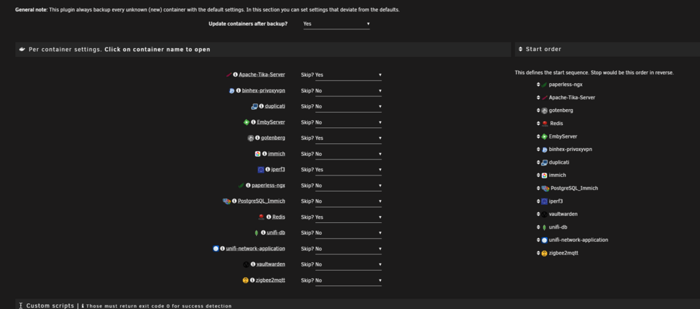

The included extra folder exists and is accessible (currently backing it up with an user script), see:
Here are some pictures from my settings:
