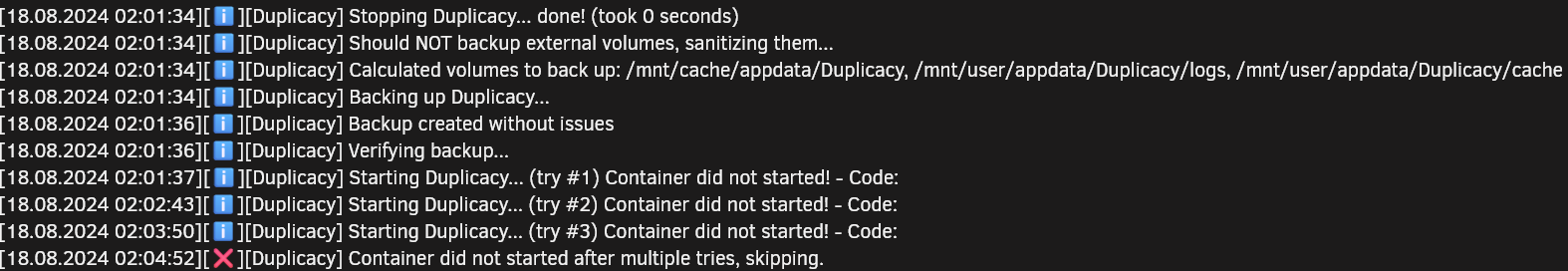

I'm trying to work out why Duplicacy sometimes refuses to restart automatically after backups. This has been happening regularly (but not consistently) for the past couple months. Any ideas?

What's the destination for its target? it may be offline/unavailable.
The backup destination for Appdata Backup is just a local Unraid share.
I did add my desktop PC as a destination in Duplicacy, and it's off a lot of the time. Didn't think that could cause this to happen, but it might explain why only Duplicacy is having this issue...
Yeah, if it's an smb mount the container will fail to start if it's not online.
