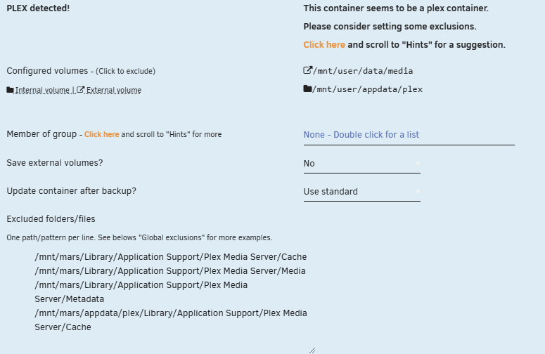

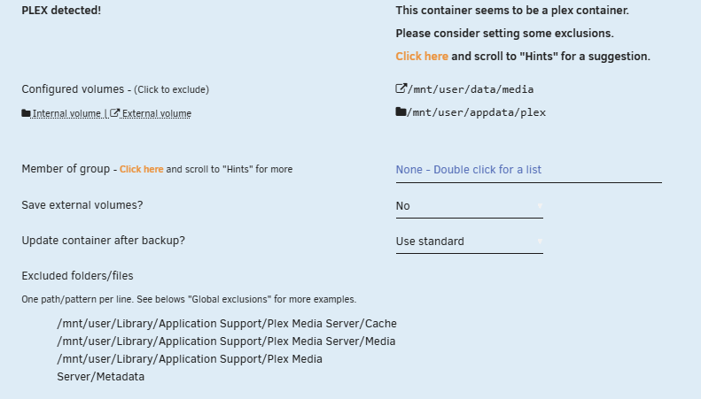

My backup started failing this week, and it seems to be due to Plex.
It was working just fine before and I didn't change anything in my exclusions which are set up like this:
Does anyone have any suggestions on how to troubleshoot?
Thanks!
Potential fix: I saw another member changed /user/ to the server name, which worked.
So I tried, and this time, the backup did not have any errors:
That makes absolutely no sense. Changing those paths are exclduing the exclusions.
Your issue is the missing "appdata/plex" within the paths. Your exclusions should start with "/mnt/user/appdata/plex/"
Understand, thanks for clarifying. So can I check that instead of the initial recommended exclusion list:
/mnt/user/Library/Application Support/Plex Media Server/Cache
/mnt/user/Library/Application Support/Plex Media Server/Media
/mnt/user/Library/Application Support/Plex Media Server/Metadata
My setup is different and I should set it instead to the following:
/mnt/user/appdata/plex/Cache/
/mnt/user/appdata/plex/Media/
/mnt/user/appdata/plex/Metadata/
Because when I check my folders, I only seem to have the Cache one. The other 2:
/mnt/user/appdata/plex/Library/Application Support/Plex Media Server/Media
/mnt/user/appdata/plex/Library/Application Support/Plex Media Server/Metadata
Don't exist and when I run backup, that's where I get the failed error.

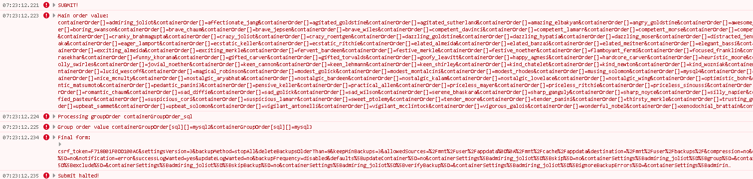

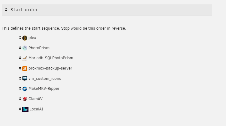

Regarding contaioner order: I created myself ~160 dummy containers. The AppdataBackup page settings is now huge but ordering works as expected.
@affected users, could you tell me which browsers you use? Due to a debug logging issue (https://forums.unraid.net/bug-reports/stable-releases/61210-javascript-consoledebug-and-consolelog-disabled-due-to-vue-i18n-r3084/), you have to make another change to display me some information.

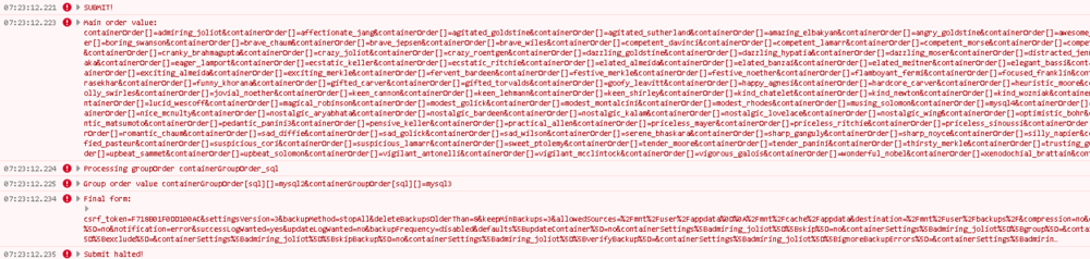

Could you open the settings.php file once again, scroll to line ~907 (the line reading "$('#abSettingsForm').on('submit', function () {". A few lines later (~922) you should see two lines of "        });". The latter of those both matter for the next step:
Replace the WHOLE BLOCK with this:
        console.error("SUBMIT!");
        let mainValue = $('#containerOrderSortable').sortable('serialize', {
            expression: /(.+?)_(.+)/
        console.error('Main order value: ', mainValue);
        $('#containerOrder').val(mainValue);
        $("input[id^='containerGroupOrder']").each(function (index) {
            console.error("Processing groupOrder " + $(this).attr('id'));
            let groupValue = $('#' + $(this).attr('id') + '_Sortable').sortable('serialize', {
                expression: /(.+?)=(.+)/
            console.error('Group order value', groupValue);
            $(this).val(groupValue);
        console.error('Final form:', $(this).serialize());
        console.error("Submit halted!");
        return false;
Then save, reload settings page and hit F12 (the developer console). Open the tab called "Console". Hit Submit on the settings page. Nothing will happen, which is fine. But the console will output some red lines. Maybe you can send me a PM with the result?
Should look like:
To re-enable submission either redo all changes ot just remove the "return false;" line at the last few lines.
The list has a info above: "Each following paths need to be prefixed with your correct appdata path!". And this prefix is (in your case) "/mnt/user/appdata".
Thats totally ok then.
Ok thanks for the sanity check, I will give it try. Appreciate it

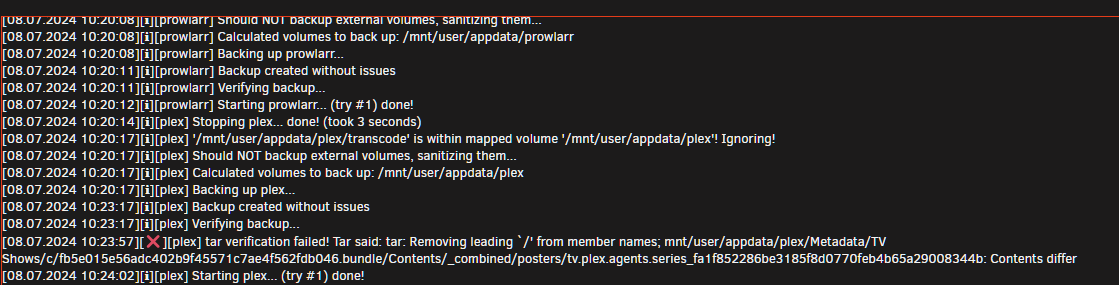

On 6/11/2024 at 7:45 AM, beasthouse said:
Hey legends, have a few errors popping up in my logs.
Not sure what this one means, let alone how to fix it:
[10.06.2024 02:28:03][][code-server] tar verification failed! Tar said: tar: Removing leading `/' from member names; mnt/user/appdata/homeassistant/home-assistant_v2.db: Mod time differs; mnt/user/appdata/homeassistant/home-assistant_v2.db: Size differs; mnt/user/appdata/homeassistant/home-assistant.log: Mod time differs; mnt/user/appdata/homeassistant/home-assistant.log: Size differs; mnt/user/appdata/homeassistant/home-assistant_v2.db-wal: Mod time differs; mnt/user/appdata/homeassistant/home-assistant_v2.db-wal: Contents differ; mnt/user/appdata/homeassistant/home-assistant_v2.db-shm: Contents differ
As above:
[10.06.2024 02:51:40][][imagemaid] tar verification failed! Tar said: tar: Removing leading `/' from member names; mnt/app_cache/appdata/plex/Logs/Plex Media Server.log: Mod time differs; mnt/app_cache/appdata/plex/Logs/Plex Media Server.log: Size differs; mnt/app_cache/appdata/plex/Plug-in Support/Databases/com.plexapp.plugins.library.db: Mod time differs; mnt/app_cache/appdata/plex/Plug-in Support/Databases/com.plexapp.plugins.library.db: Contents differ; mnt/app_cache/appdata/plex/Plug-in Support/Databases/com.plexapp.plugins.library.db-wal: Mod time differs; mnt/app_cache/appdata/plex/Plug-in Support/Databases/com.plexapp.plugins.library.db-wal: Contents differ; mnt/app_cache/appdata/plex/Plug-in Support/Databases/com.plexapp.plugins.library.db-shm: Mod time differs; mnt/app_cache/appdata/plex/Plug-in Support/Databases/com.plexapp.plugins.library.db-shm: Contents differ
I have double checked the mappings for this one and it keeps occurring:
[10.06.2024 02:26:23][][cross-seed-misc] '/mnt/user/data/torrents/misc/cross-seed' does NOT exist! Please check your mappings! Skipping it for now.
And last one, and why I am here 😉:
[10.06.2024 02:57:10][⚠️][Main] An error occurred during backup! RETENTION WILL NOT BE CHECKED! Please review the log. If you need further assistance, ask in the support forum.
Any help would be greatly appreciated.
Did you resolve it? I do have quite the same error, interestingly as well with home assistant container:
[08.07.2024 07:22:06][][hassConfigurator] tar verification failed! Tar said: tar: Removing leading `/' from member names; mnt/user/appdata/Home-Assistant-Container/.storage/scheduler.storage: Mod time differs; mnt/user/appdata/Home-Assistant-Container/homematicip_local/cache/RaspberryMatic_homematic_devices.json: Mod time differs; mnt/user/appdata/Home-Assistant-Container/homematicip_local/cache/RaspberryMatic_homematic_paramsets.json: Mod time differs; mnt/user/appdata/Home-Assistant-Container/home-assistant.log: Mod time differs; mnt/user/appdata/Home-Assistant-Container/home-assistant.log: Size differs

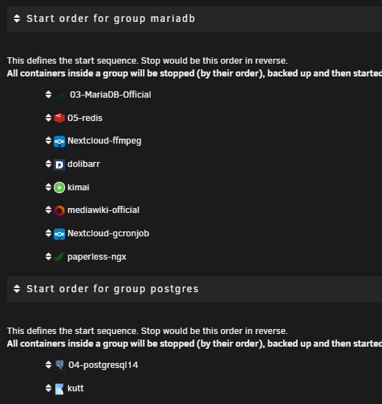

I would like some scripting help and a bit more understanding of the option in the app.
More info needed:
I'm trimming my docker applications but at once time, I was running 6 dockers to complete 3 server needs. and using this plugin to backup.
Old needs:
2x mysql via maraia DB
A database for nextcloud
A Database for Photoprism
1x MongoDB
A database for unifi
3x service docker applications:
nextcloud
photoprism
unifi-network-appliaction
Problem:
So when using the backup tool it will backup but due to the start order of shutdown and startup... i would like to stop all the containers and or stop the server docker first then the database to maintain data and not have errors inside the serve docker because the database is not there...
It would be ideal to have a option to not start dockers back up. and to have a custom cmand to start them when done. ATM I only have a database and photo prism...

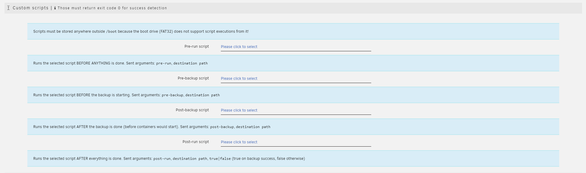

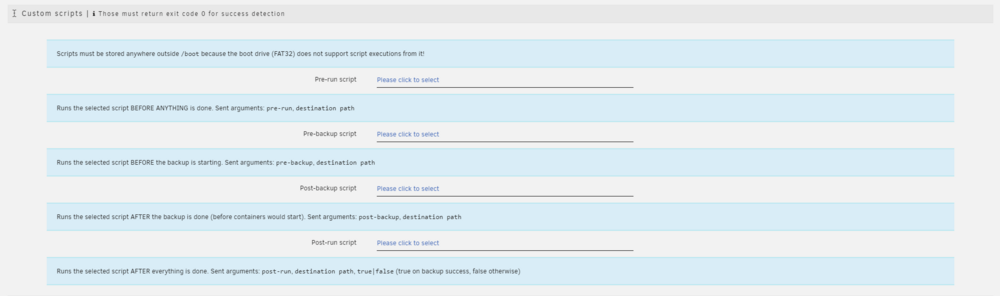

I have 2 scripts a teardown and startup
teardown:
docker stop PhotoPrism
docker stop Mariadb-SQLPhotoPrism
#docker stop nextcloud
#docker stop Mariadb-SQLnextcloud
#cd /mnt/cache/appdata/netprobe_lite && docker compose down
startup:
#docker login  -u dockerusername --password apipasswordkey
docker start Mariadb-SQLPhotoPrism
#docker start Mariadb-SQLnextcloud
sleep 5
docker start PhotoPrism
#docker start nextcloud
#cd /mnt/cache/appdata/netprobe_lite && docker compose up -d
exit 0
Now to the script issues and hopefully a better understanding.
I had teardown sh script as a pre run
startup as a post run.
While it did stop the dockers, it appears that the backup starts the docker after the backup.
This wouldn't be a problem as I stopped the docker before the plugin begins its settings of backup and update if available... this appears to also start the docker after backup. Which would be fine if it followed a start order.
But the start order will not save nor follow that rule set. Each time I load the plug page via setting, the start order is different. and the logs when this does an auto backup show different dockers starting, stopping when backed up...
Ideally I would want it to save and run in this order:
any idea on how to fix this to not have the service docker photo prism running without mariadb?
Edited by bmartino1
spelling
Sounds like all you're asking for is handled by the grouping feature, no scripts needed.
Edited by Kilrah

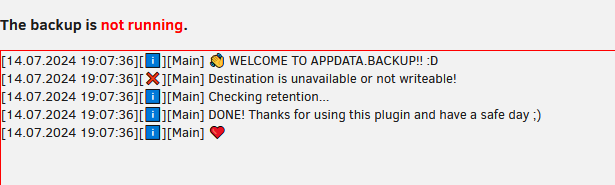

Hello, I am having issues getting the backups to actually run, they dont seem to be running with the schedule I have set, and manual backups are not working. My debug ID is 1687cfe1-8348-4322-8c64-a736e3eeee46
It says right there it can't write to the destination, so check that.

It's not keeping the order even with a save  that my main issue. how hard would it be to make a separate save button for that feature?
So it seems you are affected by this bug as well. I cant reproduce it yet. Please view a fee posts before yours, I wrote a few things about it. Maybe you could male the mentioned changed and report back?
I have the same issue. AB can't find the 'remotes' location (for me that is /mnt/remotes/SMB_NAS_Backup/Areopagus/)
@Kilrah via console the folder is available, i think this is another issue.
Yeah I have tried different file paths and creating them manually beforehand, I dont know what im doing wrong, none of my docker containers seem have trouble using the same directory
