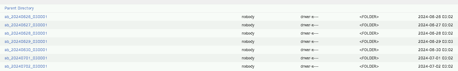

On 6/18/2024 at 5:01 PM, Bulletoverload said:
I second the ability to rename backups. The old naming scheme was much better. I like the ability at quick glance to see that backups have run and are up to date. The current scheme is not user friendly for date and time at quick glance. I would enjoy the ability to set a custom scheme if possible.

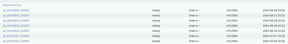

Why? Its perfetcly ordered (for me?). And the date string is also clearly visible. Even the datetime in file browser shows it:

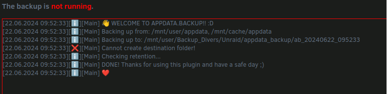

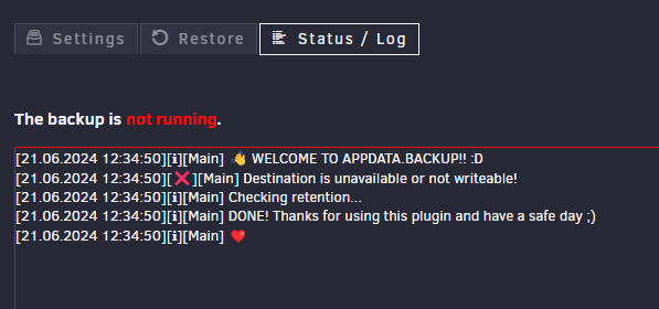

On 6/22/2024 at 10:07 AM, LordBooker said:
got an error when im trying to backup.
Nothing changed, since last backup.
Thanks for help!
Is the destination really there? Can you manually create files there?

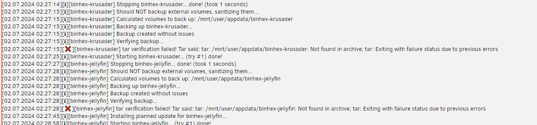

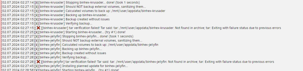

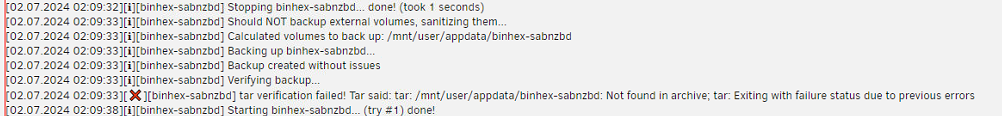

Good afternoon
I am receiving the following errors on the verify step for some (but not all) dockers. I have read this thread, but still don't understand what I have wrong in my setup? This only appears to happen on scheduled backups. If I run a manual backup it seems to work fine.
[02.07.2024 01:07:08][ℹ️][tdarr] Stopping tdarr...  done! (took 3 seconds)
[02.07.2024 01:07:11][ℹ️][tdarr] Should NOT backup external volumes, sanitizing them...
[02.07.2024 01:07:11][ℹ️][tdarr] Calculated volumes to back up: /mnt/user/appdata/tdarr/logs, /mnt/user/appdata/tdarr/server, /mnt/user/appdata/tdarr/configs
[02.07.2024 01:07:11][ℹ️][tdarr] Backing up tdarr...
[02.07.2024 01:07:11][ℹ️][tdarr] Backup created without issues
[02.07.2024 01:07:11][ℹ️][tdarr] Verifying backup...
[02.07.2024 01:07:11][][tdarr] tar verification failed! Tar said: tar: /mnt/user/appdata/tdarr/logs: Not found in archive; tar: /mnt/user/appdata/tdarr/server: Not found in archive; tar: /mnt/user/appdata/tdarr/configs: Not found in archive; tar: Exiting with failure status due to previous errors
[02.07.2024 01:08:00][ℹ️][tdarr] Installing planned update for tdarr...
[02.07.2024 01:09:05][ℹ️][tdarr] Starting tdarr... (try #1)  done!
[02.07.2024 01:09:08][ℹ️][syncthing] Stopping syncthing...  done! (took 4 seconds)
[02.07.2024 01:09:12][ℹ️][syncthing] Should NOT backup external volumes, sanitizing them...
[02.07.2024 01:09:12][ℹ️][syncthing] Calculated volumes to back up: /mnt/user/appdata/syncthing
[02.07.2024 01:09:12][ℹ️][syncthing] Backing up syncthing...
[02.07.2024 01:09:12][ℹ️][syncthing] Backup created without issues
[02.07.2024 01:09:12][ℹ️][syncthing] Verifying backup...

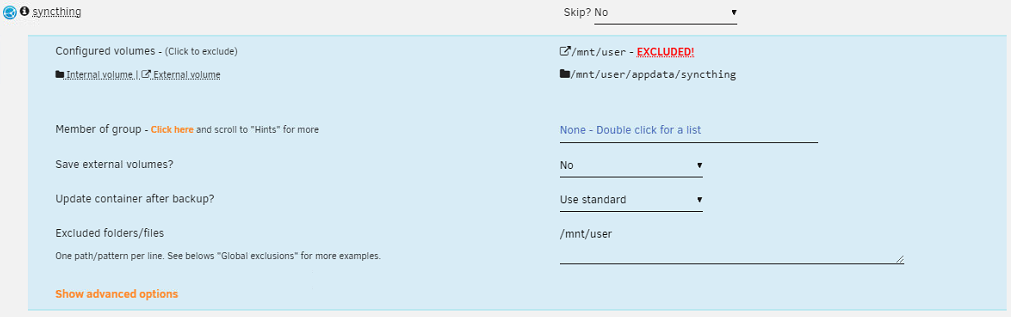

[02.07.2024 01:09:12][][syncthing] tar verification failed! Tar said: tar: /mnt/user/appdata/syncthing: Not found in archive; tar: Exiting with failure status due to previous errors
[02.07.2024 01:09:17][ℹ️][syncthing] Installing planned update for syncthing...
[02.07.2024 01:10:35][ℹ️][syncthing] Starting syncthing... (try #1)  done!
I have forwarded the Debug Log. ID:
24eb6a5c-a79a-40e1-9404-3ab70a9467f9
Any help much appreciated.
SS
Thanks for help!
I’m also having the exact same issue. It was previously working. I’ve got the same path as him also.
also looks like it’s saying my back ups share is full even thought I’ve got 2tb left on my server.
mkdir: cannot create directory '/mnt/user/backup/unraid_appdata_backup/Test': No space left on device
SOLVED: I’m a dummy and my minimum storage for my backup share was 500gb

The /mmt/user exclusion could cause this. But this exclusion is being applied in both creation and verification, so not sure why it complains :/

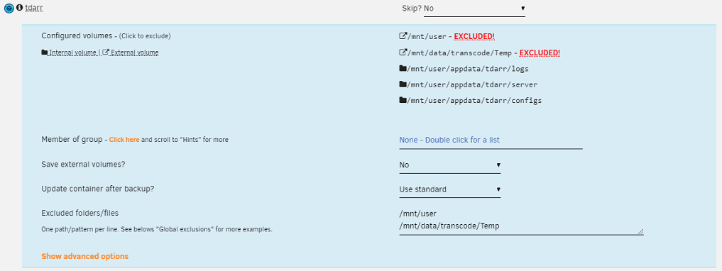

what exclusions for tdarr?
Thank you for your help.

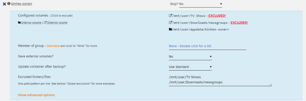

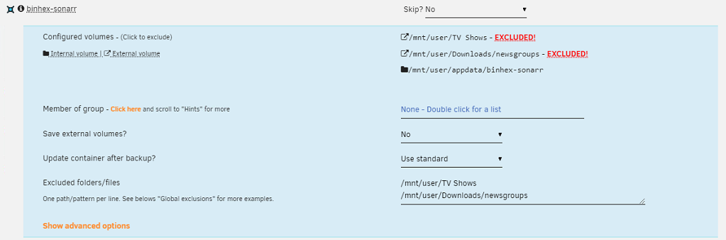

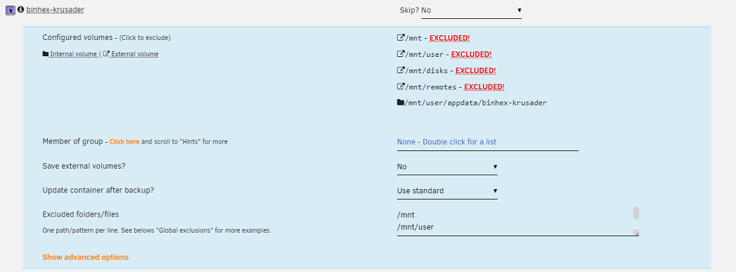

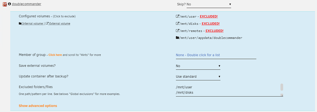

Tdarr:

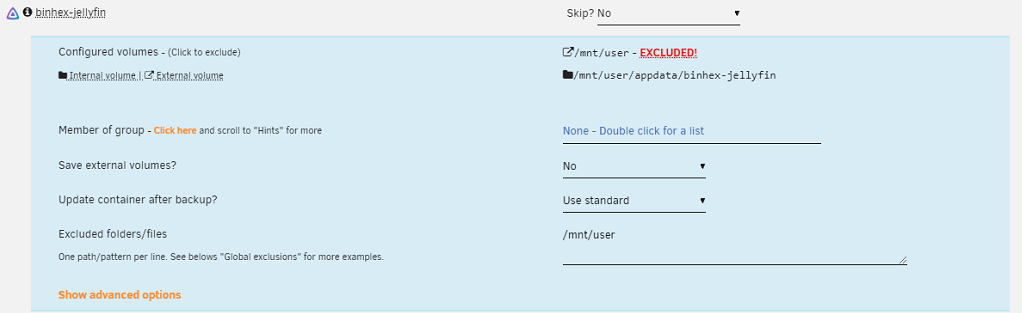

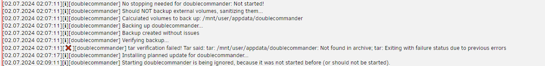

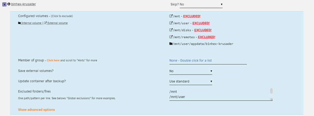

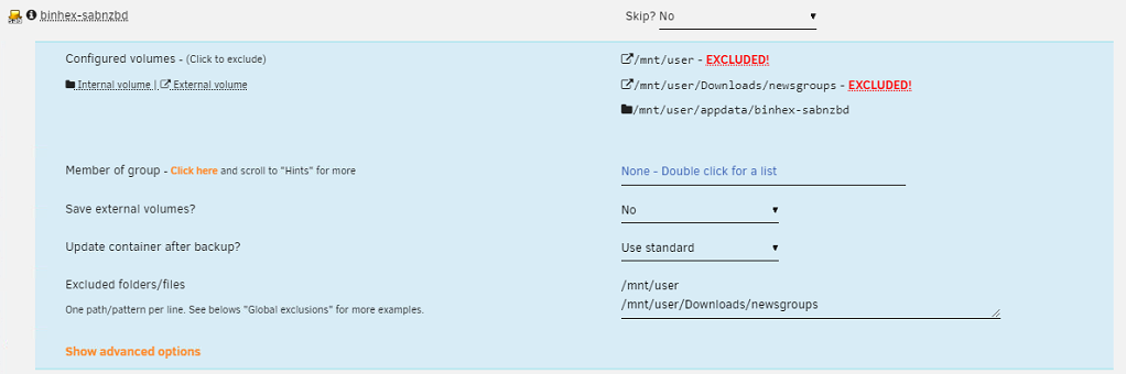

I have 6 containers failing with the same error:
I sync my backups to onedrive. The file explorer dates are when they were synced, not when the file was created. I can look at the file names but they aren't great to eyeball. Its a nit picky thing for sure but a preference nonetheless. Can I ask what the point of the "ab" and "030001" is? Maybe I'd change my mind if I understood better.
In all of these you've excluded everything that is in external volumes, but "save external volumes" is set to No anyway so none of these exclusions are useful.
The plugin shouldn't break in that case but you can also just remove the exclusions and it'll likely stop the errors.
@Kilrah - than you for your response. That kinda makes sense. I added them as the log the first time I ran the backup mentioned them, but I can see the double exclusion may cause an error. I have removed all the exclusions from the 6 containers and set the backup to run at 1am tomorrow, So we will see tomorrow.
MAny thanks
SS
ab is appdata backup, 030001 is the time, 3am 0min 1 sec
Sorted by name they'll be in chronological order, 2nd block is the date...
Edited by Kilrah
That's funny. I also just so happen to run my backups at 3am so when the above picture was posted and it looked identical my brain didn't process it was the time, I thought it was just extra numbers. Derp moment for me.
Its definitely just a small preference thing. I would like the ability to make it whatever I wanted but its not a huge deal. The fact the plugin works as well as it does is really all that matters. I just really liked the old format. 07.04.2024@0300 or whatever it was. Felt easier for me to see right away.
MAny thanks
SS
All working now after removing the exclusions. Than you all for your help 🙂
SS
