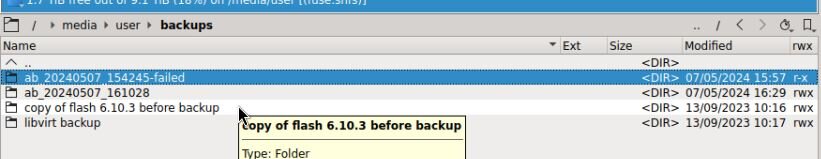

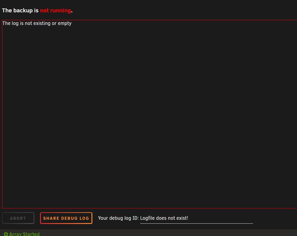

Is there a way to see logs after backup job has finished?
In the Status/log tab I can see nothing:
It'll be in the backup folder for that run. Did you reboot since last run?

i didnt modify any settings. (i am backuping onto NAS Share).
There is no log file in the backup folder, I did not reboot after last run

Hello, can anyone help with this?
I aborted the backup because it was getting huge (I had to exclude some things).  After making the changes, it created a backup.  I then tried to delete the bad backup that is +14gb with the "-failed" name and it won't let me delete it.  It has the r-x permissions.  How do I delete this?  I'm using binhex-krusader as a file editor.
A file browser's built it.
Go to shares in the top menu and navigate to the file then use the file menu to delete or change permissions.
Ive been having issues with backup completing since a update a while back. Ive deleted this file and then next time it picks out another file in plex that it has this same issue with ive done this about 8 times now to no avail . Hopefully someone can give me a idea why this keeps happening with only plex.image.thumb.png.1b27551e37985c3ed01f3912492bc3f7.png
