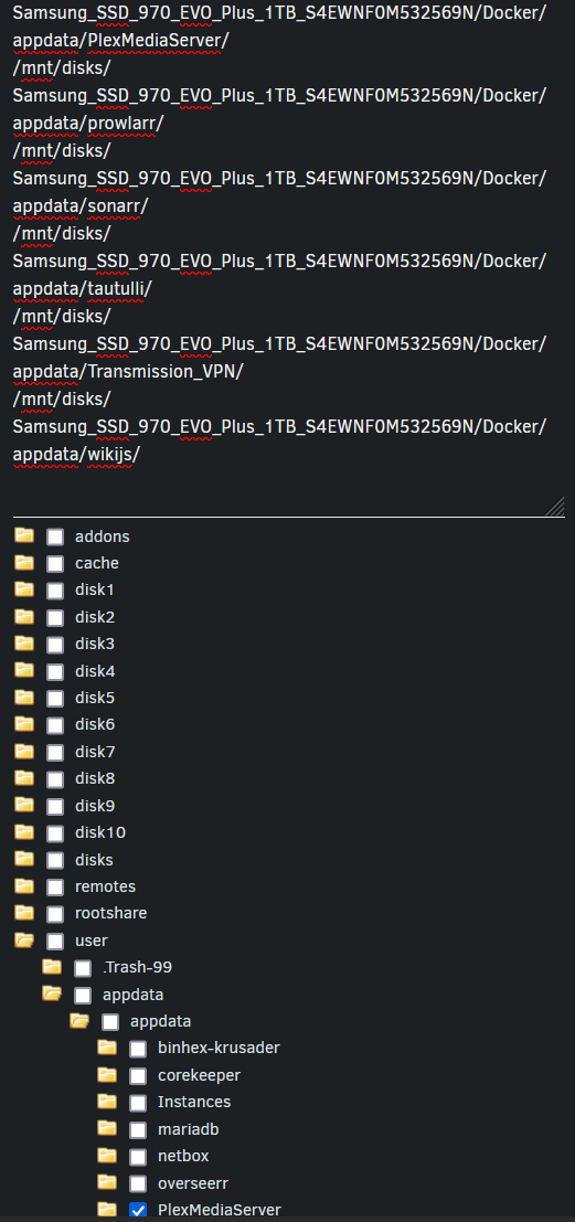

@KluthR Whenever I try to change my source directories to my actual "internal appdata path" it changes back automatically to the absolute path regarded as "external" by the plugin (/mnt/disks/XXXXX/docker/appdata).
is it possible to somehow change whats regarded as being "internal" path?
All my appdata is regarded as external paths since I setup my server at a time when I had a weird bug with the appdata folder access rights, so I am using another path (/mnt/user/appdata/appdata). Stupid yes, but it was the only way I managed to solve it at the time.
I could use "external paths" but then it backs up stuff I don't want, like the external transcode directory for plex etc.
Otherwise I would need to migrate all my 38 containers back to the default appdata path 😅
"Appdata source(s)" at the top, if something's within one of those set there it's internal.
Tried to set it several times, but it reverts to absolute path and then regards it as "external path", and as a result it skips it completely unless I explicit set it to backup external paths further down.
Right now it's only backing up the template settings.
Is it fetching these paths from the container settings even though I explicitly tells it to target these folders?
Yes paths are always taken from the container settings, then if that path is within one of the appdata sources it's considered internal
Ah, alright. Guess I have to bite the bullet and migrate all my containers to the "correct" path then. uhh.... Thanks :)

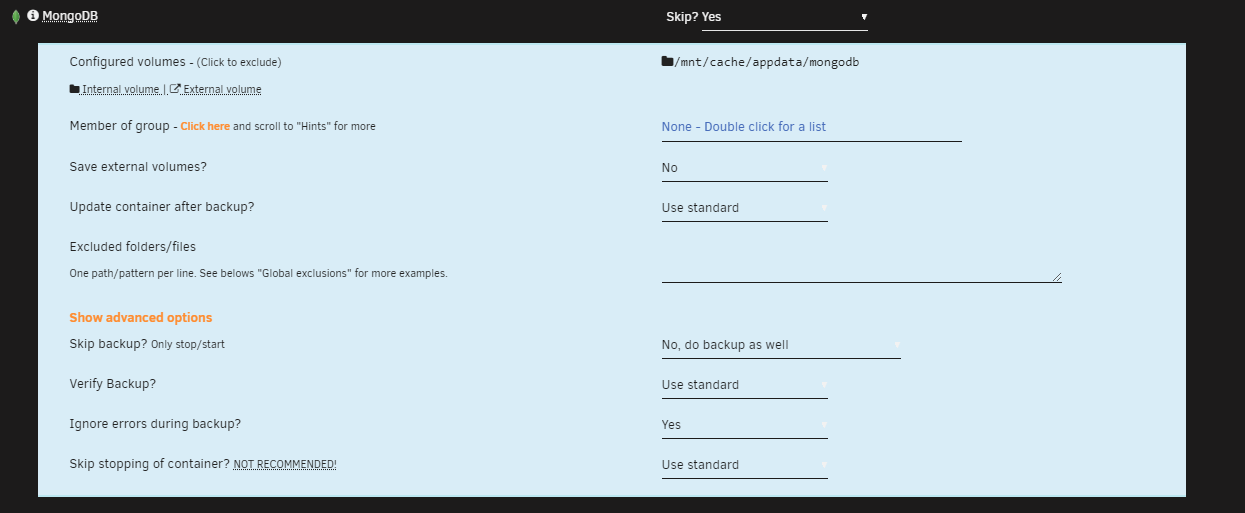

For months off and on I get this error; frankly I am tired of seeing it despite it means nothing. What is wrong here? I don't even leave MongoDB running anymore.
The error:
Event: Appdata Backup
Subject: [AppdataBackup] Error!
Description: Please check the backup log!
Importance: alert
Debug Log ID: c2b88e35-5351-4b46-8572-9a8dddda2430

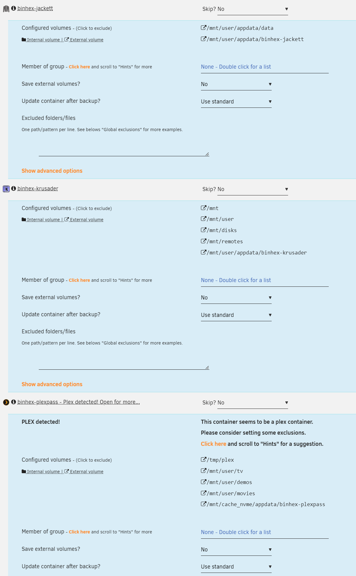

How do you group containers together? I couldn’t find anything when searching this backup topic or Unraid generally.
I’m getting the “File change as we read it” for Plex media server. Which has writing interactions with tautulli and Ombi containers.
I have my backup type set to: Stop all containers, backup, start all.
Debug Log ID: 4879c939-ebf7-419d-98ed-b8a7942b0527
„Group“ field inside container specific settings.
To share for others, that took me 10 minutes before finding 😅. As I was looking inside the Unraid Docker container tab.
Instead of inside backup plugin itself and clicking on the container at bottom, naming the container group and clicking save confirm the group name.
Thanks!
