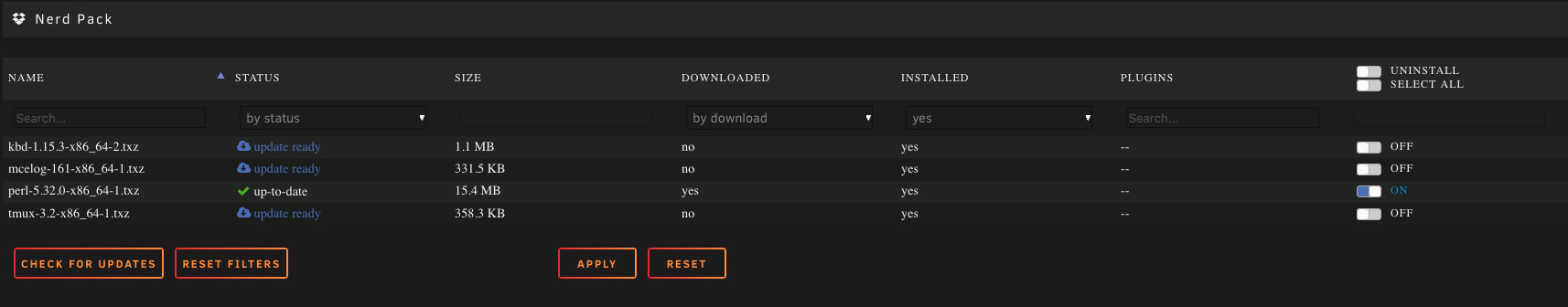

  14. Hi, I need help RE: nerdpack. I'm still at 6.10.3 and hesitatnt to move to 6.11.0 because of the whole nerd thing issue. I don't remember why I installed nerdpack (likely SpaceinvaderOne videos). Here is an image of those that are installed (attachement). Here are my questions: Do I need these, or can I simply remove nerd package and upgrade to 6.11.0? If I do need them, how do I find out which dockers are using them? If I do need them, what do I do to replace them. When I execute in UNRAID cml: grep yes /boot/config/plugins/NerdPack/NerdPack.cfg, I get JUST one entry: perl-5_32_0="yes" Is this package available as standalone in 6.11.0? (I don't see it in Apps store on 6.10.3) Thank you.
