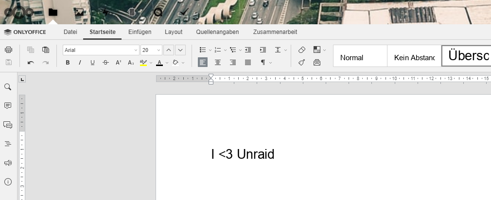

Nextcloud based on the official docker hub image.
Nextcloud with full Office integration.
Based on: https://hub.docker.com/_/nextcloud/  Tag  apache (latest)
Please make shure you got the volume mounting correct.
Please note you can mount any share to for example /mnt/Share and mount it in nextcloud with the "external storage" app.
-- PREVIEW:
