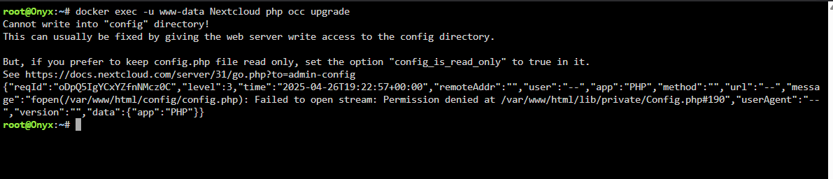

20 hours ago, kanuracer said:
The command for the unraidterminal should be:
docker exec -u www-data DOCKERNAME php occ upgrade
i did that and this comes what do i need to do ?
Check ur permissions for /config and ur config.php
Try
docker exec -u 99 Nextcloud php occ upgrade
This template by default runs NC as 99:100.
On 4/27/2025 at 10:44 AM, Kilrah said:
Try
Also had the issue that i had to update manually, your command fixed it, thanks! :)

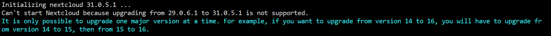

Hi all. I'm getting the following error. My server was offline for almost 2 years while dealing with some life situations. Finally setting everything back up.
Initializing nextcloud 32.0.6.1 ...
Can't start Nextcloud because upgrading from 27.1.3.2 to 32.0.6.1 is not supported.
It is only possible to upgrade one major version at a time. For example, if you want to upgrade from version 14 to 16, you will have to upgrade from version 14 to 15, then from 15 to 16.
Hello, you need to change your repository from :latest to an older version.
For example:
nextcloud:28.0
nextcloud:29.0
to a version before the latest one, and then change it back to latest.
The latest version from this Docker is 32.
For example:
nextcloud:28.0
nextcloud:29.0
Thank you. Just started it at 28. Had to figure out how to change the repo. Seems to be working.
