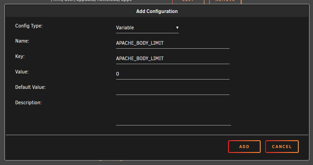

You can add it as a variable in the template
No, like this
Edited by Kilrah

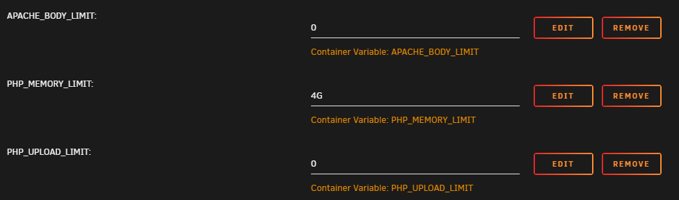

What he's saying is to set the variables up like this.
I just set this up and it worked great. The "Name" is just the name you see on the unraid web interface while the "key" and "value" are the actual values passed into docker. This will automatically create the "-e APACHE_BODY_LIMIT=0" line when starting up the docker image. You will need to do this for both the limit variable.

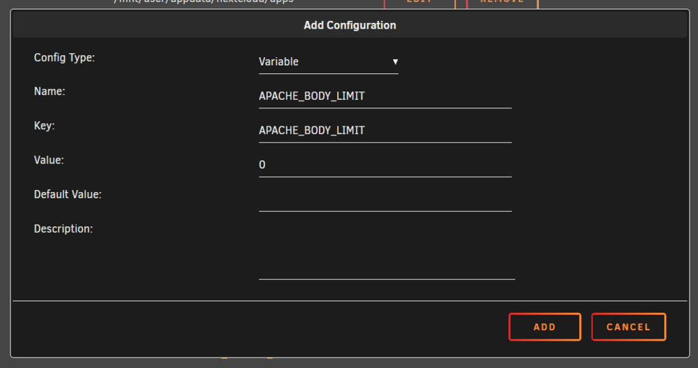

On 11/19/2024 at 10:04 AM, Kilrah said:
No, like this

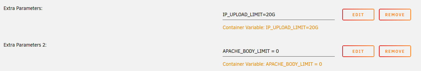

Thanks for that to all of you!
I have append those parameters to the App Template file.
