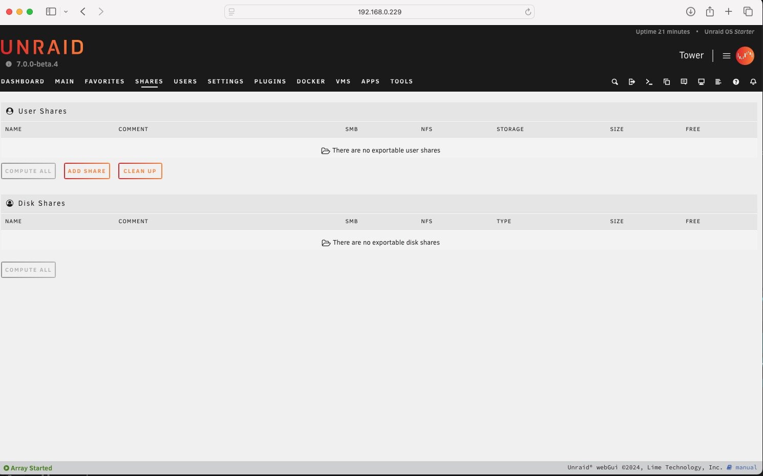

My directory in Unraid is a bit of a mess: root@NAS:~# tree -L 1 /mnt/user /mnt/user ├── Games -> ../zfs/Games ├── Google Drive -> ../zfs/Google Drive ├── Media -> ../zfs/Media ├── Movies -> ../zfs/Movies ├── Music ├── MyRekordboxCollection -> ../zfs/MyRekordboxCollection ├── TV Shows -> ../zfs/TV Shows ├── appdata -> ../zfs/appdata ├── appdatabackup -> ../zfs/appdatabackup ├── appdatabackup_tmp_20241004112536 -> ../zfs/appdatabackup_tmp_20241004112536 ├── appdatabackup_tmp_20241004112536_tmp_20241023111607 ├── data -> ../zfs/data ├── data_tmp_20241003014612 -> ../zfs/data_tmp_20241003014612 ├── data_tmp_20241003014612_tmp_20241004112543 ├── data_tmp_20241003014612_tmp_20241004112543_tmp_20241023111616 ├── domains -> ../zfs/domains ├── downloads -> ../zfs/downloads ├── flashbackup ├── guacamole -> ../zfs/guacamole ├── isos -> ../zfs/isos ├── mac_music_mount -> ../zfs/mac_music_mount ├── movies_friends -> ../zfs/movies_friends ├── nextcloud -> ../zfs/nextcloud ├── nextcloud-backup -> ../zfs/nextcloud-backup ├── photos -> ../zfs/photos ├── photos_immich -> ../zfs/photos_immich ├── system -> ../zfs/system ├── tm -> ../zfs/tm └── vm_data -> ../zfs/vm_data I have two questions: 1. How would you suggest storing things differently? For example, moving some of these folders into others, making them subfolders instead 2. How do I move these folders, which are all shares? Is it just as simple as moving it from the Unraid GUI? Or do I need to make some extra considerations so things don't break? I assume I'll need to re-map some shares I have set up in various docker containers, but I wonder if there's anything else I'm not thinking about.

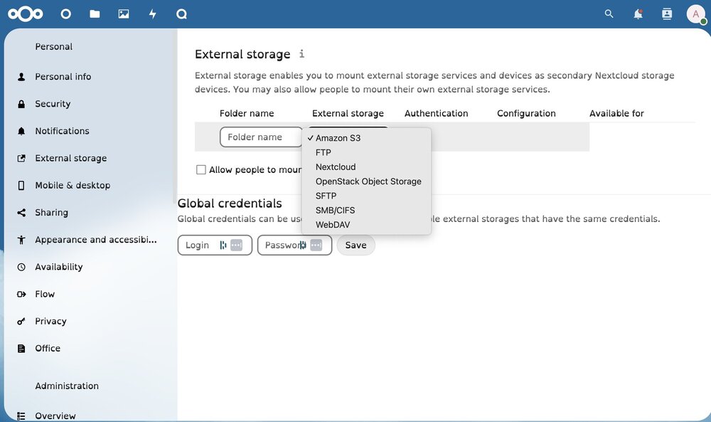

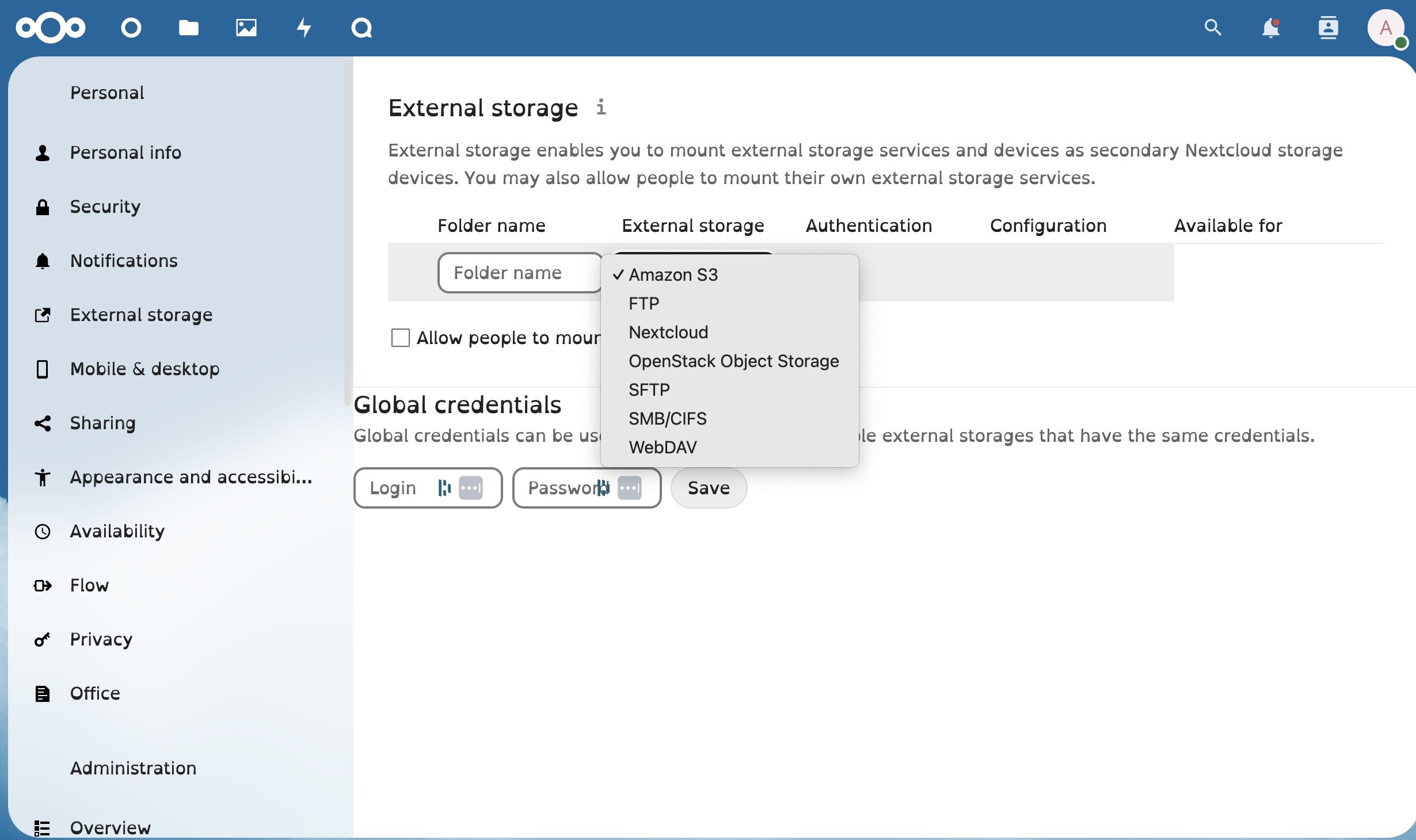

Nextcloud AIO (SpaceInvaderOne): Unable to mount local storage as an external storage location
Yeah I actually also realised this too. It's a bit confusing. I was going to share this update. The issue I now have (probably same as you) is that I'm now unable to access the share via SMB. Before, I could access my Music share on my Mac via SMB, logging into my user account that is 100% set up with read/write permission. Now, it says I don't have permission when trying to click on the Music folder on my Mac.
@Kilrah @SpaceInvaderOne I figured out how to enable local storage with this setup, but there are severe limitations: Before hitting apply on the SpaceInvaderOne docker container to build it for the first time, you need to add this Variable: Type: Variable Name: NEXTCLOUD_MOUNT Key: NEXTCLOUD_MOUNT Value: /mnt/the_directory_you_want_to_mount_as_local_storage Hit save, then apply. Then, once you have set Nextcloud up and enabled the external storage app, you will be able to mount that local storage location. I had to completely remove the install and start from scratch to get that to work. The problem with this is that I don't see how you could then add a second location as an external storage mount.
root@Tower:~# docker exec nextcloud-aio-mastercontainer id www-data uid=33(www-data) gid=33(www-data) groups=33(www-data),33(www-data),281(docker) root@Tower:~# I have tried doing this as the Admin user and Local is still unavailable as a selection. What is the alternative to local? SMB?
As this documentation recommends, I ran the following commands (including commands to first verify what the user and group IDs were: "root@Tower:~# sudo chown -R www-data:www-data /mnt/zfs/Music chown: invalid user: ‘www-data:www-data’ root@Tower:~# docker exec nextcloud-aio-mastercontainer id www-data uid=33(www-data) gid=33(www-data) groups=33(www-data),33(www-data),281(docker) root@Tower:~# sudo chown -R 33:33 /mnt/zfs/Music root@Tower:~# sudo chmod -R 750 /mnt/zfs/Music root@Tower:~# " I then restarted the container and went to the External Storage settings again. Unfortunately nothing has changed and "Local" is still not available as a choice.
I just followed @SpaceInvaderOne's video for setting up Nextcloud AIO in Unraid. I'm posting this here in General Support as there isn't yet a dedicated topic for this version of Nextcloud. Now I would like to mount some shares to it. But for some reason, "Local" is not showing up as a dropdown option in the External Storage administration settings: How can I enable local storage as a mount option? tower-diagnostics-20241031-1255.zip

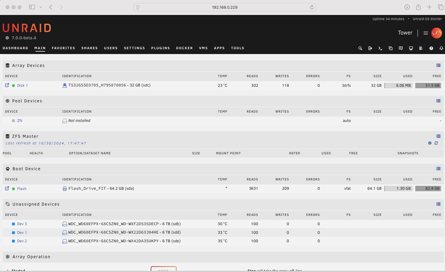

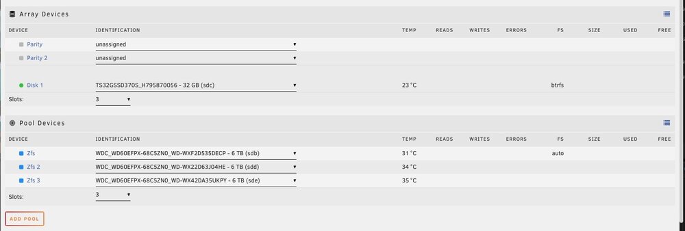

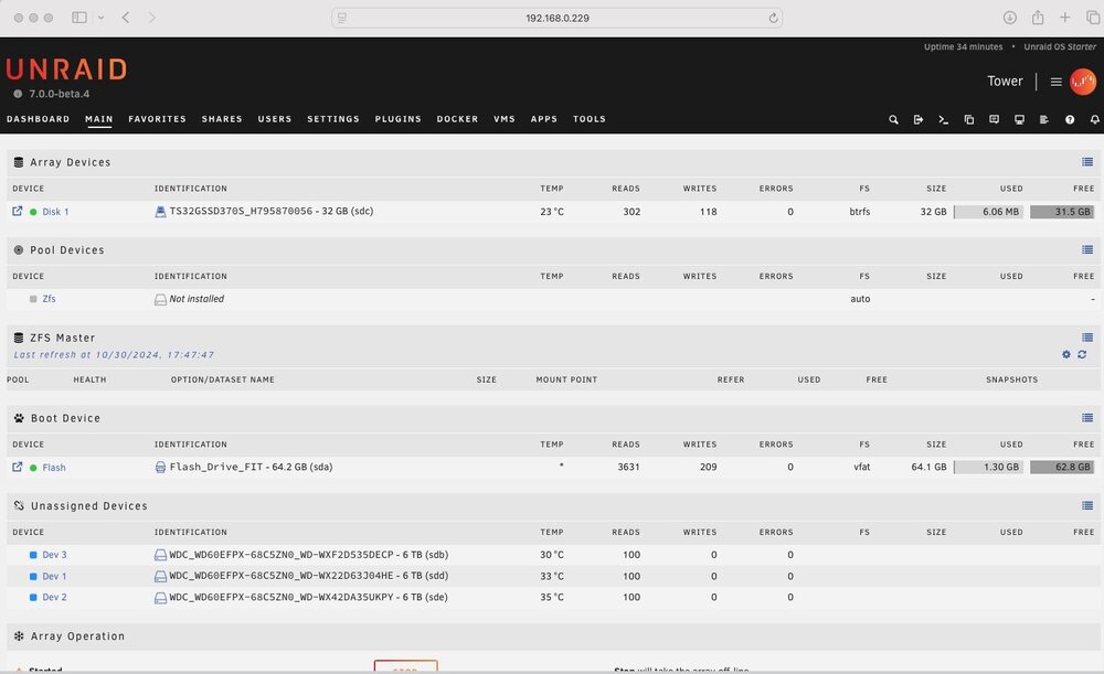

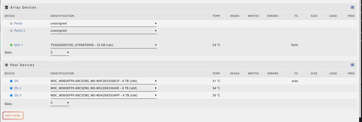

Have I lost all my data? Newbie seeking help diagnosing and fixing missing ZFS pool
Ok great, things are back up and running! Do I just need to wait some time before "NAS" is restored as the device name rather than "Tower"? Is there anything else I should do, or any checks or tests I should run?
Ok, so just before I go ahead and do that (so I don't make a mistake) I just need to re-add the drives to a ZFS pool and hit add pool? Does it matter which drives go in which ZFS device (ZFS, ZFS 2, ZFS 3)?
" root@Tower:~# zpool import pool: zfs id: 11624769833213067975 state: ONLINE status: Some supported features are not enabled on the pool. (Note that they may be intentionally disabled if the 'compatibility' property is set.) action: The pool can be imported using its name or numeric identifier, though some features will not be available without an explicit 'zpool upgrade'. config: zfs ONLINE raidz1-0 ONLINE sdb1 ONLINE sdd1 ONLINE sde1 ONLINE root@Tower:~# " Something else I'm noticing is that the name of the device "Tower" is not what the device was called before this mess happened it was called "NAS" before...
After doing some tinkering around deleting shares by moving their contents to temporary folders, and messing around with Docker settings, I went to reboot my NAS, but found that it got hung on the reboot and wouldn't come back on. I then rebooted it directly from the machine itself, pressing the power button once to reboot it. It now loads up the Unraid service, but my ZFS pool is missing. I use Unraid with 3x HDDs in RAIDZ1 and don't use any other main arrays or pools for use/storage, besides the compulsory array drive (a small SSD I installed) plus a flash drive. It now shows that my 3x HDDs are "unassigned devices", which is obviously really concerning. I don't know if this means I have somehow wiped the drives clean, or if there's anything I can do to restore things how they were. I'm attaching the diagnostics of my NAS: 1 - BEFORE I messed things up this morning 2 - AFTER messing things up Advice and support on how to (hopefully) restore everything would be really appreciated! tower-diagnostics-20241030-1753 (after problems).zip nas-diagnostics-20241030-1046 (before problems).zip

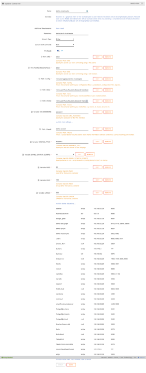

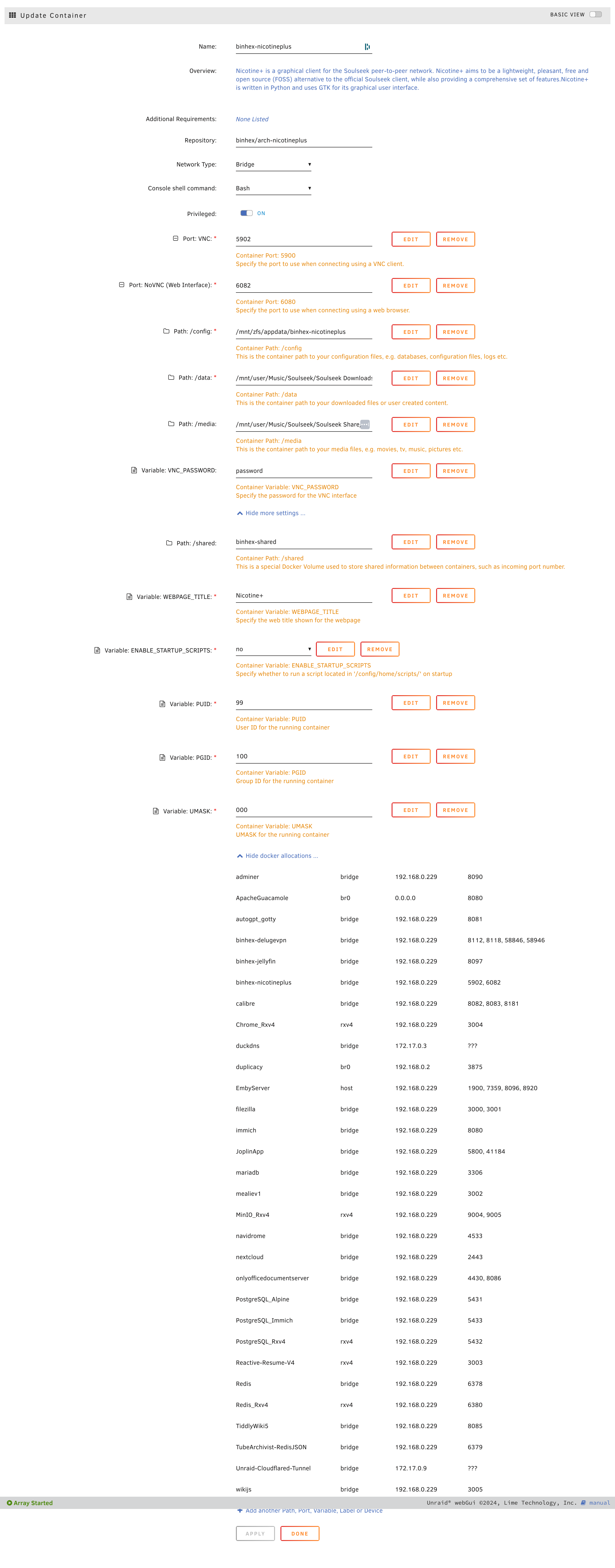

I am struggling to pinpoint why individual docker container images are taking up so much space. I watched the SpaceInvaderOne tutorial on how to fix Docker image size, but in that tutorial, his example shows his "Local Volumes" size being high. In my case, running his script instead showed this: There are 30 Images taking up ......30.74GB There are 30 Containers taking up ......718.9MB There are 49 Local Volumes taking up ......2.797GB There are 17 Build Cache taking up ......11.16MB When looking at the configuration settings for one example, Binhex-Nicotineplus, I can't spot what's wrong about my config for it. I understand that I need to be looking for path mappings that don't correctly map to a location on my server, but I feel like I'm staring at the config file and missing something obvious. Any help appreciated. SpaceInvaderOneDockerScript.txt nas-diagnostics-20240906-1642.zip
[Support] binhex - Nicotine+
Ah awesome, that worked! Thanks a lot
