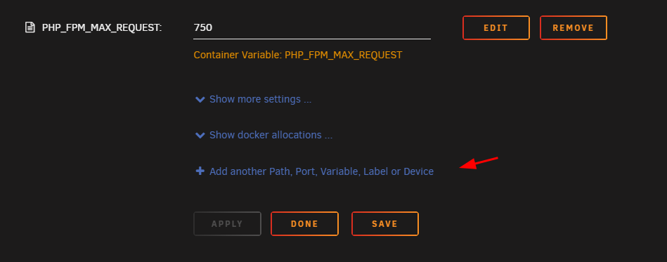

1 hour ago, Becksy said:
No i havent. How i do that?
like on any other docker, any other mount, ...
may as note, take a look at some basic informations like unraid docs (actually thats basic docker ... not Unraid related ;))
edit docker, buttom ... add another path .....
Merry Christmas ;)
Merry Christmas ;)
Great thank you.
Merry christmas :)

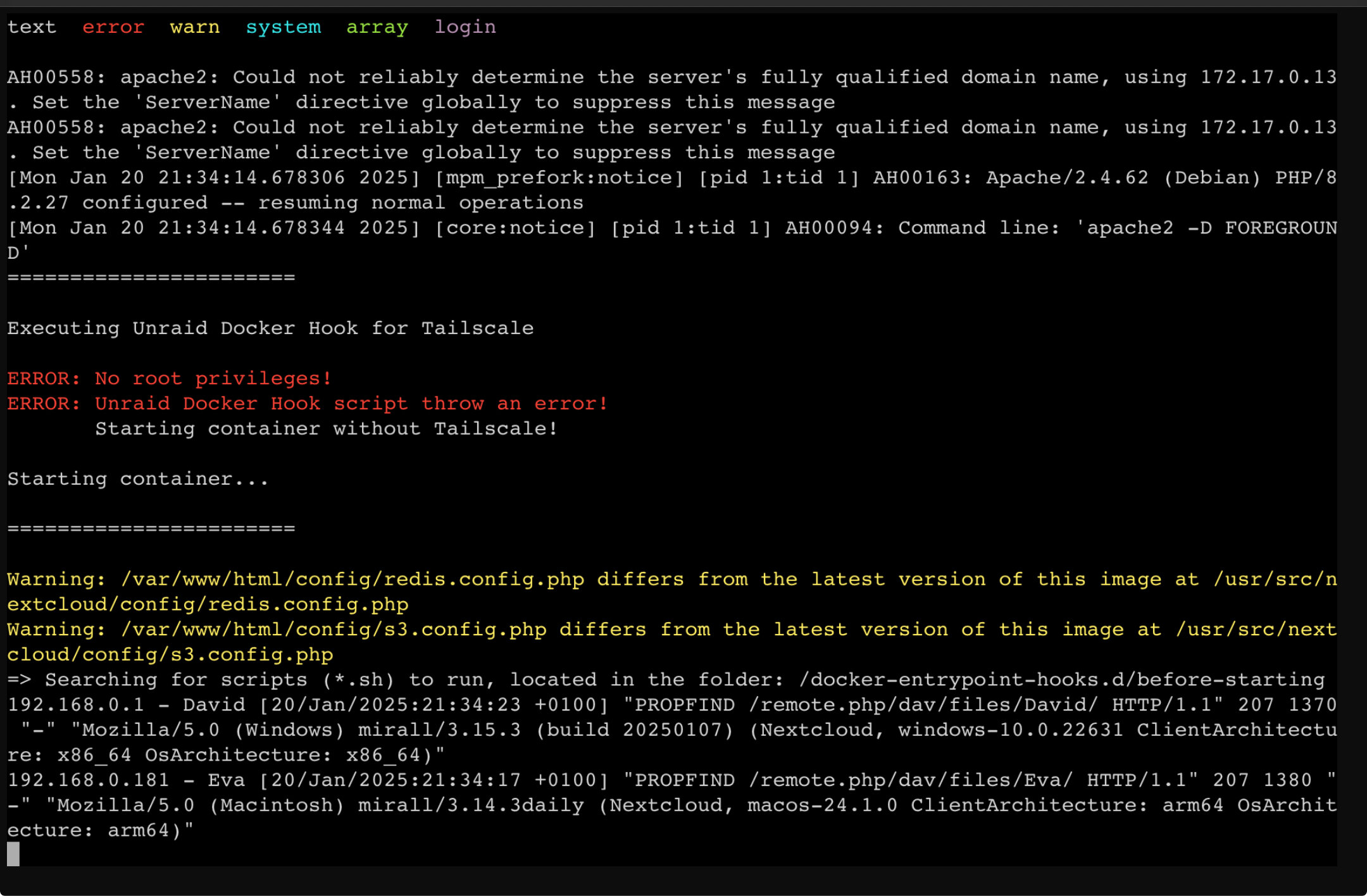

Hello !
When i try to activate MatterBridge Talk app, it's not working in Talk and i have this error in log :
Trying to access array offset on value of type bool at /var/www/html/custom_apps/spreed/lib/MatterbridgeManager.php#908
I have a config to do with the activation of the app? Like create a user for put it in a config? (i searched already, saw this for the original Matterbridge app but not for the talk one).

Got the docker nextcloud up and running until I messed around and tried turning on Tailscale. Since then I cant access the WebGUI anymore: internal server error. How do I reverse my srew up? As I don't quite know where to begin, please point me in the right direction. Appreciate your help.
Found this error message in the nextcloud log file:
Failed to connect to the database: An exception occurred in the driver: SQLSTATE[HY000] [2002] Connection refused
That's a pointer, right? Please...
Thanks,
Fred
Edited by Fred-Unraid

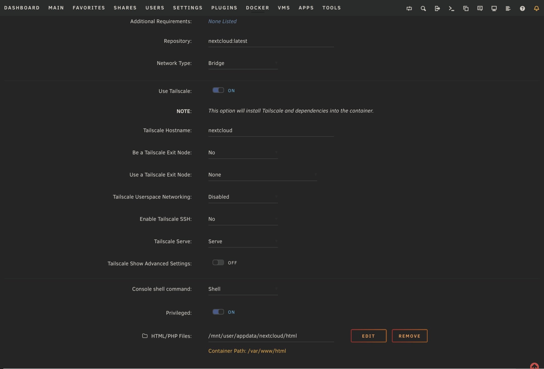

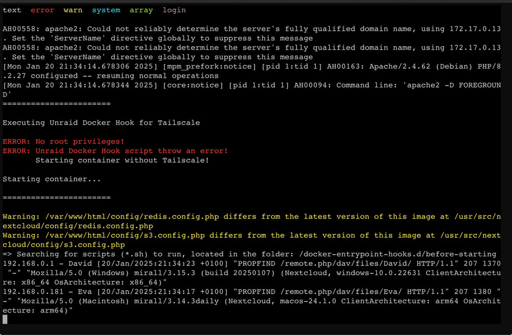

Helo, I am trying to connect he docker with TAILSCALE at the new version 7.0 of UnRaid, but I get an error about user account. How I can make access to NExtcloud trought a Tailscale node?
Thanks

Hey, can you provide more info - logs etc.
i dindt check that feature but it would be interessting to get it running.
cheers
UnRAID 7.0
Tailscale integration is a hack that doesn't work with a lot of containers and that many don't recommend using at this point.
Edited by Kilrah

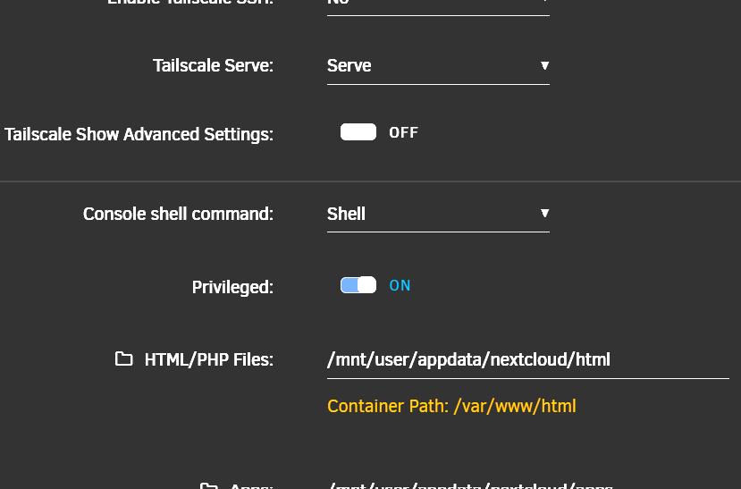

On 1/20/2025 at 9:36 PM, Atorcha said:
UnRAID 7.0
Have you used it with privileged ?
It is not recommend to do, but it seems to be needed

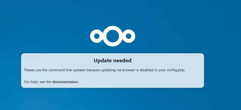

NEXTCLOUD show message
Atualização necessária
Please use the command line updater because updating via browser is disabled in your config.php.
Precisando de ajuda, leia a documentação.
How I solve it ?
I have changed to priviledged but it has the same error.
Edited by Atorcha
im having the same prob. I also have changed the privilege but it has the same error.
How I solve it ?
I have the same issue
did you solve it ?
I have this problem where i need to update
I use this commands to update but it says permission denied
docker exec -it -u 33 f23723092316 /bin/bash
./occ upgrade
Can someone help me because i dont know what to do
./occ upgrade
The command for the unraidterminal should be:
docker exec -u www-data DOCKERNAME php occ upgrade
