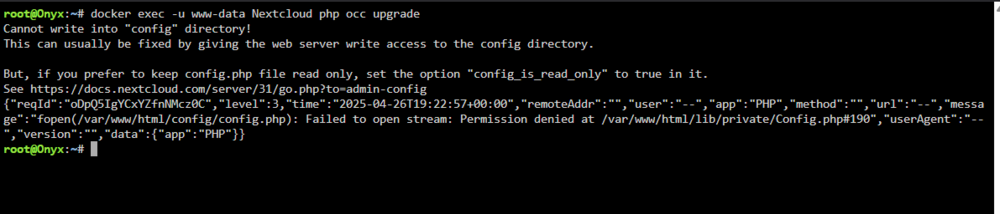

  • nextcloud-cronjob container in CA with user set to 99 should work
  • Try   docker exec -u 99 Nextcloud php occ upgrade   This template by default runs NC as 99:100.

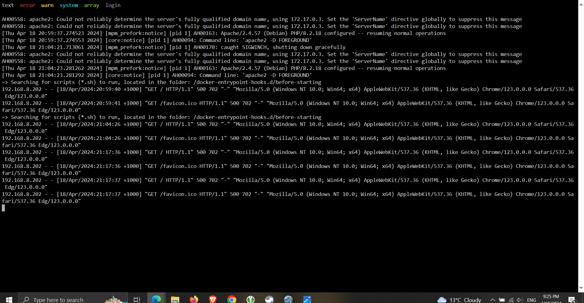

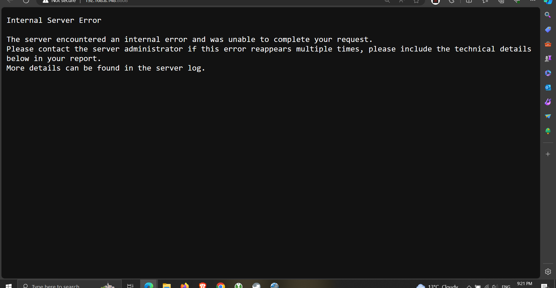

I'm new to NextCloud but having setup OC in my system I decided to try it out. I created a docker this afternoon, a custom share for data folder and MariaDB. I got to the setup page however I keep getting the following error:
Internal Server Error The server encountered an internal error and was unable to complete your request. Please contact the server administrator if this error reappears multiple times, please include the technical details below in your report. More details can be found in the server log.
I restarted the docker and checked the logs, however I only get:
172.16.0.37 - - [19/Apr/2024:14:45:51 -0400] "GET / HTTP/1.1" 500 702 "-" "Mozilla/5.0 (Windows NT 10.0; Win64; x64; rv:124.0) Gecko/20100101 Firefox/124.0"
172.16.0.37 - - [19/Apr/2024:14:46:28 -0400] "GET / HTTP/1.1" 500 702 "-" "Mozilla/5.0 (Windows NT 10.0; Win64; x64; rv:124.0) Gecko/20100101 Firefox/124.0"
I can share the config.php in part if it would help, however I wanted to know if there is something else I should be looking at as to why this error keeps popping up?

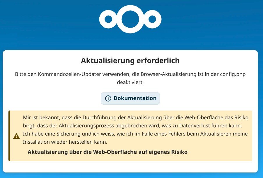

Hallo,
habe nextcloud aktualisiert, nun komme ich aus dem Wartemodus nicht mehr raus.
Kann mir jemand weiterhelfen?
16 minutes ago, geromme said:
Hallo,
gibt es Log Einträge die helfen können, alternativ einfach in der Config wieder zurück stellen.
Bitte Fragen auf Englisch stellen, damit alle etwas davon haben.
Danke!
Cheers

6 minutes ago, Kabal74656 said:
Hallo,
Liebe Unraid gemeinde ich habe seit neustem das Problem mit Unraid und Nextcloud,
seit einem Update ist Nextcloud im Wartungsmodus im Terminal habe ich folgenden Befehl schon ausprobiert,
docker exec -it nextcloud occ maintenance:mode --off
Allerdings spuckt Unraid mir eine Fehlermeldung aus
OCI runtime exec failed: exec failed: unable to start container process: exec: "occ": executable file not found in $PATH: unknown
Da ich neu bei und mit Unraid bin, bin ich gerade etwas überfordert,
In der config Unraid habe ich versucht den Maintrance Modus auch auszuschalten dann funktioniert Nextcloud ebenfalls nicht, siehe Bild 2
vielleicht kann mir ja hier einer helfen.1267203709_Screenshot2024-04-29113038.thumb.png.e9af0e835885a21500e9b548c2349b48.png
was sagt das log file?
 Das wäre interessant.
maintenance muss auf false.
lass das lieber auf englisch klären, das ist sonst unfair.
cheers

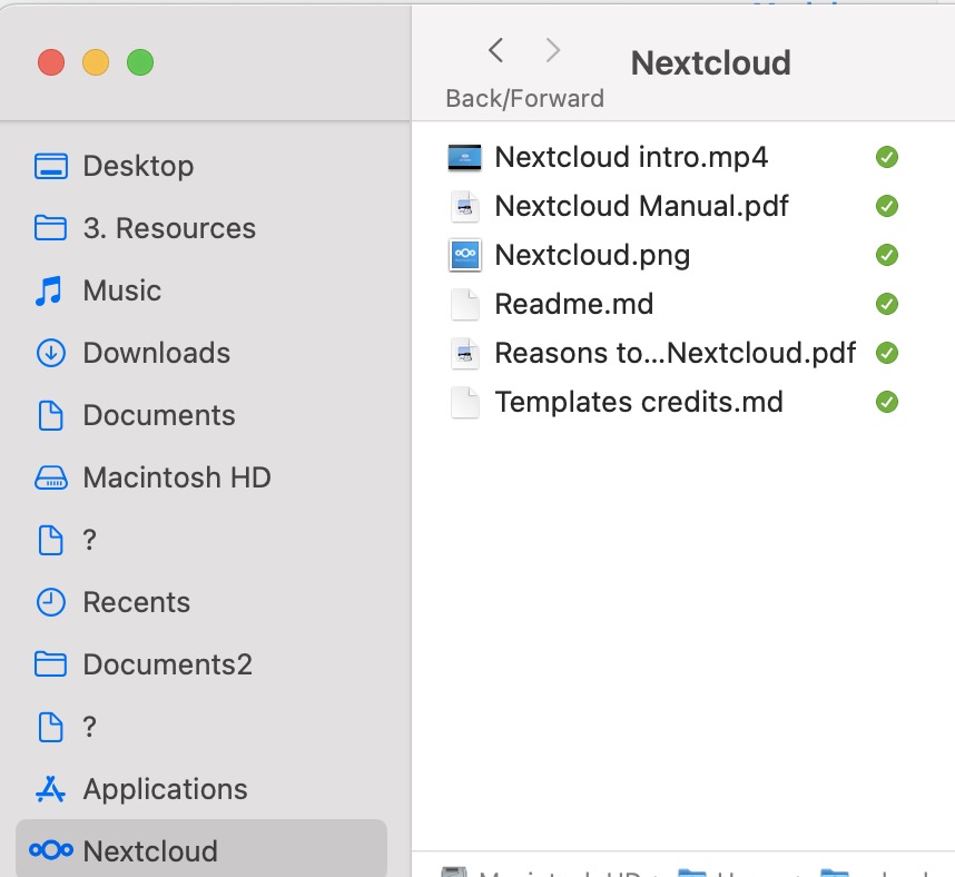

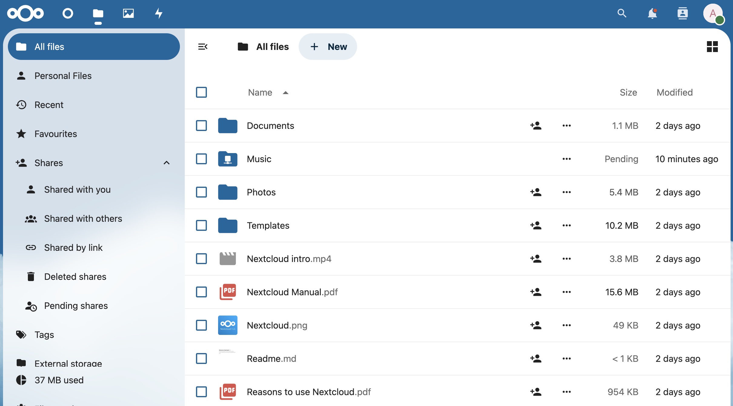

I just followed along with SpaceInvaderOne's tutorial on setting up a share from Unraid to be read within Nextcloud. And I can now see my Music folder from Unraid in Nextcloud.
I have the Nextcloud desktop client installed on my MacBook. Next, I want to be able to access this Music folder from my MacOS Finder window. For some reason though, these are the only files I can see in the Nextcloud location.
2093411123_Screenshot2024-04-30at12_51_33.thumb.jpg.0b43d6b3353eba0e25abf80aad570146.jpg
Am I missing something? Any help very much appreciated.
Firstly it seems to be still scanning the contents, secondly you may need to go into the client app settings and select it manually for syncing if it's large.
