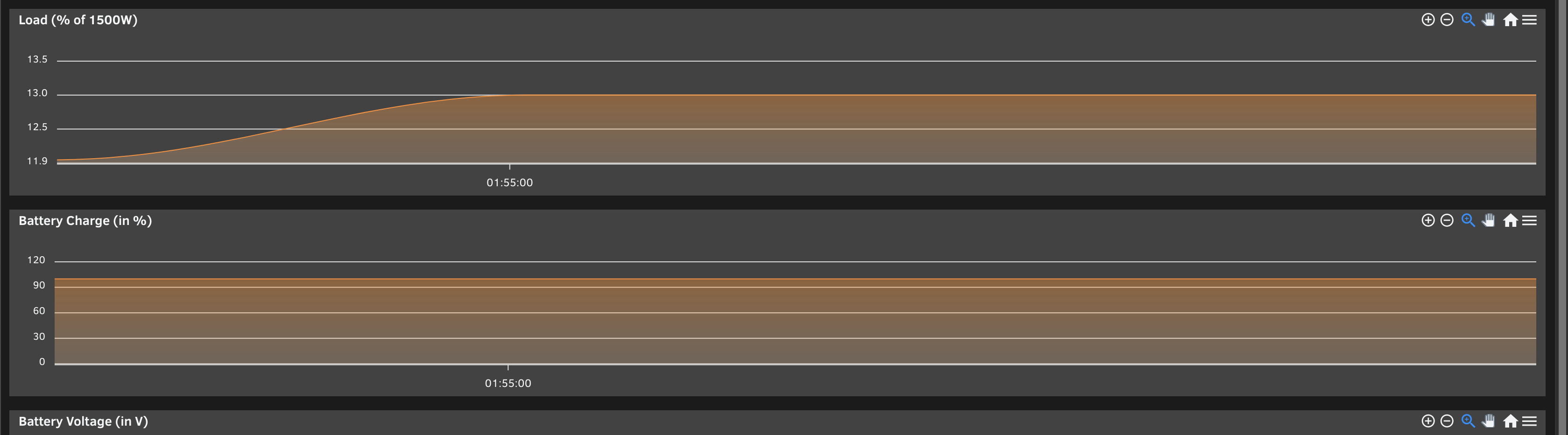

  11. Hi, sorry kind of a beginner question. In the statistics page is it possible to somehow multiply the UPS load value as it is given in a percentage but it would be a lot easier to have it given in watts.
