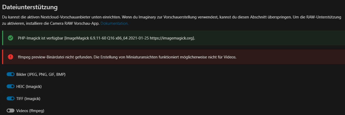

Hi i tried now several hours - and cannot fix this problems:
installing the bz2
and
adding ffmpeg preview
Can someone tell me how to fix this?
installing the bz2
and
If you try to install additional moduls youre maybe better of wirh @Kilrah Nextcloud.  He rebuilds the official build and adds those moduls.
else you have to build a script thats installs all dependencies at the start of the container. If you restart the container everything is flushed.
cheers
cheers
thanks a lot
