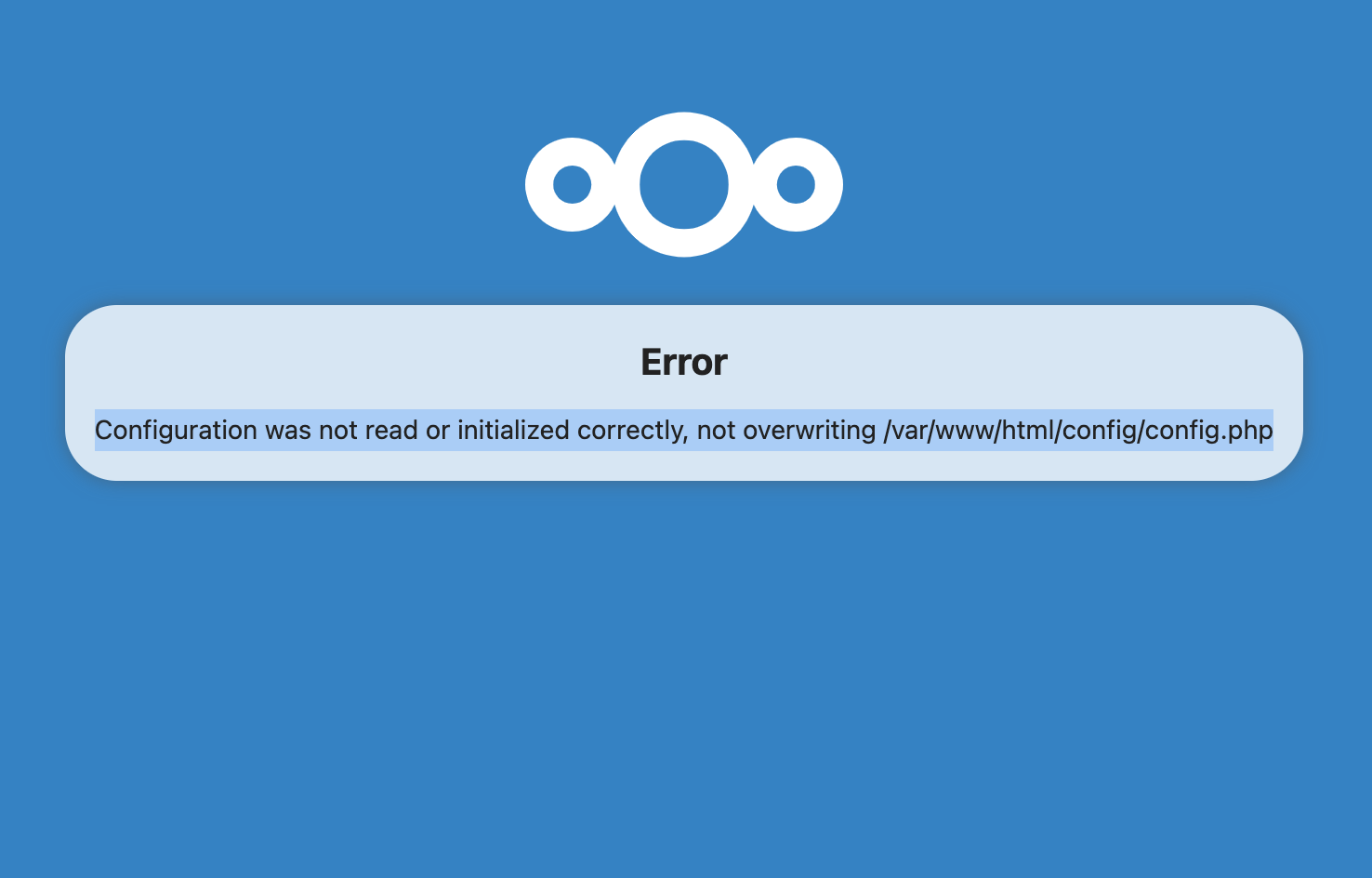

Hi all,
I'm getting this error when trying to access my Nextcloud after upgrading unraid
Configuration was not read or initialized correctly, not overwriting /var/www/html/config/config.php
EDIT: Found everything myself deep down in this and another nextcloud thread, so no help needed anymore.

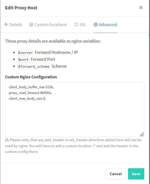

Hey all - I have a problem with big file upload. I am able to uplaod big files up to 25Gb but everytime after a big file uplaod, a few hours (or days) later my complete Server dies. I'm then not able to open the unraid dashboard or any of my dockers webui (nextcloud, jellyfin, ... everything dead). The file itself is fine when I look it up on my disk(the file is assembled out of chunks. After the uplaod I'm able to download it without error and nextcloud shows no error messages. I#m not sure right now if SMB share still works when everything is dead.)
Only way for me then is to go to my server and hold the on/Off button till it shuts down. Then when I restart, everything works fine, until I upload the next big file. For making Big File upload possible I added the following variables to my Docker:
PHP_UPLOAD_LIMIT = 50G
Also I gave PHP 2Gb of Ram with
PHP_MEMORY_LIMIT = 2048m
I'm using a NginxProxyManager where I also got some 'Custom Configuration':
real_ip_header CF-Connecting-IP;
client_body_buffer_size 512k;
proxy_read_timeout 86400s;
client_max_body_size 95M;
Does someone know this problem and/or can help me where I can Download the Logs and what Logs would be interstinng to lock into? I allready enabled Unraid mirror Log to Flashdrive. Can I Upload this Log without being worried that personal Info will be in there?

On 1/9/2024 at 6:05 AM, jordfoz16 said:
Hi all,
I've got the same issue, I;ve gone ahead and chown -R www-data:www-data entire /html directory.
I still get this message, any assistance would be appreciated.

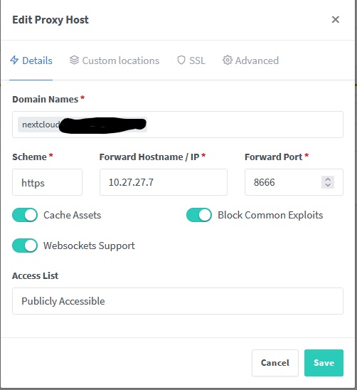

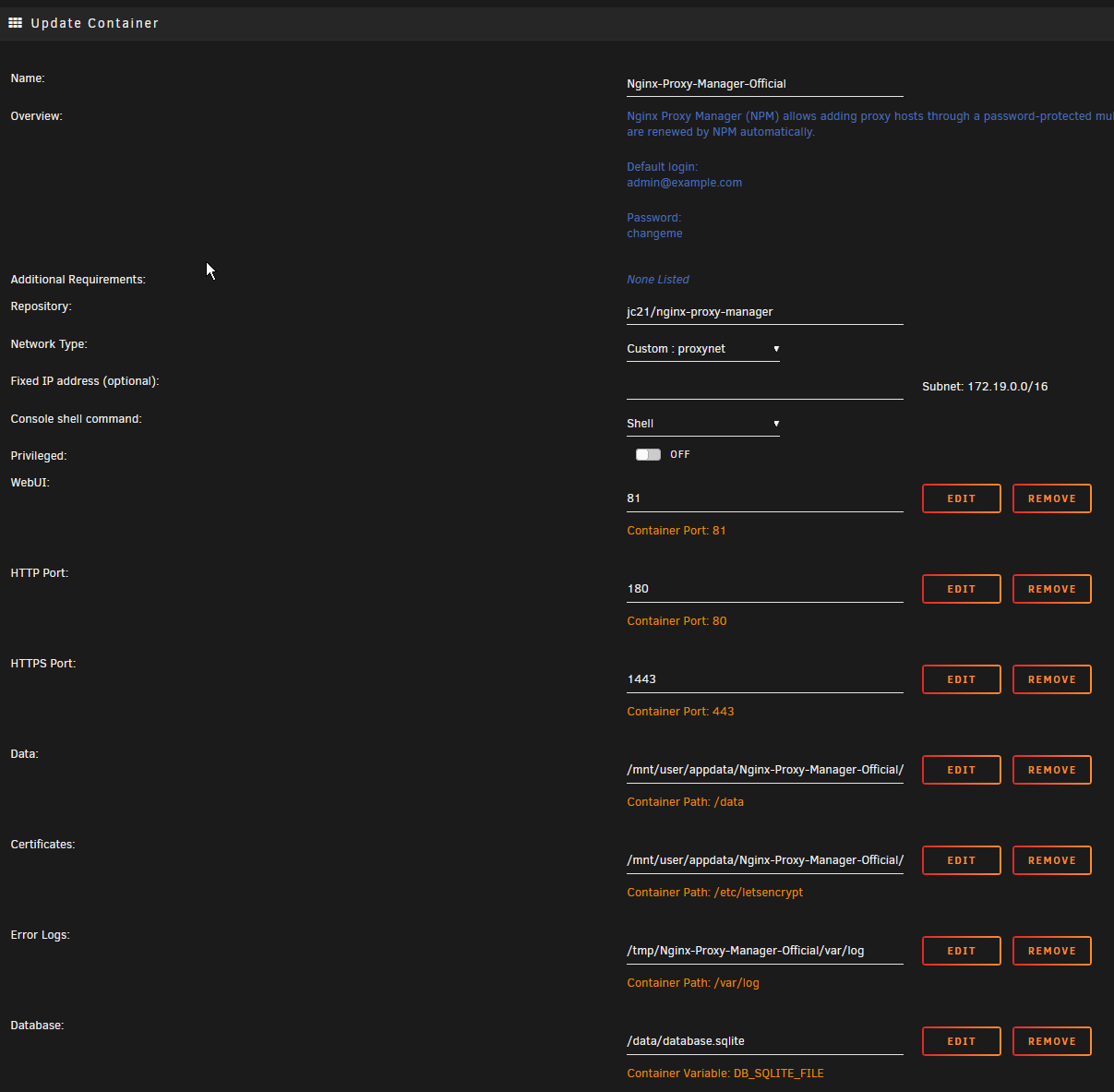

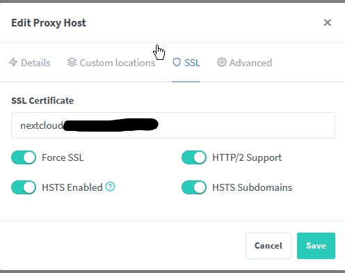

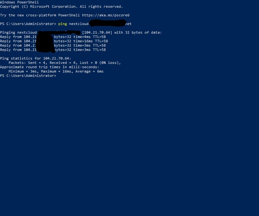

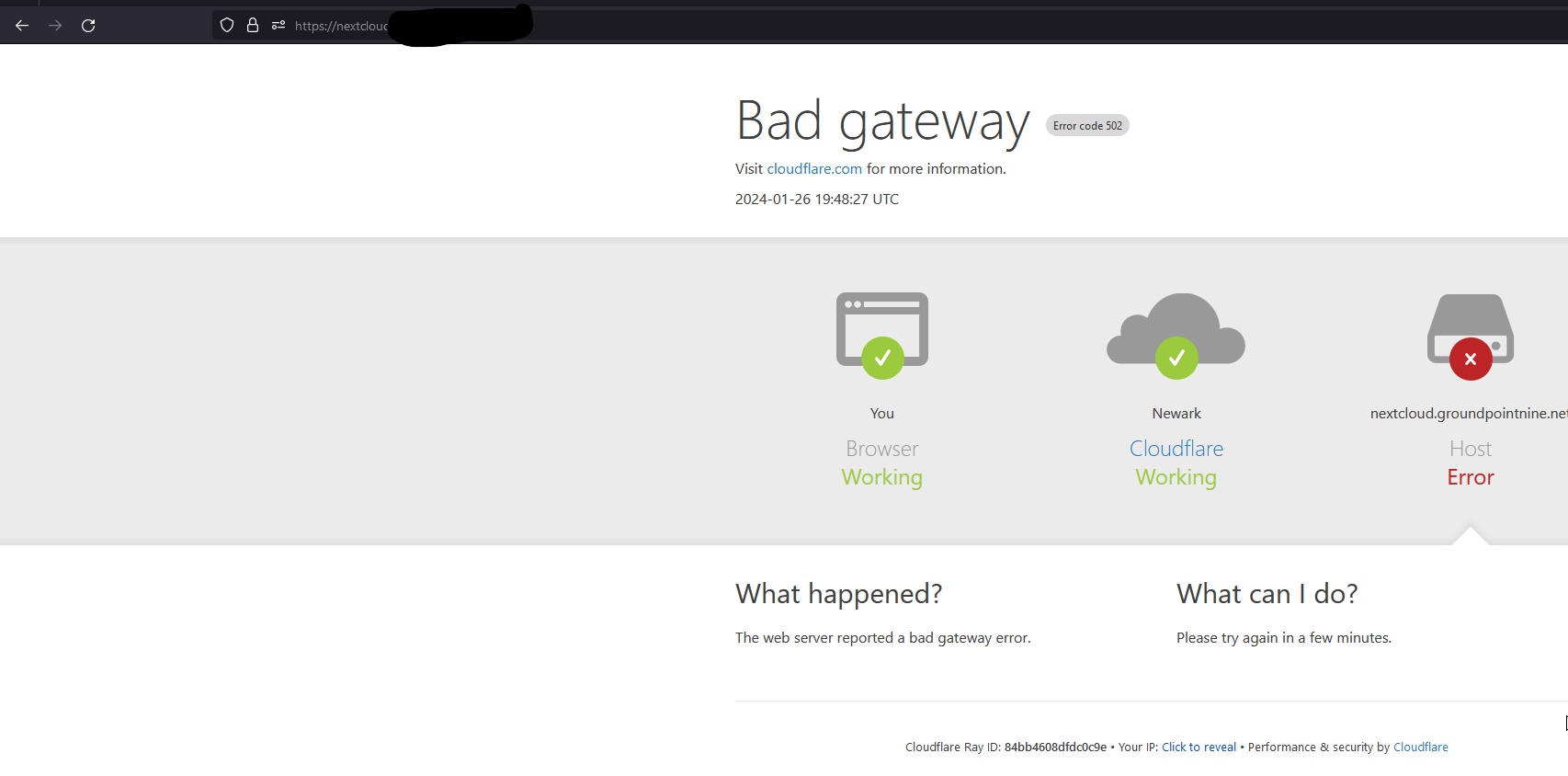

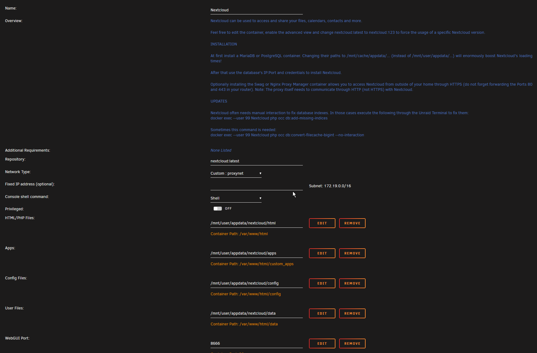

I give up trying to setup nextclould, cloudflare, reverse proxy w/ NPM and this docker container. No matter what I do, I just can't figure it out. Sure I can access the local http server but as soon as I do anything releated to the revers proxy and https, it's all FUBAR'd.
If anyone wants to hold my hand through the process? Beers and coffee are on me!
Main Docker config:
Nextcloud Docker Setup:
NPM Official Docker Setup:
NPM proxy host setup:
Ping of my domain for cloudflare functionality:

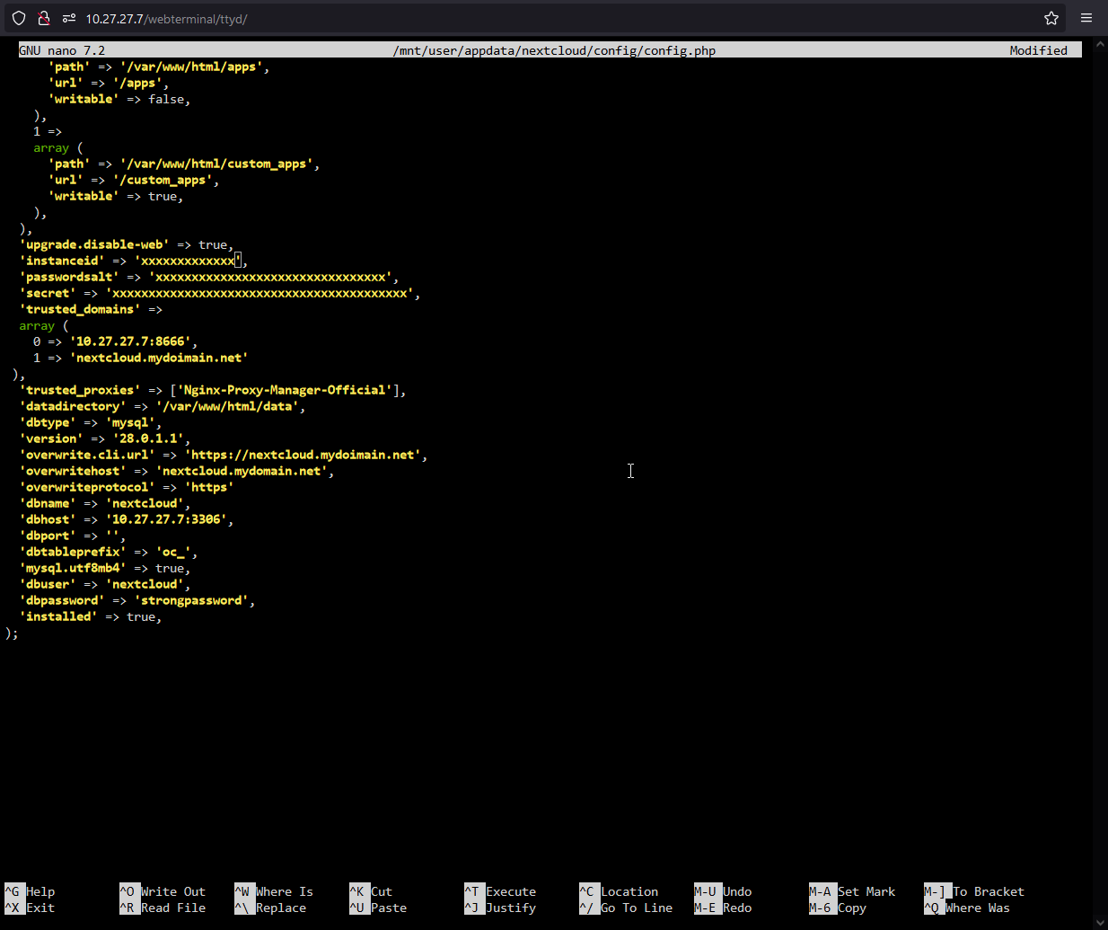

nextcloud config.php setup:
Router Config (Port Foward/Opening):
Results:

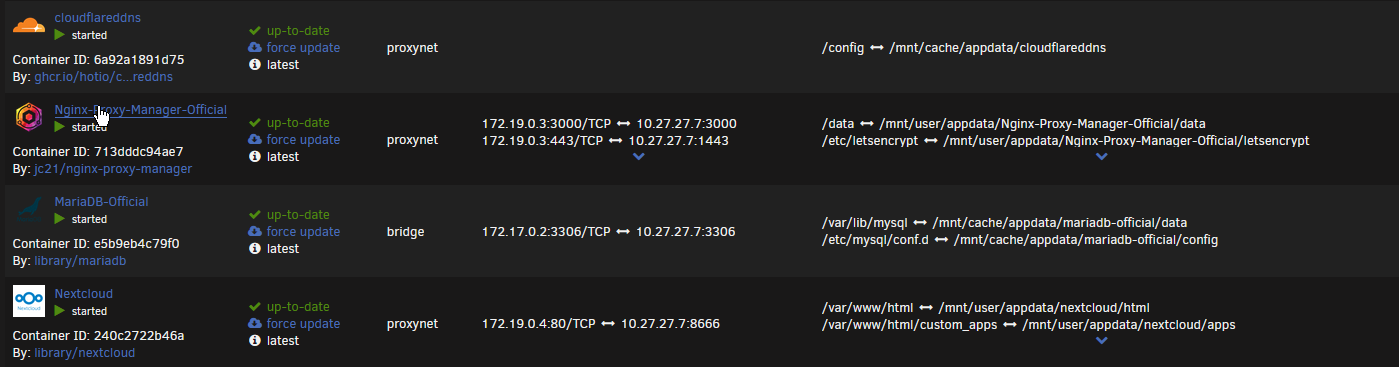

Nextcloud logs?
Also any reason your mariadb container is on another network?
1 hour ago, Kilrah said:
Nextcloud logs?
Are you talking about the logs when viewed from unraid by left clicking on the docker image for nextcloud? Or the nextcloud logs located at /mnt/user/appdata/nexcloud/data/nextcloud.log ?
Does this mean anything to you? It's the log from right clicking on the docker image after start up.
The container being on a bridge network was an oversight. I've changed it but nothing has changed, unfortunately.
I truly think I have the proxy setup correct.... It's the nextcloud config,php/internal (LAN) config that's wrong. How and what I have set wrong, I have no clue.
Edited by SpinCykle
You have to set "http" -hostname -ip in nginx proxy manager edit proxy, not "https".
Thank you this did the trick!
