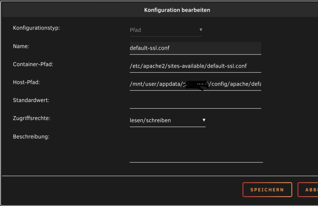

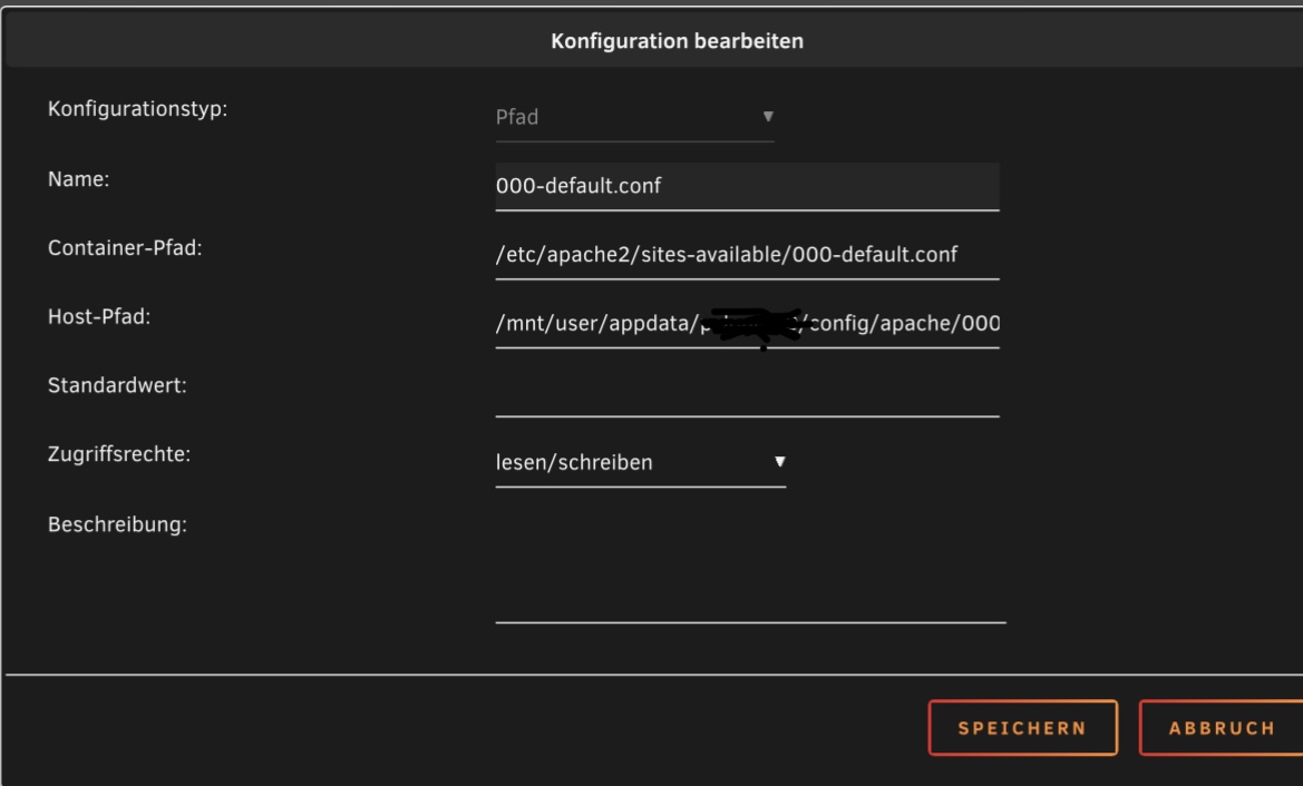

On 6/6/2023 at 1:21 PM, Siruscool said:
thanks a lot for your feedback regarding this topic.
I use also NginxProxyManager for my Netcloud. I have add the lines as you mentoried to advanced section but the result is the same as before. The upload from the files starts but on the end of the upload process i got the failure message from the app that the file size are to big.
Move the files "000-default.conf" and "default-ssl.conf" from the "/etc/apache2/sites-available" directory to a new folder.
Create a symbolic link to the new folder for both configurations.
Edit both configuration files and add the line "LimitRequestBody 0" to allow unlimited uploads.
This change is necessary due to limitations imposed by the web server in newer versions of Apache (2.2) and Nginx.

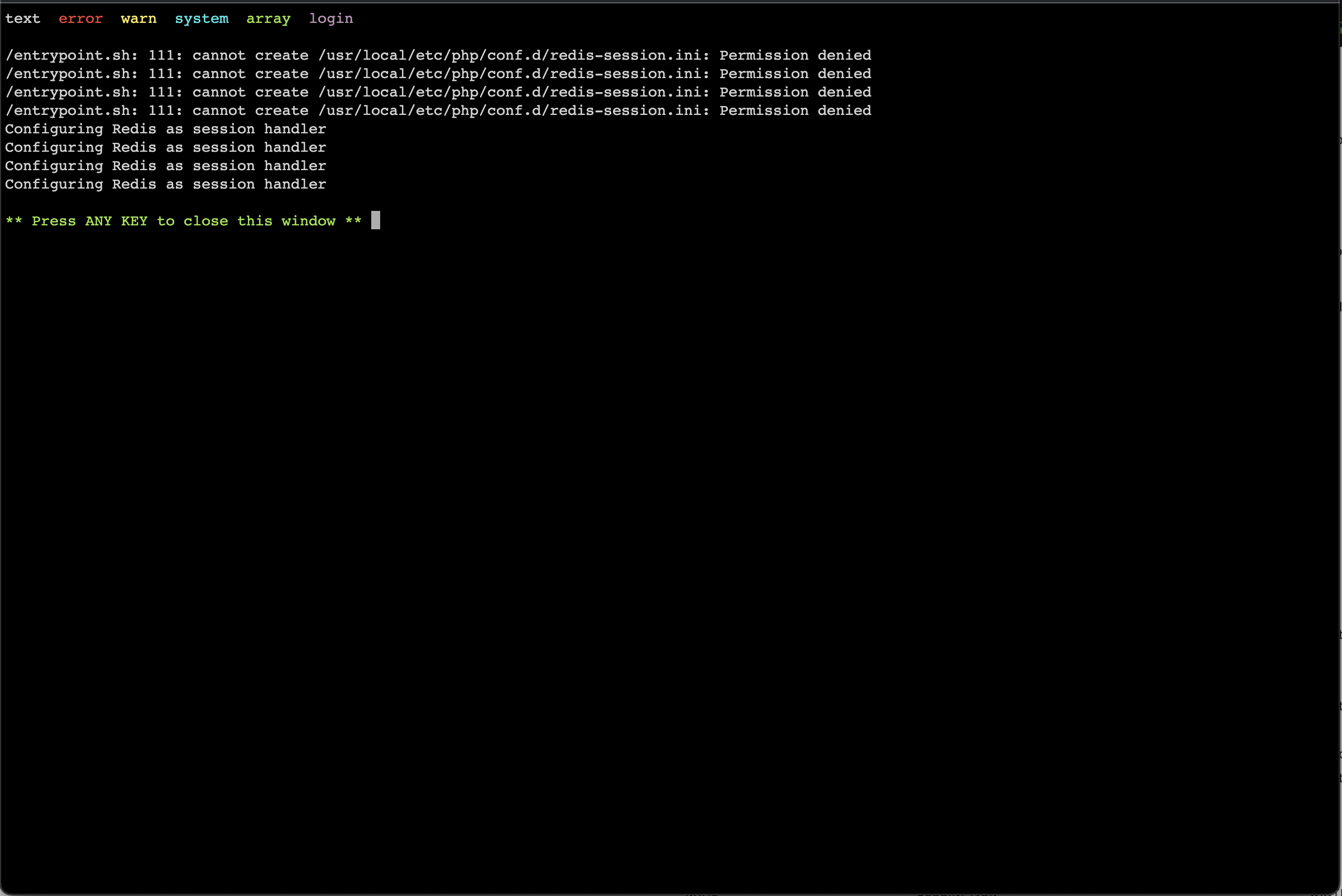

Hello, I was running official nextcloud with mariadb and redis for seven months without any issue. After todays nextcloud docker image update container won't start. Does any of you expirienced such problems lately? Thanks for any help.
