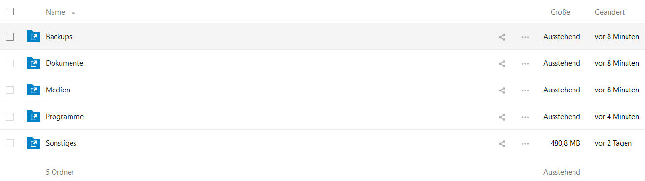

Hello,

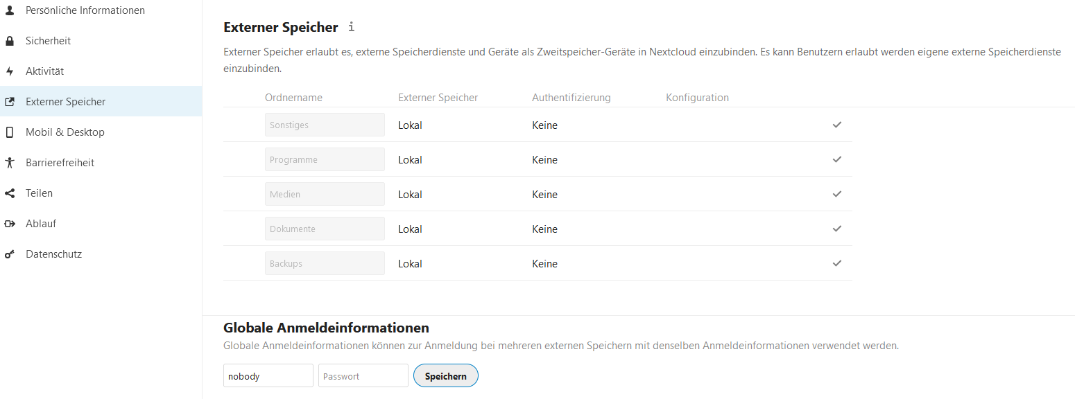

when I mount external storage in Nextcloud and then refresh the page, they are duplicated:
1528095759_2021-10-0612_06_06-Einstellungen-Nextcloud.thumb.png.82d0b18156920b104425e0b2d7bae065.png
That's not normal, is it?
If I simply delete one of the duplicates there, I'm missing data in Nextcloud that is there in the original location.
Unfortunately, deleting Docker with the associated folders and then setting it up again did nothing.
In Nextcloud itself, however, only one of the folders is displayed under the files. Which would actually be correct.
1548977654_2021-10-0612_08_26-Dateien-Nextcloud.thumb.png.6a7b0bfa2faea935bfd9a2a2fc538928.png

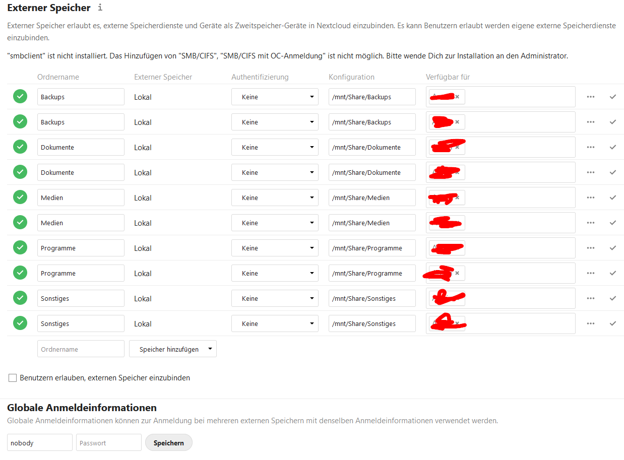

Only in the settings under external storage, it irritates me that everything is duplicated.

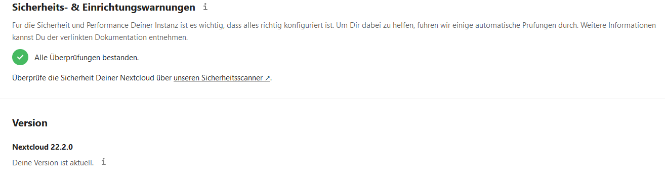

Edit:
I have no security & setup alerts:
2007409272_2021-10-0612_15_14-Einstellungen-Nextcloud.thumb.png.e1e714302c69b2320b11ac30f5a1e5fa.png
Edit 2:
Strange, the account with which the external folders are shared, they are also in the settings correctly:
2019691408_2021-10-0612_30_45-Einstellungen-Nextcloud.thumb.png.900afc30de54f7767f605b69f2130cd6.png

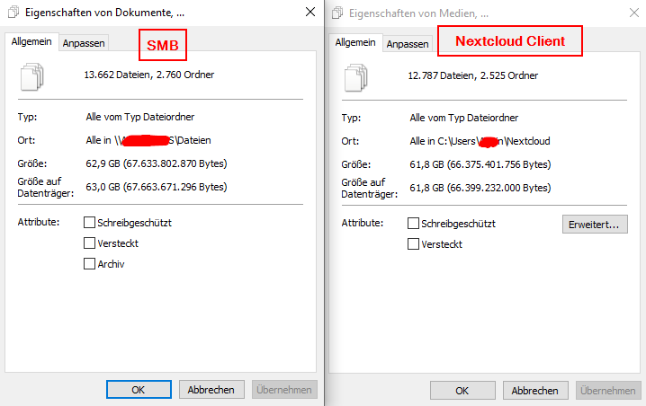

But files also seem to be missing when I leave the duplicates in the Nextcloud Admin settings.
454707060_2021-10-0612_36_47-EigenschaftenvonMedien....png.d9d175c11f42d5cb9cad0ad3899ce3f2.png
Edit 4:
All files are synchronized. I have completely cleared the ignore list in the Nextcloud client.
Had not thought that so many files were ignored
But why is any external storage always shown duplicated in the settings in the admin account?

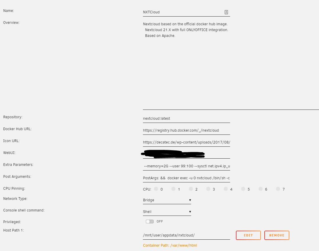

Trying to use this to replace a b0rked LinuxServer version, and this was recommended to me.
I already have a nextcloud, currently stopped, but I'm not deleting it yet, so I wanted to add yours as "NXTCloud" and changed the folder mappings appropriately, and added the variables and parameters you mentioned, even added a port number for bridge mode.
It doesn't want to launch however.
Removing container: NXTCloud
Successfully removed container 'NXTCloud'
Command:root@localhost:# /usr/local/emhttp/plugins/dynamix.docker.manager/scripts/docker create --name='NXTCloud' --net='bridge' -e TZ="Europe/Paris" -e HOST_OS="Unraid" -p '8666:80/tcp' -v '/mnt/user/appdata/nxtcloud/':'/var/www/html':'rw' -v '/mnt/user/appdata/nxtcloud/apps':'/var/www/html/custom_apps':'rw' -v '/mnt/user/appdata/nxtcloud/config':'/var/www/html/config':'rw' -v '/mnt/user/appdata/nxtcloud/data':'/var/www/html/data':'rw' -v '/mnt/user/Share/':'/mnt/Share':'rw' --memory=2G --user 99:100 --sysctl net.ipv4.ip_unprivileged_port_start=0 'nextcloud:latest' PostArgs: && docker exec -u 0 nxtcloud /bin/sh -c 'echo "umask 000" >> /etc/apache2/envvars'
2c3b5dfa03141bda7dbd795480db77ec70845af59c511b1ae910008bded9e6b8
Error: No such container: nxtcloud
The command failed.
It's sad if I'm too blind to do monkey see monkey do, but I'm stumped, really.

yeah it's the post-args, tried removing some stuff and it won't behave.
If I remove all the post-args the container launches.
I'll try and rename it lower case. Cheers.
2 minutes ago, alturismo said:
may try naming your container lower case ?
Renamed to lower-case - postargs: docker exec -u 0 nxtcloud /bin/sh -c 'echo "umask 000" >> /etc/apache2/envvars'
No joy, container won't load.
log says: /entrypoint.sh: 194: exec: docker: not found
