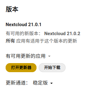

On 5/25/2021 at 6:53 PM, knex666 said:
Hi, just change the Repository to nextcloud:21.0.2-apache or
nextcloud:latest to get all new updates I am running on stable-apache
You can find a list of supported tags here https://hub.docker.com/_/nextcloud?tab=description&page=1&ordering=last_updated
i already set the repository to nextcloud:latest. but still not work. it will back to first page when i click the update button, nothing else. why?
