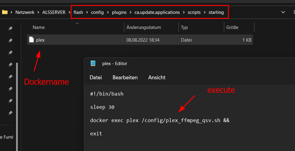

you may could use the auto exec function from CA Auto Update which ONLY runs while auto updating
Thank you, that worked!
