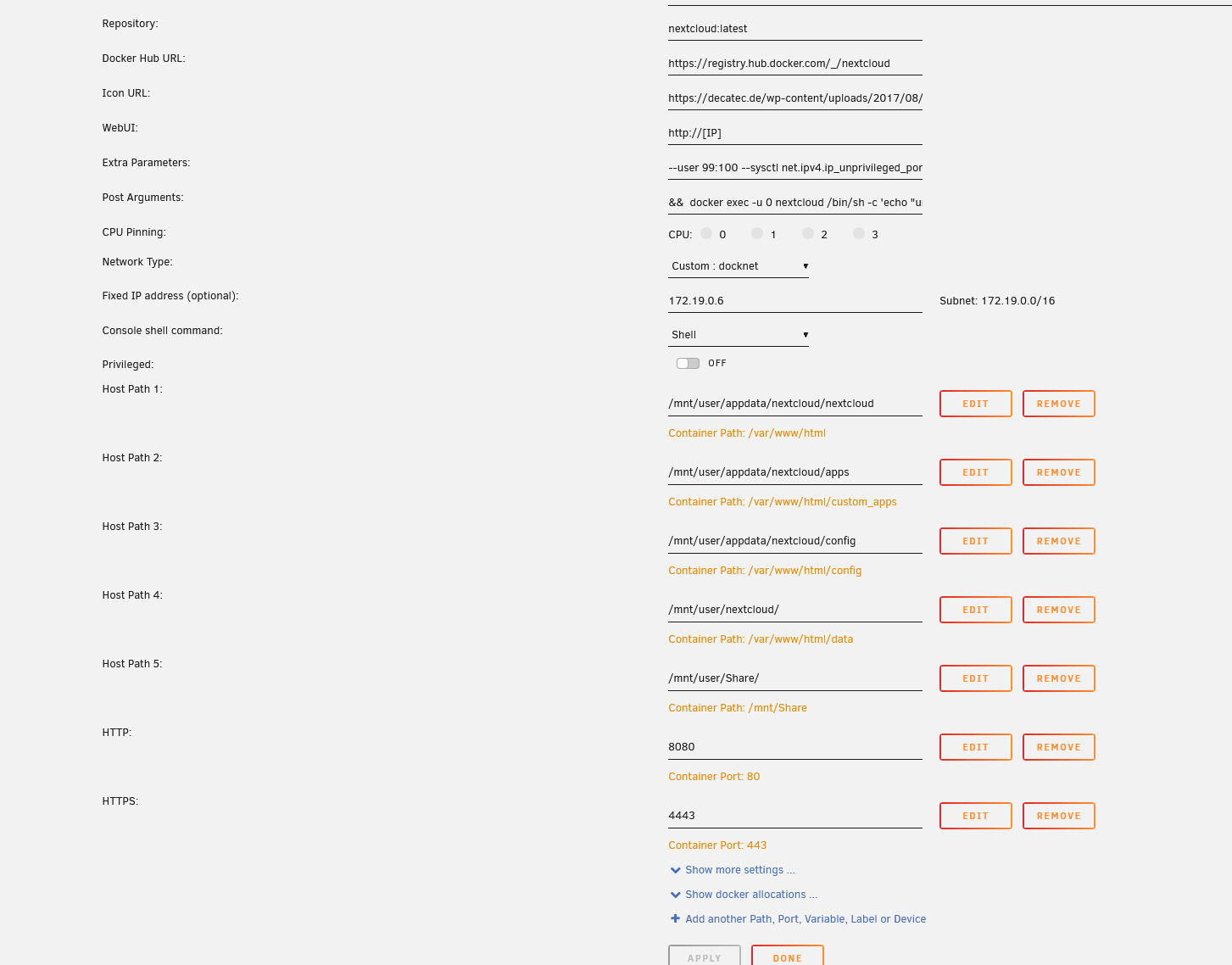

Hello,
I'm pretty new to this so forgive me if this is a basic question.
I have successfully managed to setup SWAG and got emby working on it, now I'm trying to do the same with Nextcloud. When I installed this container it didn't map any ports for me so I created a new HTTP mapping (80 to 8080) and I did the same with HTTPS (443 to 4443). It works and installs fine on port 8080 but it does not answer at all on port 4443. In the official image of nextcloud I can see that only port 80 is exposed (https://hub.docker.com/_/nextcloud)  but if this is the case then how can I setup SSL for it?
I tried changing stuff in nextcloud/config/config.php (trusted domains) but no matter what I did it wouldn't work. I would appreciate any help. Thank you

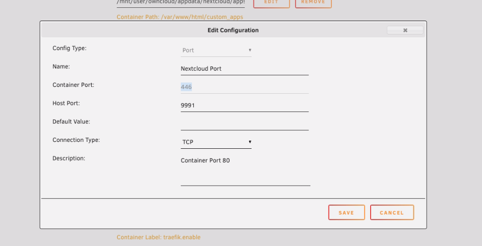

@knex666 Being using this docker for a long time. Did a switch up from swag to traefik and I am going thru the config and hit a snag with ports. This based on the official nextcloud docker and ports is 80:8080. However when editing the template it says port 80 but in fact in the container is set to 446. Was this on purpose or did I magically set that somehow? because i cannot edit it to the default 80.
You got some tricks that I cannot explain.
can you just change that Port?
 I cannot, its greyed out.
 I might try to start from scratch with my current app folder so i don't lose data.
Okay, i take a look at the template xml. Theres maybe an error
Hi, I checked the template I did not use any port forwardings so you should delete that option and add a new one. I didnt get it.
Will do

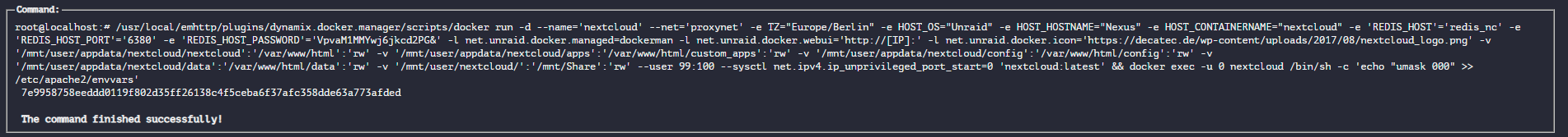

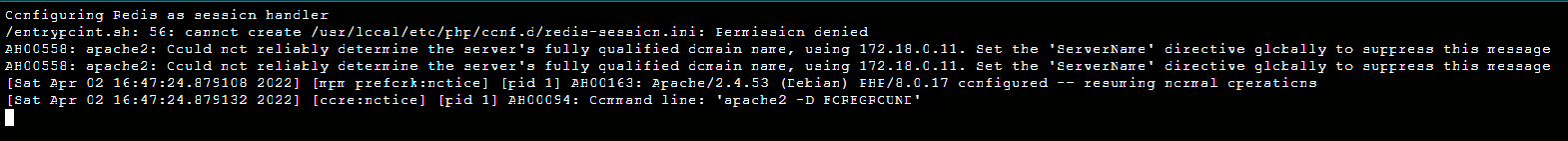

Hey,
I'm trying to get this Nextcloud instance running as linuxserver's LDAP frontend is not working.
I wanted to set it up "properly", so I'm trying to integrate Redis.
After "successful" install, when I'm trying to access the UI, I'm just getting an empty page in my browser:
This is my docker run command:
Nextcloud log says this:
Any ideas what I'm doing wrong? I've tried this template without any changes, with changed "share" volume pointing to the manually set up Nextcloud share, with added redis information, and with added extra parameters and post arguments as described in this support forum on page 1 - all tries ended with the same blank page instead of the UI.
Thank you for any suggestions!

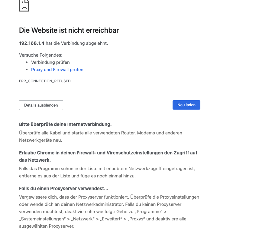

Hey, yesterday my NextCloud worked fine, today i cant acces the Web Interface, Nextcloud app on my Mac Works, can anyone tell me whats going on?
Check the docker logs
