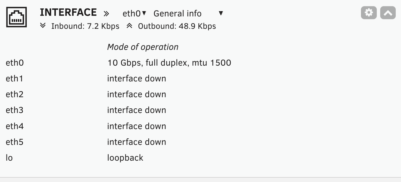

  2. I have 5 network interfaces . The first four are eth0 to eth3 all on the same physical four port card. the next card is my two port fiber card that serve eth4 and eth5. The only physical cable I use is the fiber port on eth4 that goes to my switch. I have the fiber port configured and everything is connected and working. Do I need to do anything to eth0 ? I think Unraid depends on etc0 and it can not be disabled so that is what causes the eth port 0 down alarm that seemingly can't be turned off ? Is that because it is the only port where DNS can be defined ?

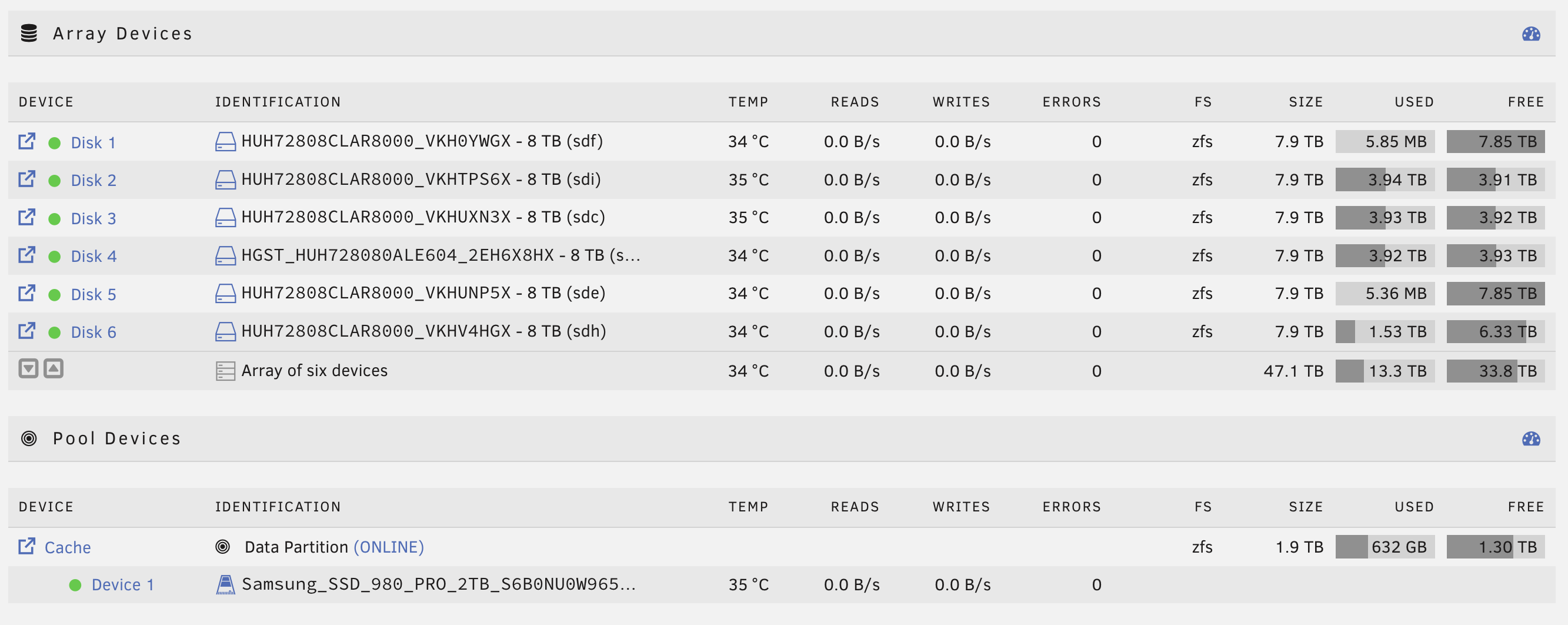

  4. That is so strange... I don't understand why I didn't see any issues. This was a production system and ran with zero issues for a LONG LONG time. The array now says it is running in unprotected mode which concerns me. I wont add parity back but dont that leave the array unprotected ? I consider this somewhat fixed . Thank you for your help.
  5. Good News / Maybe bad news ???? This server has been up for a while and I could not remember the file system .... I did what you said, and the array started BUT it looks like it is ZFS ........ Even as ZFS, I can see my data and at least do a backup on my critical stuff I think ? Is there any risk as is ? this array went down gracefully, before the failure. The power down was due to the utility company working on the power to our subdivision. I gracefully shut the server down before they cut the power. The server had been up for so long, I think there was some underlying corruption on the USB boot drive. SO ...... I think my next step unless there is any objection is to recreate the SMB shares to my NAS and get current with my data back ups. After that I can start to rebuild my docker apps ? Do you see any issues with any of that before I bring the parity drive back into the mix ?

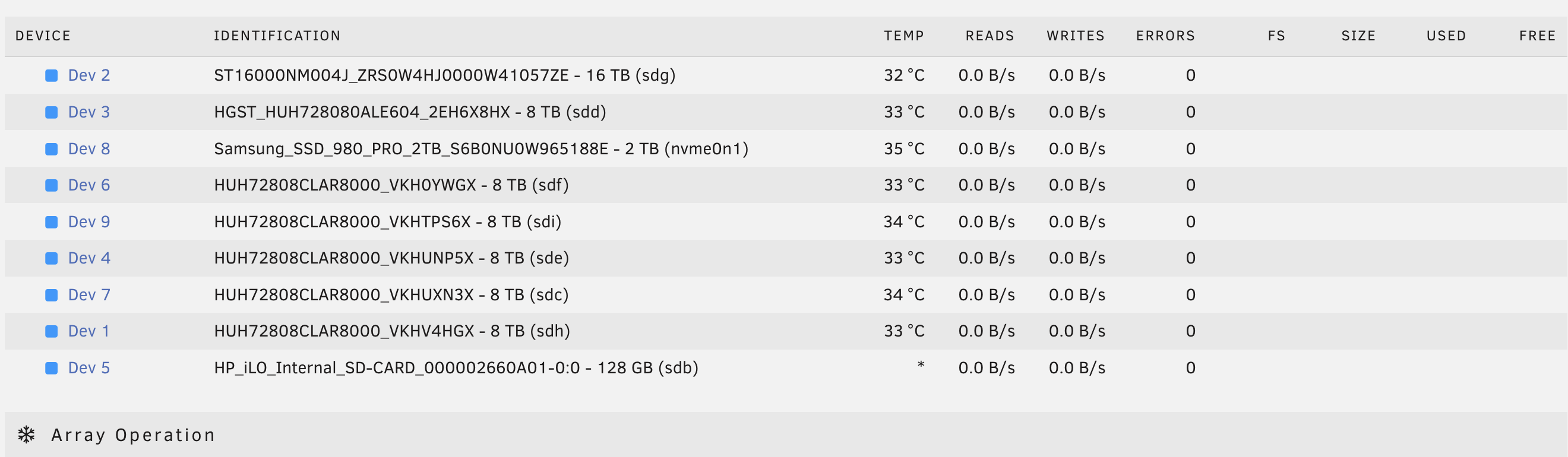

  6. Can I assume that Dev 2 slot 1 is my Parity Drive Slot 2 is blank Dev 8 use to be my SSD Pool I believe Dev 5 was never used, its internal to the system board. Is there a way to tell how Dev 1, 3, 4, 6, 7, 9 use to be ordered ? Am I way off base in having any hope in putting this array back together ?
  7. I had a system failure that completely put the USB drive in a 100% unusable state. I could not recover any of the config folder but was able to reflash the drive. Im trying to understand if I can recover my array. This is a DL380 and I did have a parity drive. can I rebuild this or is it a total loss ? The array most likely has no issues itself but I dont know the order of the drives to put it back correctly , is there a way to see the drive labels ? I'm trying to move slowly so I dont make the issue any worse that it is.
