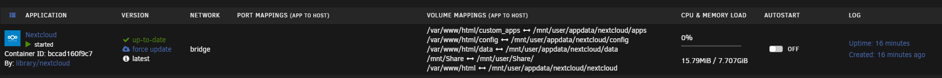

Hi
Since I restarted Unraid my Nextcloud is stuck in maintenance mode. I tried to enter the following command in console
sudo -u apache scl enable rh-php73 -- php -dmemory_limit=512M /usr/share/nextcloud/occ maintenance:mode --off
but I get the reply "sudo not found"
SSH is not possiple. How do I get Nextcloud running again?
Thx for the Help.
You can just run docker exec with user www-data and run occ.
But better take a look at the logs to find out why it Switches to maintinance
Cheers
Gesendet von meinem Redmi Note 8 Pro mit Tapatalk
Cheers
Could you please elaborate on that?
How do I send the comands? Web interface is not working and in console everything I type is been answerd with "not found".
I dont realy understand the log, maybee you can tell me more?
Thx for the reply
