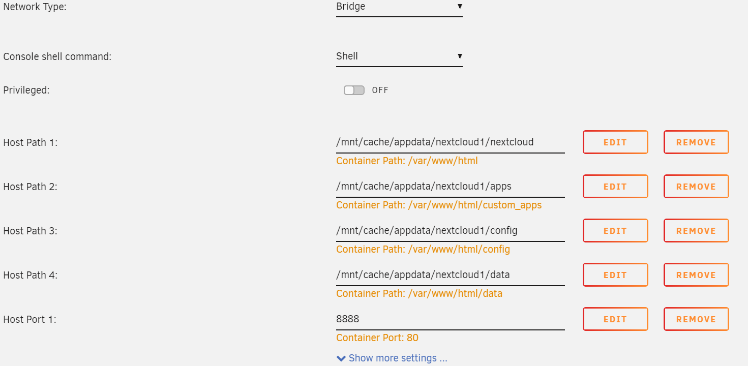

Hi.
Is there a way to use this docker in brigde mode for the network, so i can use mysql? I have no idea how to connect to the mysql database.
Error while trying to create admin user: Failed to connect to the database: An exception occurred in driver: SQLSTATE[HY000] [2002] No route to host
With the linuxserver docker it works.
Yes, I got it working by following the notes near the bottom of the first page.  Change to Bridge and add a port pointing to 80
In my case, port 8088 points to 80.

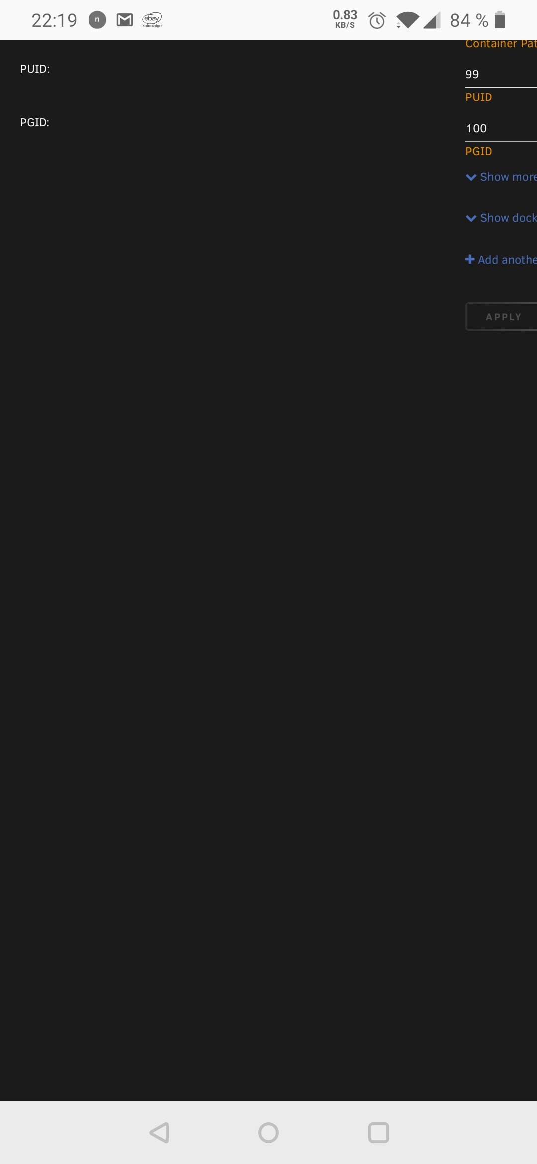

Hi i solved the issue.
I had to add this in the docker container:
PUID:99
PGID:100
Now it works.

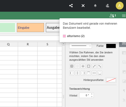

as im testing this solution instead the sep onlyoffice docker may a question, i know i had the same behaviour before with the sep. NC OO Dockers,
but cant remember how i solved it ...
when editing a file in NC with OO, the writeout seems not to work, it keeps the open session in background and the file seems to never writeout to host,
keeps only edited in cache through NC instances ...
the issue was somewhere burried here, open sessions from users ... which is not correct cause i never reopened a seesion,
here u see alturismo would use 2x, when i refresh its 3x, etc etc ... and never writes out.
also not by hitting the "x", ... also no errors ... i just cant remember what it was ;)
i thought it was a cron thing, but as cron doesnt seem to work in this docker by default ... ;)
may someone has a tipp, thanks ahead

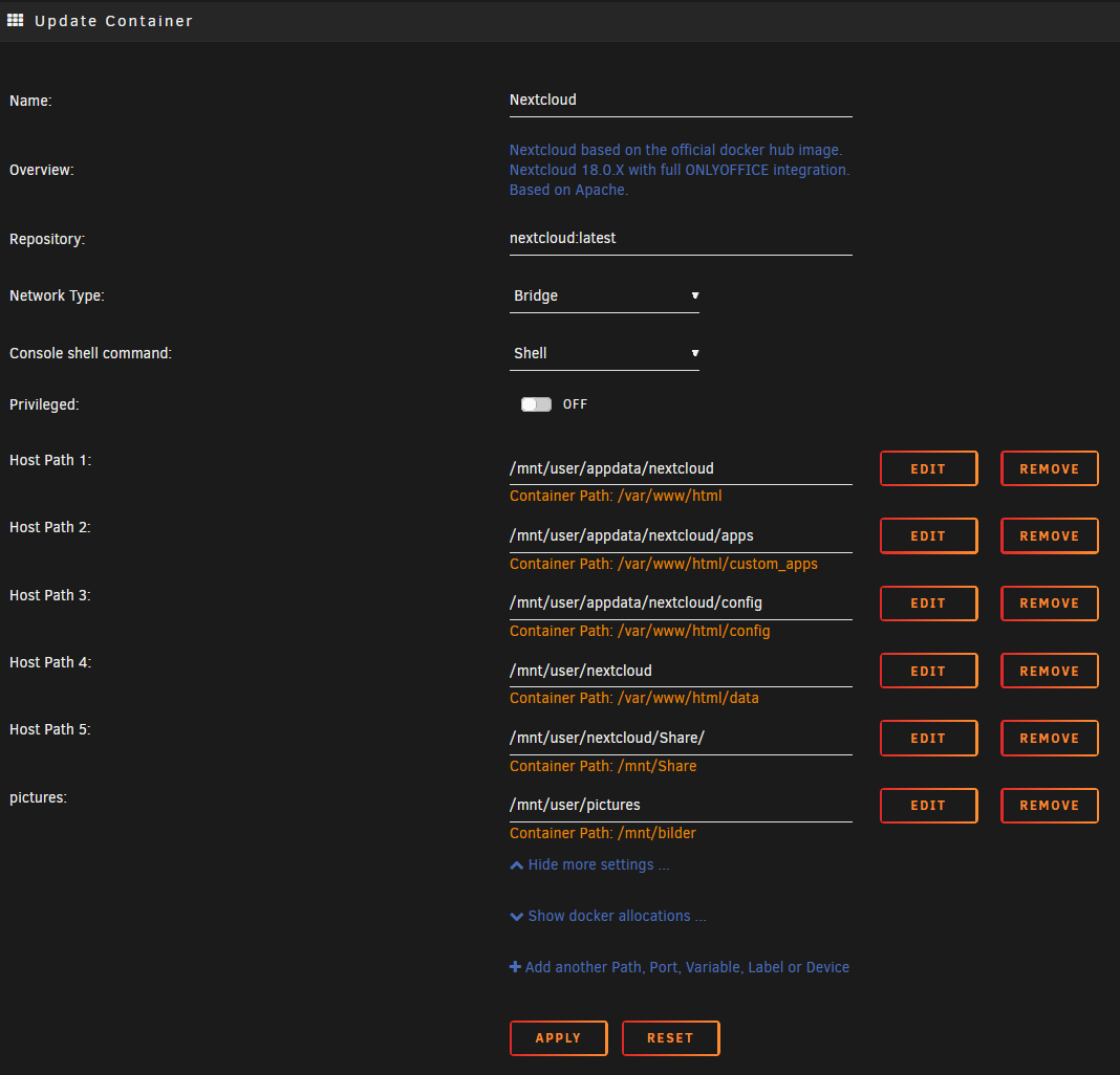

5 hours ago, Abigel said:
Now I have the problem that users can't edit, delete or create files
Hi, are you using the right GUID UID?
Did you volume mount the share as read/write?
Hi, yes I think so. Read write is set and the following is for guid and uid, like OOmatrixOO
Nope, that aint work like that. Please read first post of this thread carefully (folder rights)
Okay I have tried that as well
Extra Parameter:  --user 99:100 --sysctl net.ipv4.ip_unprivileged_port_start=0 -p '9083:80'
Post Arguments: &&  docker exec -u 0 Nextcloud /bin/sh -c 'echo "umask 000" >> /etc/apache2/envvars'
But it still don't work. Is there something else wrong?

ok, after some tests and some more digging
it is a cron thing to get the writeout (like i remembered), but here its a bit more todo in this docker, sample, the command to force would be
php occ documentserver:flush
which could also be used in unraids cron, but may cause issues while file in use ... not recommended.
this should be triggered by the system cron job, but as we see the system cron is not working in this docker ...
so i played around with the hints given here and use unraid to call cron
now, prerequest is, user has to be logged out that the system cron will trigger the writeout (flush command is done system cron),
as we know most likely just the browser tab gets closed ... by default the user will stay logged in as u can test by simply reopen NC,
there is no login prompt, just simply on your main page already logged in.
so im testing now with the following settings to force a inactivity logout
  'remember_login_cookie_lifetime' => 1296000,
  'session_lifetime' => 3600,
  'session_keepalive' => false,
this should kick out after 1 hour when nothing happened, then the next cron should do the writeout ...
so in sum
logout manually -> system cron should do its writeout job
logout forced by settings --> system cron should do its writeout job (still testing)
no logout, run the flush command ... will force a writeout (keep in mind, may data loss while active in file)

43 minutes ago, knex666 said:
I need more Infos on that.
Do you mean ONLYOFFICE or are you not able to edit, access files on user-shares on Nextcloud?
If its about ONLYOFFICE - please send a screenshot when and how that happens.
Please send me a Screenshot of
* the folder rights of you mounted folder (ls -al)
* how you mounted the share (container configuration)
* how you configured the user-shares in Nextcloud
More on Discord - should be easyer.
Cheers
It is when I am using ONLYOFFICE and just found out not only in a share, also in any other folder.
By creating a file, a new browser-tab opens and there is only the message "Loading... please wait."
But it stays and nothing happens, also with other users meanwhile.
Then when I reload the cloud page, the file is there. But a new tab opens and it says the following: "File not found
The document could not be found on the server. Perhaps the share has been deleted or has expired?"
If the admin creates a file and share it with me, i can open, edit and delete the file.
The screenshots are in the attachement
Do you need something else?
Sry I don't have discord and my headset is not in my apartment right now

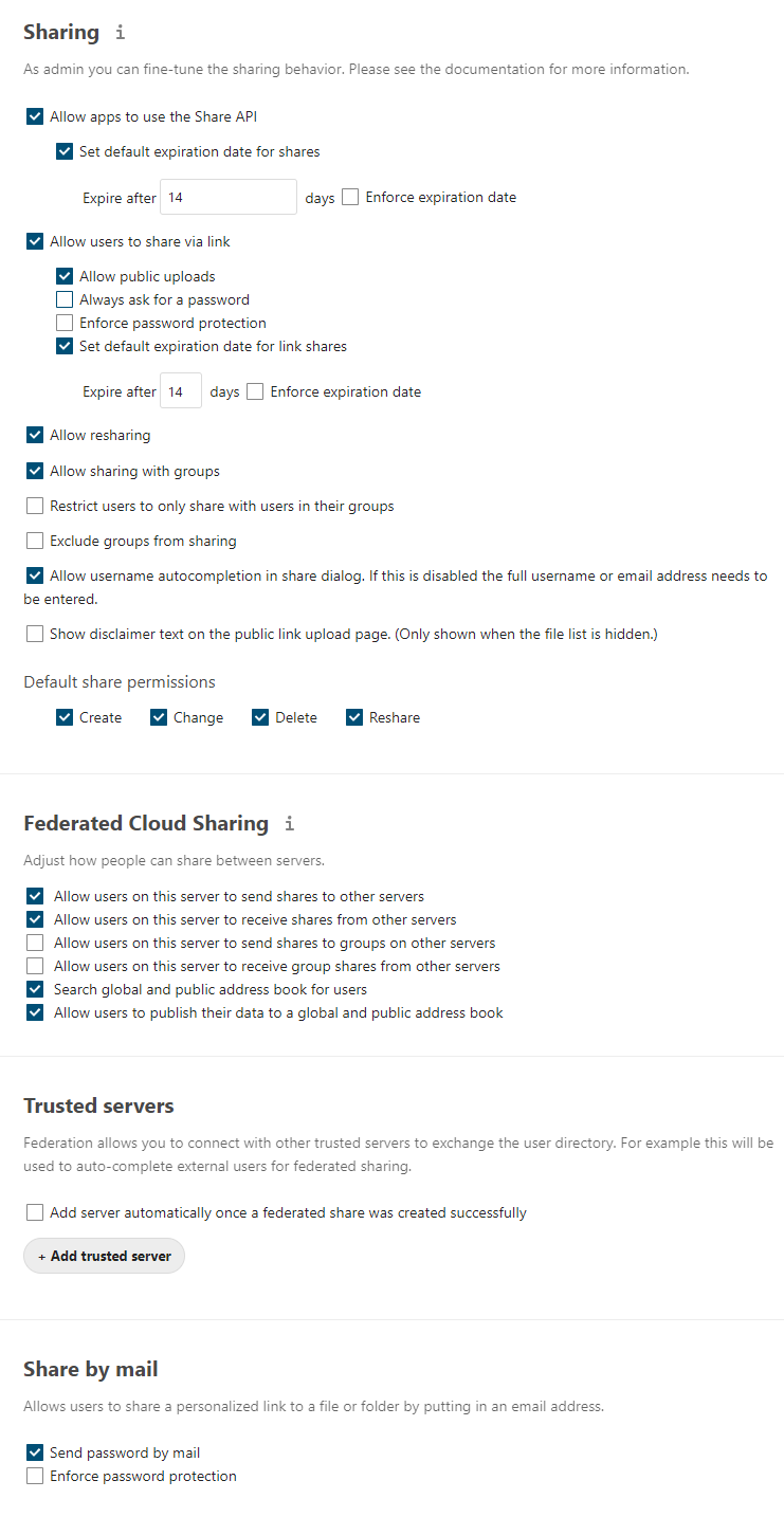

I try to recreate your problem. First I thought its about "external devices" and user shares of unraid -my fault.
I created a file share_test in a folder - but even my file rights are
-rw-r--r--  1 www-data www-data       6998 May 30 07:16  share_test.docx
which should not be the problem.
I clicked on share but I dont have the options to set allow xy I just have the option to share and to allow editing.
after sharing I tryed to edit the file in another browser as guest - without any problem.
So am I missing a step?
Cheers
