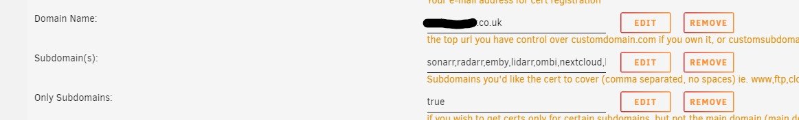

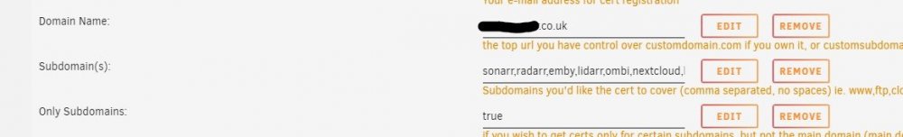

I already have a previous installation on my server following spaceinvaderones guide.
I would like to install this one on a new server similtaneously on another domain until in a position to shut the previous one down
Unless I am missing something I would need another instance of letsencrypt?
I am probably (hopefully) overthinking this but I have been really struggling to get this working.
can anyone confirm if it is possible or and even throw in a pointer or two if it is! 🙂
Edited by mbc0
Hey, this is no problem. I have 2 instances one for my private stuff one for friends.
You just need a new entry in your letsentrytp config that points your new subtomain to this instance.
I have both running on br0 on IPV6 thats why it was very very easy to get this working.
Cheers
Cheers
ah, this is good new! 🙂 Thank you!
I presume you dont mean you do this by filling out the template as there is only room to put one domain, unless is it comma seperated? or do you add another variable to the template?
