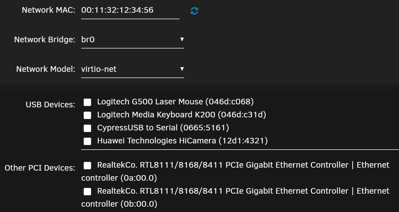

  1. YES! This is exactly what I wanted to do... but doesn't seem to work :( What I did: Did a vfio-bind of my dual realtek card Like so. then added two virtual MACs ending with 56 and 57. Didn't work. Removed the virtual MACs. Didn't work. Can you share your xml?
  2. I just did a 3615, with a vfio bind of a realtek card that I know worked bare-metal. Connections keep dropping out for some reason over time. Does anybody know why and how to fix this?

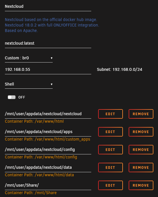

  6. Very sure. This is my image config: And I recorded a video. But hey, it works at the 3rd time of install lol! Steps I did: 1. Open a terminal in unraid, and rm -rf /mnt/user/appdata/Nextcloud folder 2. Created this image and run it 3. Start the install. Note that it says some apps failed to install, not sure which app. During my first and second try, it didn't mention any error. 4. This time it... works! Not sure why. I made a video, fast forwarded most of the really long parts this time. Slightly longer than a minute. I don't mind talking via discord. I'm at the unofficial unraid discord server https://discordapp.com/invite/qWPbc8R nextcloud.mp4
  7. Yes I did. Didn't click on anything, no errors. This is my 2nd install, still no go. Gonna try a 3rd time lol. I don't suppose I have to install a separate onlyoffice container first?

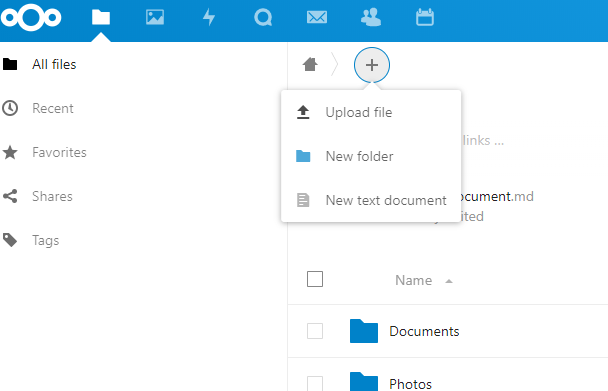

  8. Am I doing something wrong? I wanted this container because it has onlyoffice built in, and I've never ever been able to install onlyoffice before for some reason. But added this docker, ran it, and supposedly I should be able to just click on + and create new word or spreadsheet straight away, right? Only thing I did differently when I added the container was setting a static IP to 192.168.0.33.
