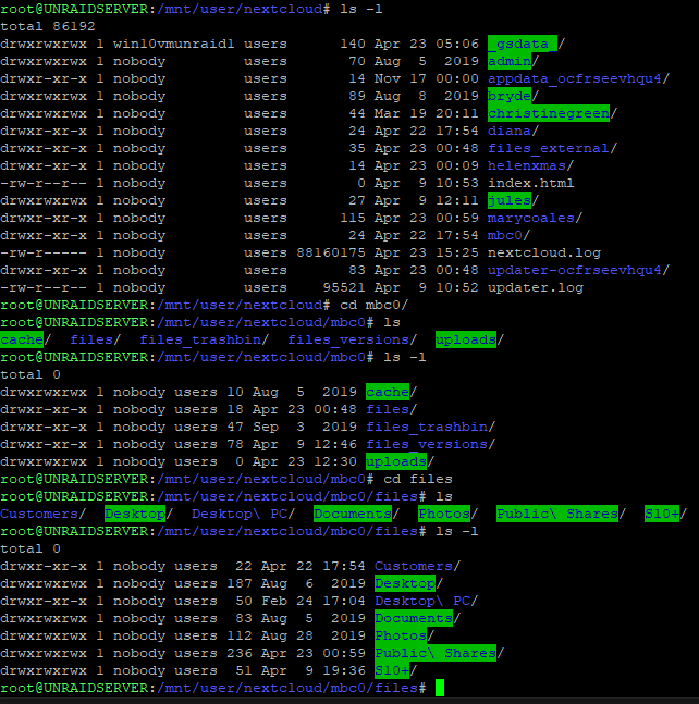

Hi, Something has changed with my installation/unraid?
I have always navigated to my unraid nextcloud share and dropped new files in my files folder but now I do not have permission?
my username is mbc0 and you can see that some users have changed permissions, some have not?  I can obviously chmod to resolve this but worried it might break something? is it ok to do so and any idea why this could have changed?
Please read the first Thread-Post "FOLDER RIGHTS" to solve this problem right away
Hi, many thanks for this! did something change in an update recently to require these pre & post arguments to be put in place as I have never entered them before.
I am obviously doing something wrong! althought the perms are now fixed and I can access the files in my shares again the docker will not longer start

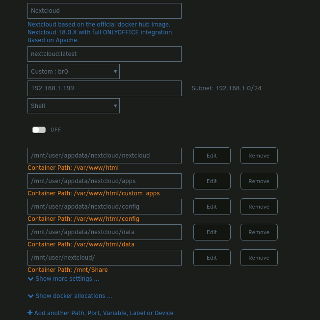

Hi folks,
I had a LSIO image before up and running. But I want to use this image now. So, since no important data was saved in the old docker image, i decided to make a clean cut and start from scratch.
I tried to install this docker image with all settings but i get this error in the log:
AH00558: apache2: Could not reliably determine the server's fully qualified domain name, using 172.17.0.7. Set the 'ServerName' directive globally to suppress this message
[Sat Apr 25 23:12:52.185872 2020] [mpm_prefork:notice] [pid 1] AH00163: Apache/2.4.38 (Debian) PHP/7.3.17 configured -- resuming normal operations
[Sat Apr 25 23:12:52.185925 2020] [core:notice] [pid 1] AH00094: Command line: 'apache2 -D FOREGROUND'
What does this actually mean?
these are my settings attached....
Thx for your help!!!
10 hours ago, hundsboog said:
Hi folks,
I tried toWhat does this actually mean?
I tryed to install it with your settings and I got the same message but it does not stopped me from accessing nextcloud and setting it up.
So I guess its just a warning.
Did you came further installing it?
Cheers
Cheers
Hi and thank you so much for that quick answer! Well, to be honest, no, still stuck there.
Maybe it helps, if I describe the setting a little bit more specific. Like I said, I had a nextcloud instance up and running with a Mariadb, a letsencrypt and a duckdns docker.
So my plan was, just to install a this new instance, connect it to my Mariadb in a later step and use it just from my internal network. The other dockers are switched off, but for some reason, I cannot access the WebUI. I also removed all residues from the old nextcloud instance in the unraid terminal like a user before with the
rm -rf /mnt/user/appdata/nextcloud folder
call, but nothing, the WebUI still remains unaccessable with that error apache log. But good to know, that this log doesnt keep one from starting the NC instance and runs like in your test.
So, is there anything, I am missing? Would you please so kind, to make a setting screenshot for a bulletproof and idiotsafe start of the NC template? Its really embarassing for me 😄
