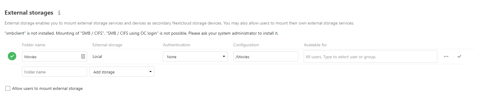

I try to mount a share with the External storage app but I get this message: "smbclient" is not installed. Mounting of "SMB / CIFS", "SMB / CIFS using OC login" is not possible. Please ask your system administrator to install it.
How do I install smbclient?

I try to mount a share with the External storage app but I get this message: "smbclient" is not installed. Mounting of "SMB / CIFS", "SMB / CIFS using OC login" is not possible. Please ask your system administrator to install it.   How do I install smbclient?
Hi,My First question: you want to Mount other cifs files not your shares from unraid, right?Else use Volume mounting for your shares
Second: Check if php-smbclient is installed to the Container.

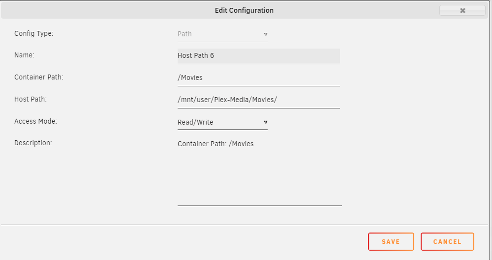

Thank you! Yes I wanted to add a share from my unraid shares to nextcloud.
I added the an extra path to the nexcloud docker like this:
And then added to nextcloud like this:
