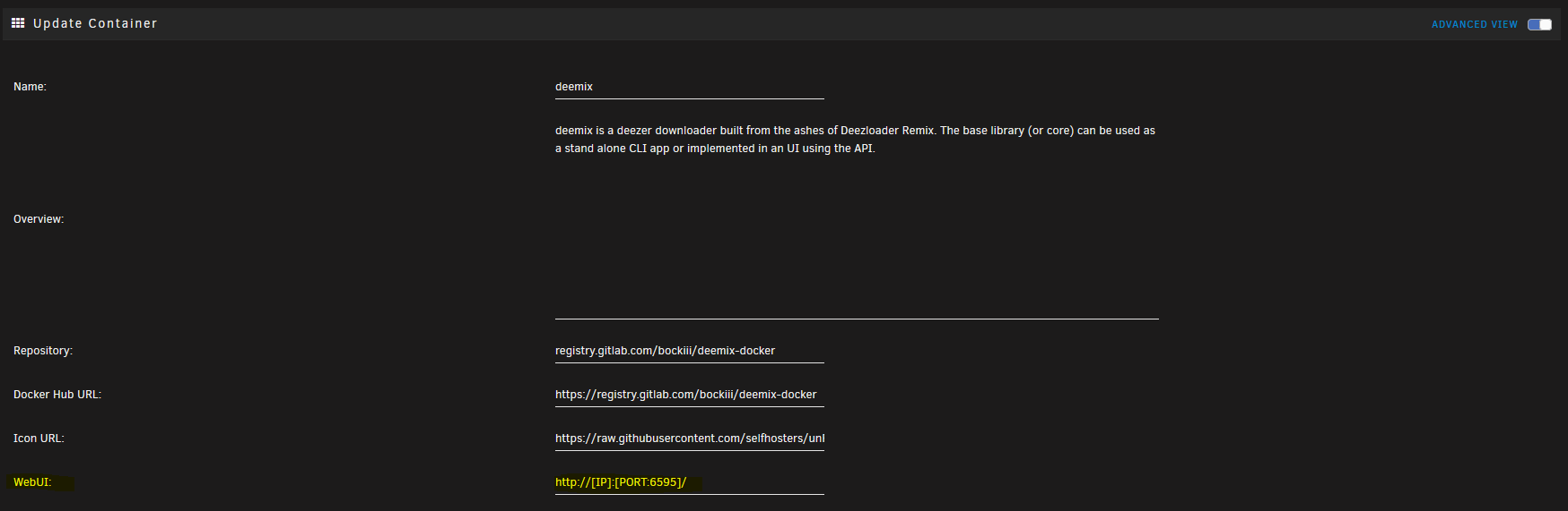

  13. In the template add a new port 6595. You will also need to change the port for the webui (visible when you enable advanced). If it still does not work try a force update. remember it will take some time to install the software again (you can check to log to see the progress)/.
