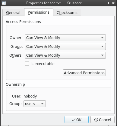

  15. Just downloaded and installed the Deemix docker and it looks really cool. Just having 1 issues, when music is downloaded and I want to change something or remove something by accessing the share it seems I do not have the rights to do it. Looks like only the original user (nobody) has the rights to change or delete the files. Would it be possible to change it so all users can modify/delete files?

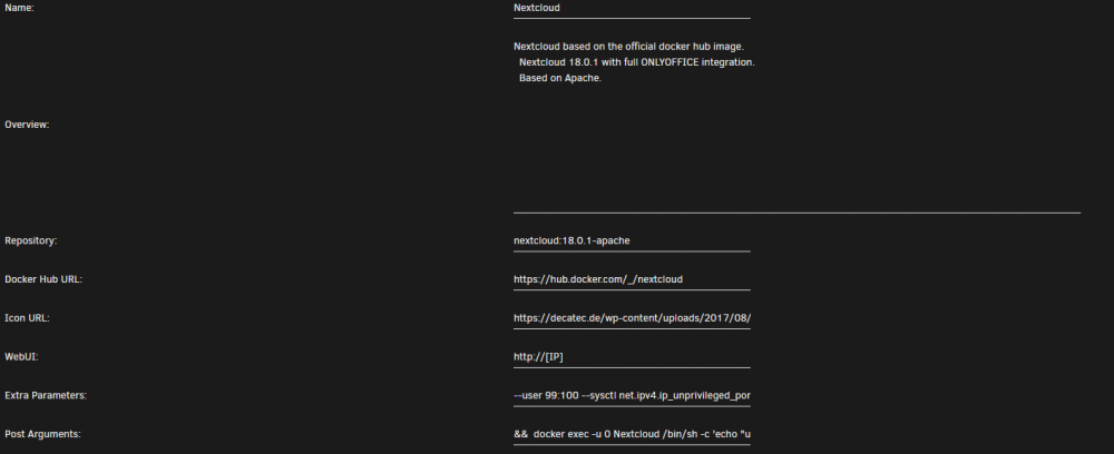

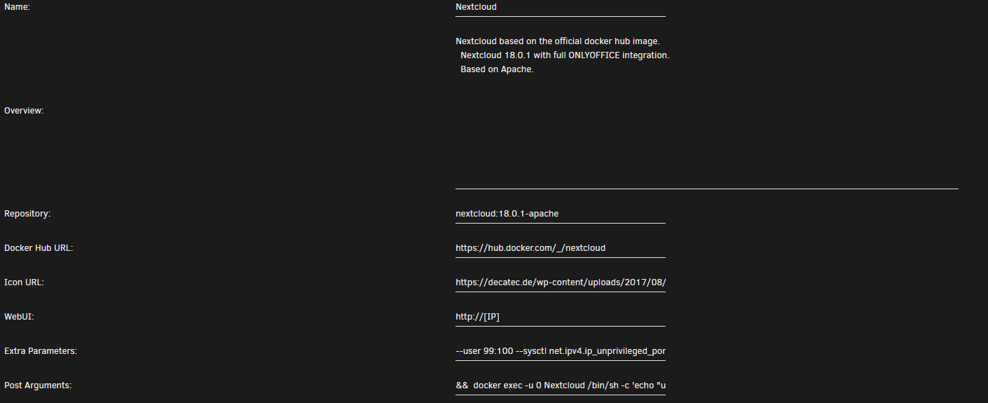

  18. I found a way to get it running in Unraid !!!! In advanced view under extra parameters put: --user 99:100 --sysctl net.ipv4.ip_unprivileged_port_start=0 This makes sure you run the container with the right UID and GID Then under Post Arguments put: && docker exec -u 0 Nextcloud /bin/sh -c 'echo "umask 000" >> /etc/apache2/envvars' This adds the right umask to the envvars file. Now new files created have the right access rights for Unraid: Please let me know what you think?
  19. Does this mean I have to run this exec manually after each pull myself? Or will you automate this somehow? Not sure I understand correctly.
  20. No scripting expert, but I guess something like this would work: grep -q 'umask 000' '/etc/apache2/envvars' || echo "umask 000" >> /etc/apache2/envvars I tested it and it seems to run as expected. Also adding this line gives the required rights to everybody. I could edit and change files created by Nextcloud without issues.
  21. I already set the docker user to 99:100. The problem is that the umask of netxcloud user is set to 022. Which means only the user has write permissions and not the group. It should be 000 for Unraid. As I said in my previous post, you can do this by editing a file inside of the docker. But Any update to the docket would overwrite this.
