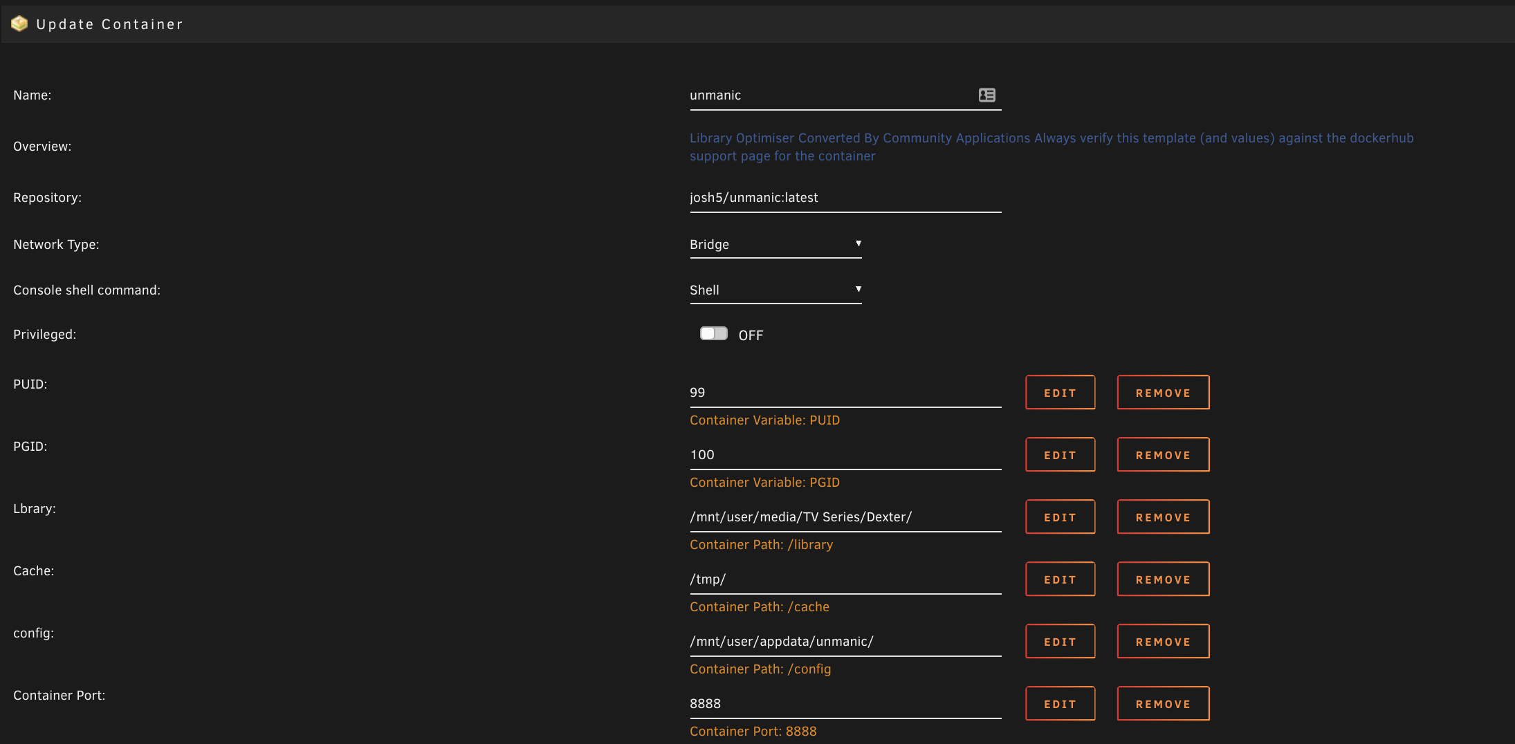

Not sure if this is 100% correct but working for GUI
Still the same.  I've reinstalled, applied settings as yours and rebooted unraid.  Anything else I could have missed?

24 minutes ago, Ashe said:
Just check the cache section, I've labelled it cache
Have you got anything else running on 8888 already?
Nothing else running on 8888.
Cache looks ok too.

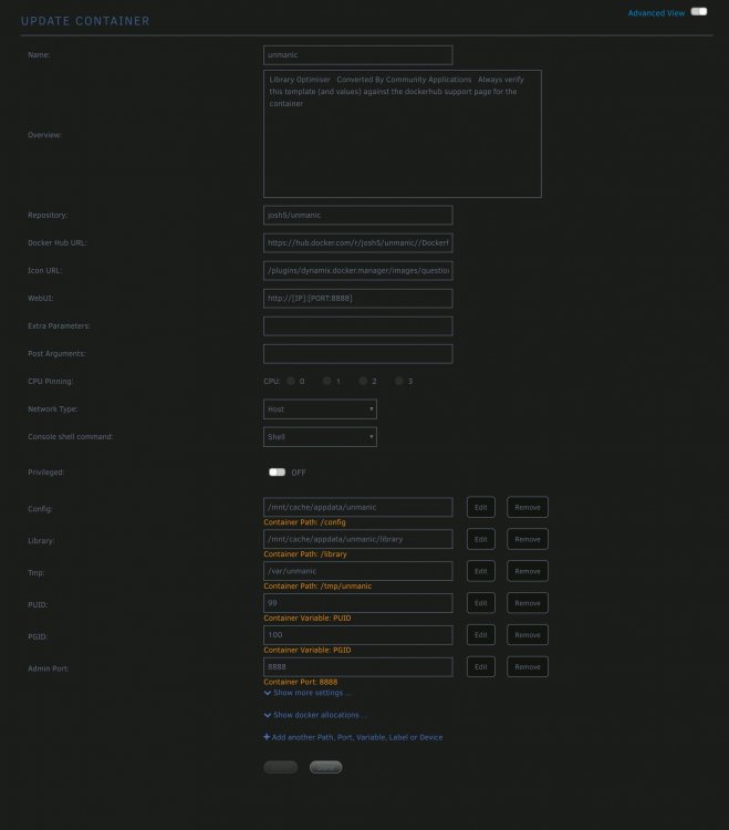

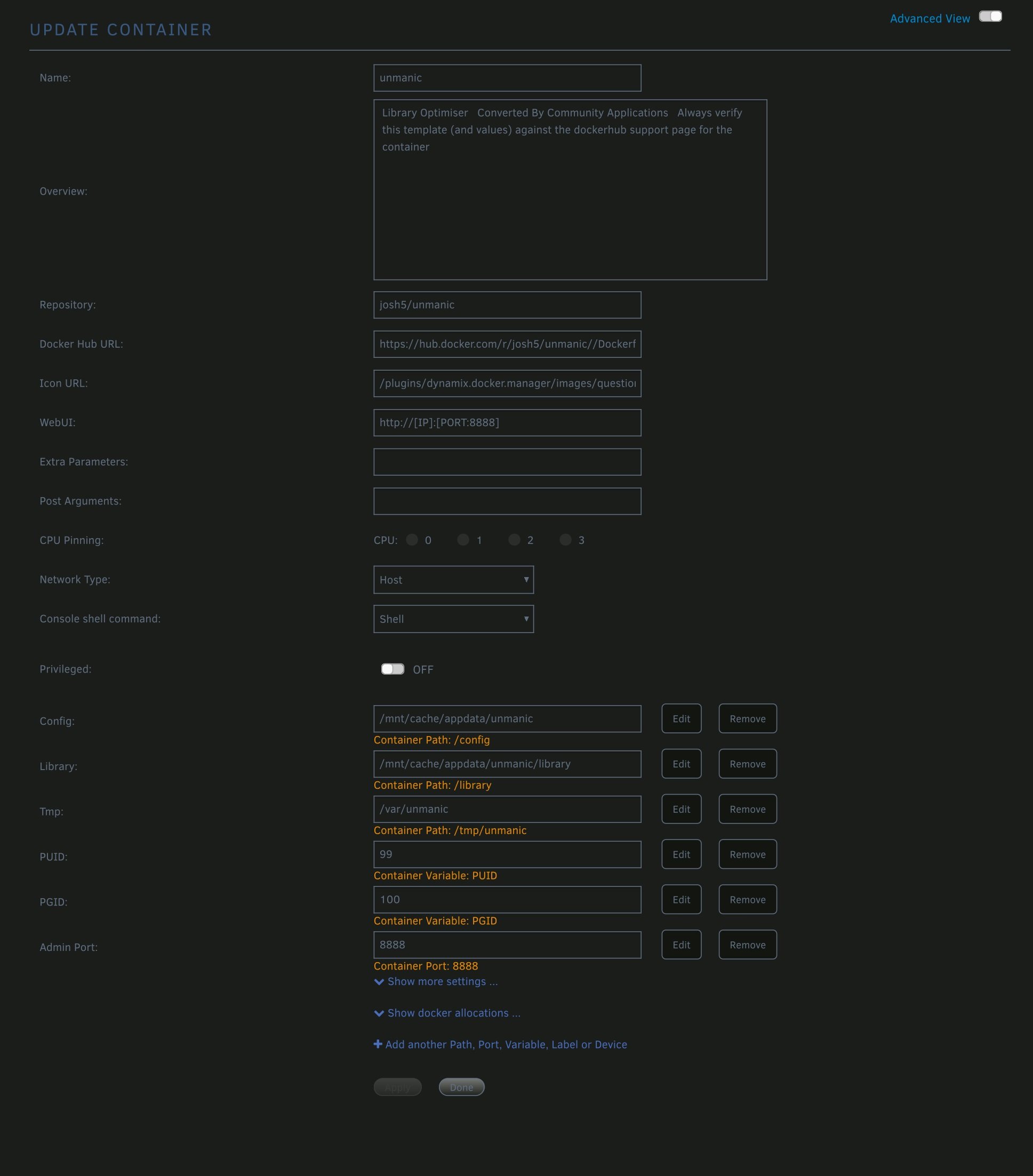

I have mine set as in attached image (based on the example on GitHub)
Point to note are:
  • Advanced view is enabled so that I can set the WebUI entry
  • I have pointed the /library container location to a temporary location on my server as I do not (yet) want my main media library to be scanned.
  • I have pointed the transcoding location to a location that is in RAM on the host.   If you do not want this then point to a suitable location on the cache disk.
  • I have selected 'host' style networking.   This means I have also set up a port mapping entry in case I want to use a different port to the default of 8888.
Point to note are:
Sorted it thanks.  Cleared the cache in Chrome.  Settings were fine all along.
