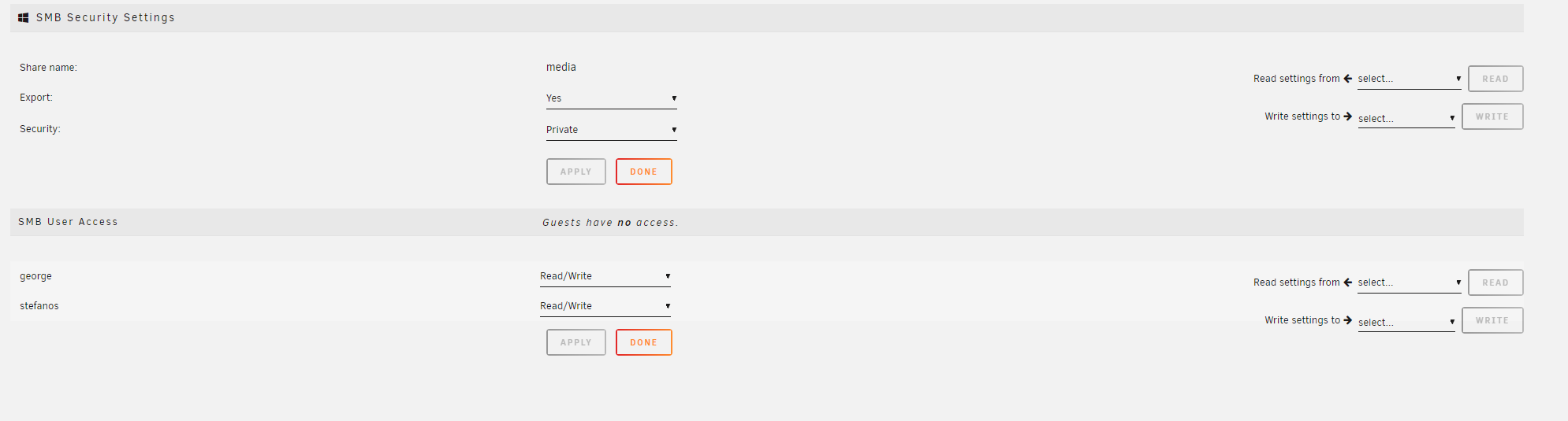

  17. so i made a windows server vm and i want to access my array but i cant connect to my arrays samba for some reason i get this it works fine if i try to connect to my workstation i get the login prompt and samba works fine from workstation and other computers. i can also ping the server ip just fine
  18. I tried logging out and back in again and it still doesn't work. I am logged in with user george that has read and write permissions
