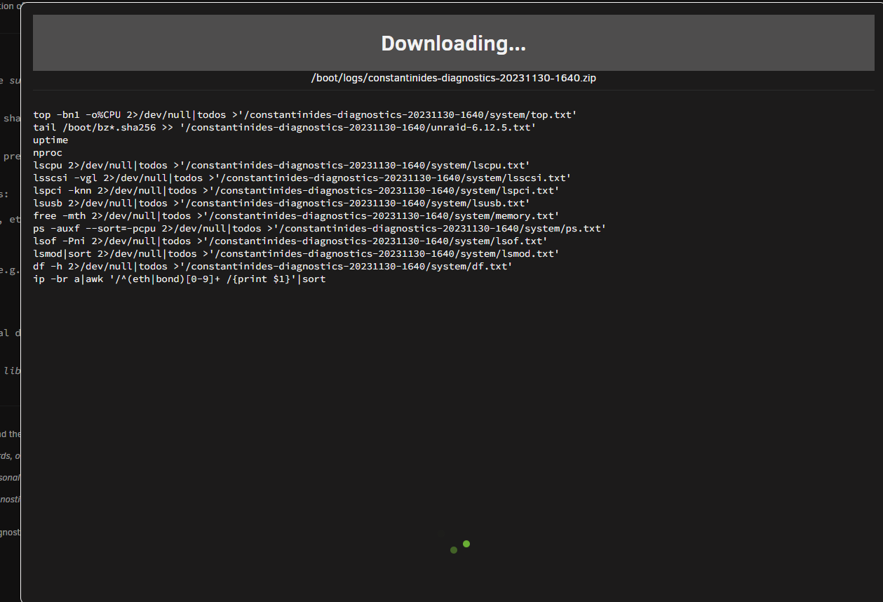

  2. it gets stuck here. its been like this for hours. Downloading... /boot/logs/constantinides-diagnostics-20231130-1640.zip top -bn1 -o%CPU 2>/dev/null|todos >'/constantinides-diagnostics-20231130-1640/system/top.txt' tail /boot/bz*.sha256 >> '/constantinides-diagnostics-20231130-1640/unraid-6.12.5.txt' uptime nproc lscpu 2>/dev/null|todos >'/constantinides-diagnostics-20231130-1640/system/lscpu.txt' lsscsi -vgl 2>/dev/null|todos >'/constantinides-diagnostics-20231130-1640/system/lsscsi.txt' lspci -knn 2>/dev/null|todos >'/constantinides-diagnostics-20231130-1640/system/lspci.txt' lsusb 2>/dev/null|todos >'/constantinides-diagnostics-20231130-1640/system/lsusb.txt' free -mth 2>/dev/null|todos >'/constantinides-diagnostics-20231130-1640/system/memory.txt' ps -auxf --sort=-pcpu 2>/dev/null|todos >'/constantinides-diagnostics-20231130-1640/system/ps.txt' lsof -Pni 2>/dev/null|todos >'/constantinides-diagnostics-20231130-1640/system/lsof.txt' lsmod|sort 2>/dev/null|todos >'/constantinides-diagnostics-20231130-1640/system/lsmod.txt' df -h 2>/dev/null|todos >'/constantinides-diagnostics-20231130-1640/system/df.txt' ip -br a|awk '/^(eth|bond)[0-9]+ /{print $1}'|sort

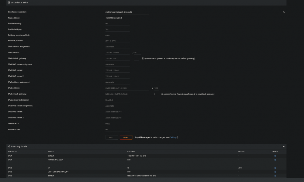

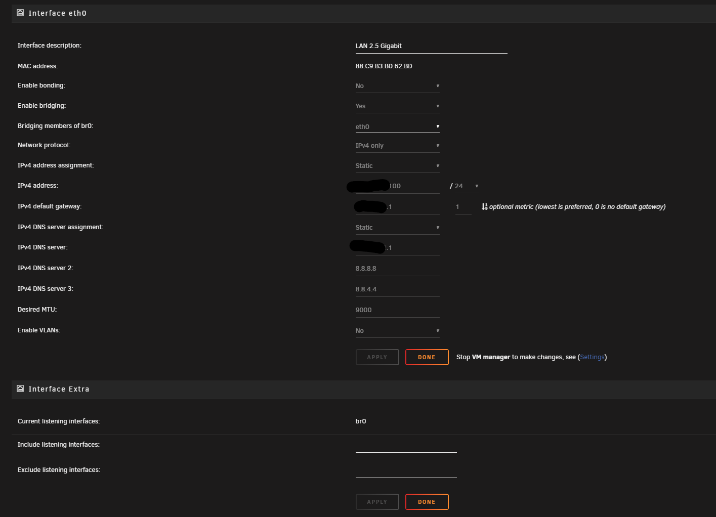

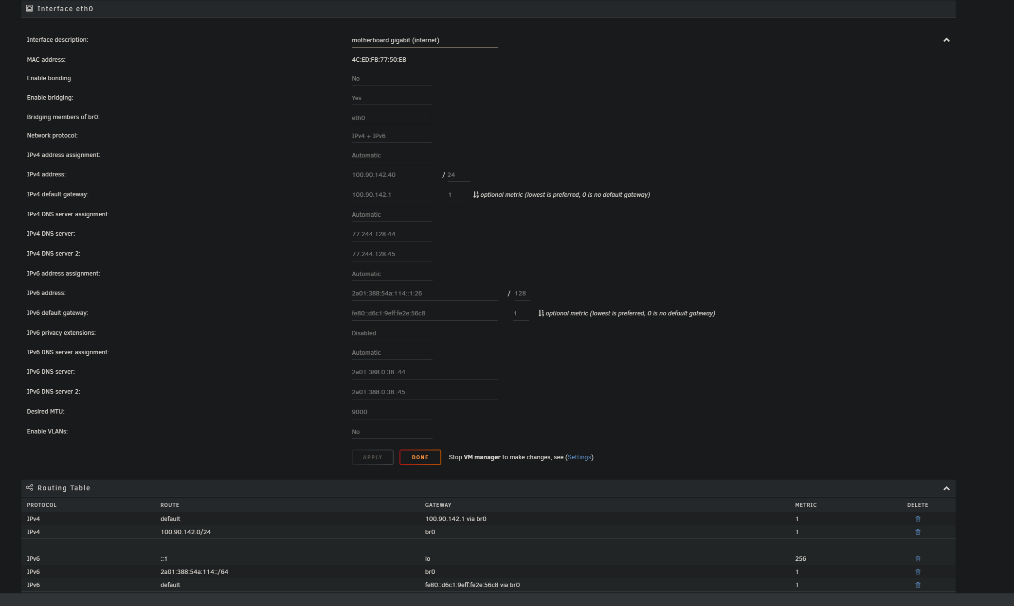

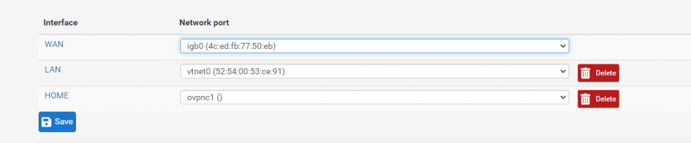

  3. so my set-up is a bit weird but it works and i used it for years without problems. i have a pf-sense vm that i pass through pci the motherboard giagabit that is connected to WAN. i have another virtual ethenet adapter in the vm br0 then i have a eth0 2.5 gigabit adapter that is bridged with the br0 adapter and i connect my laptop to that for internet/server access but for one reason eh0 doesn't bridge anymore. br0 is working because i my server can still access the internet and i can still vpn into the pfsense router to access the server.

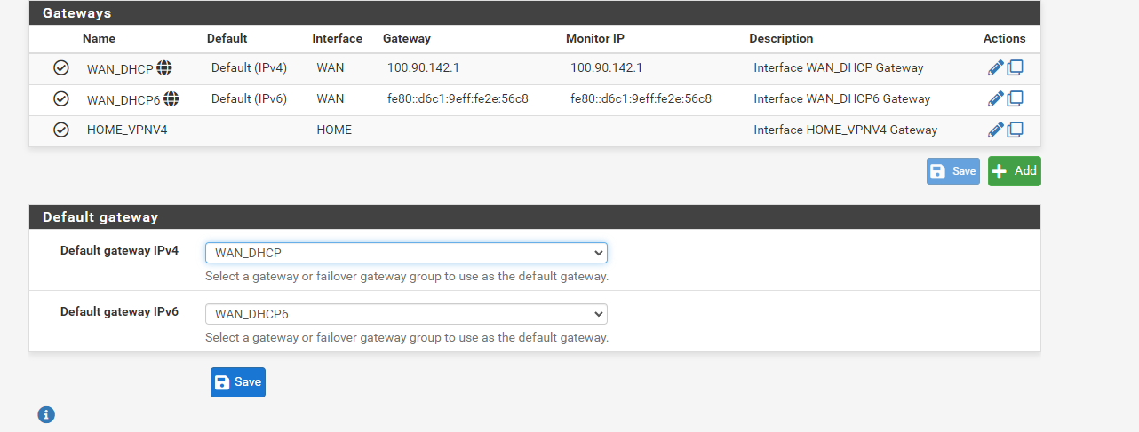

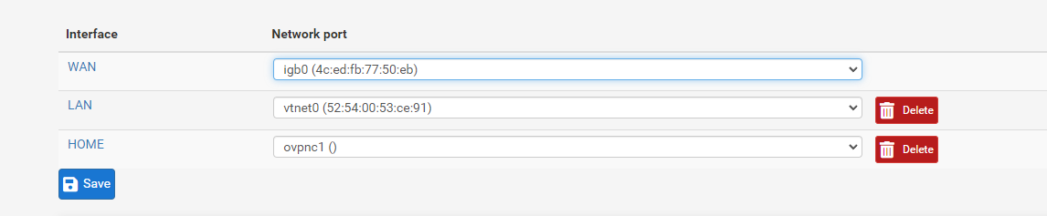

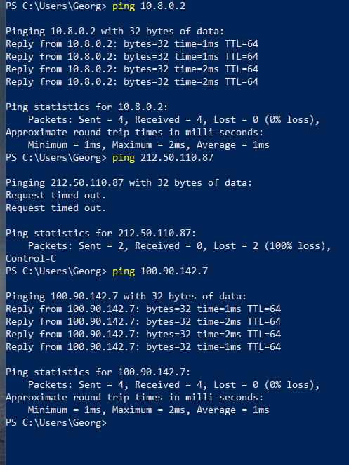

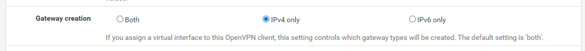

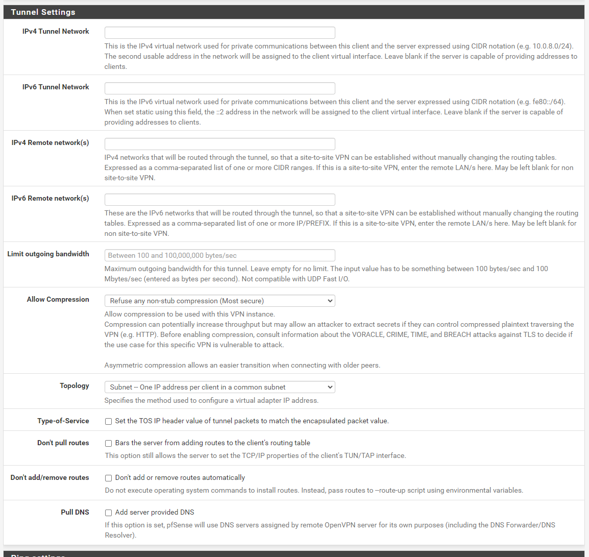

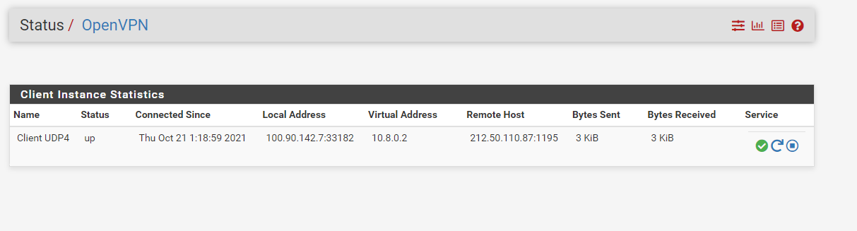

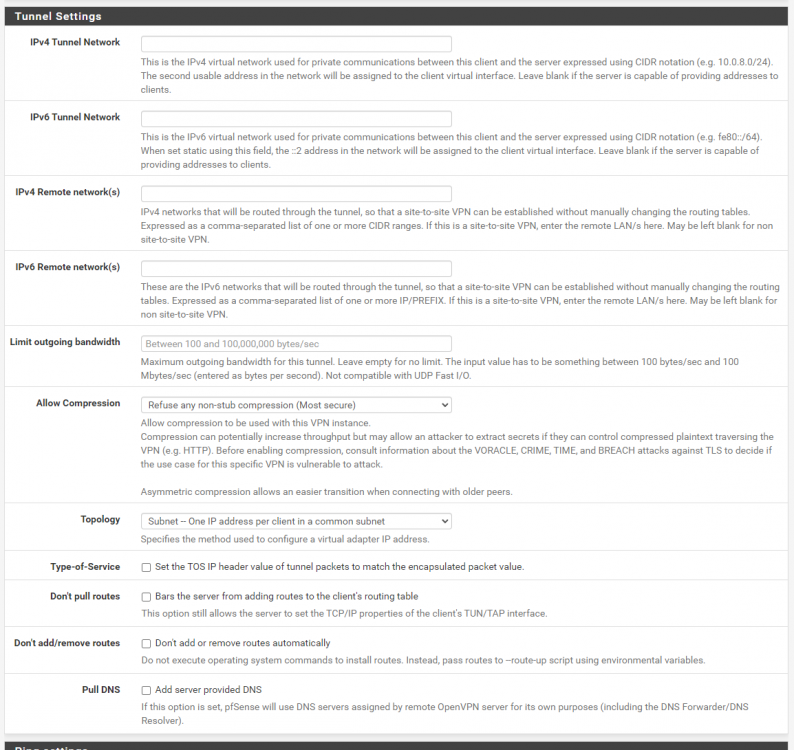

  5. here's the ip i get and heres me pinging them btw I dont know why but after i added the gateway by pressing this I loose my internet connection. so for the time being i have the openvpn service disabled. Also I can't delete the gateway and if i do by removing the interface and re-adding it it comes back because there is no way to un-press the gateway creation button. but I should loose my connection i doesn't make sense since my wan is my default gateway and my only static route is that above. since at home I am not running ovpn on pfsense just on linux don't I do it from the tunnel settings of the client here in my local pfsense?

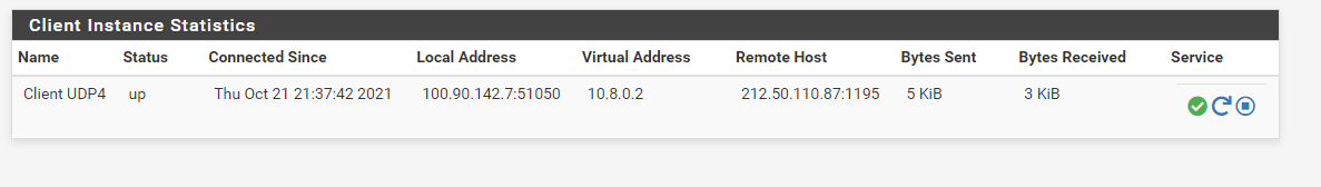

  6. yea wan port is connected to the dorms network so my home network is just a standard isp router and a arm64 ubuntu server running openvpn. from the home server I just generated a ovpn file that I opened and imported into pfsense ovpn client here. the network home is 192.168.0.0/24 here I have my unraid server with pfsense vm. the intergraded gigabit port is passed thru and used as a wan port connected to the dorm internet. then i have my lan port which a virtual adapter bridged with the actual adapter that has a network 192.168.1.0/24 I am not able to ping anything on the home network.

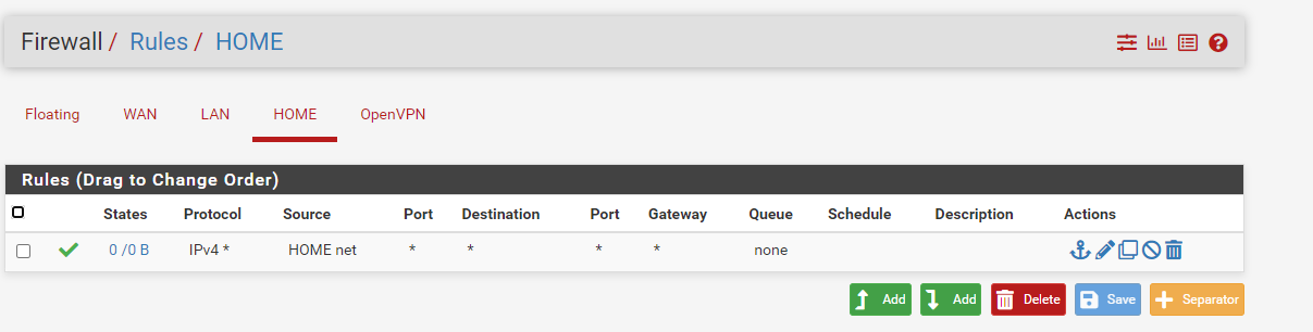

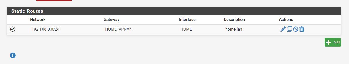

  7. ok now I got local LAN 192.168.1.0/24 home LAN 192.168.0.0/24 (got openvpn running on a ubuntu server at home) I want to connect those networks so i can access my home networks resources, let my family access my recourses and forward plex and nextcloud from there. as of now I managed to connect to my vpn server create a gateway make my interface setup my static route added a default allow to any rule for home but Its not working any ideas?

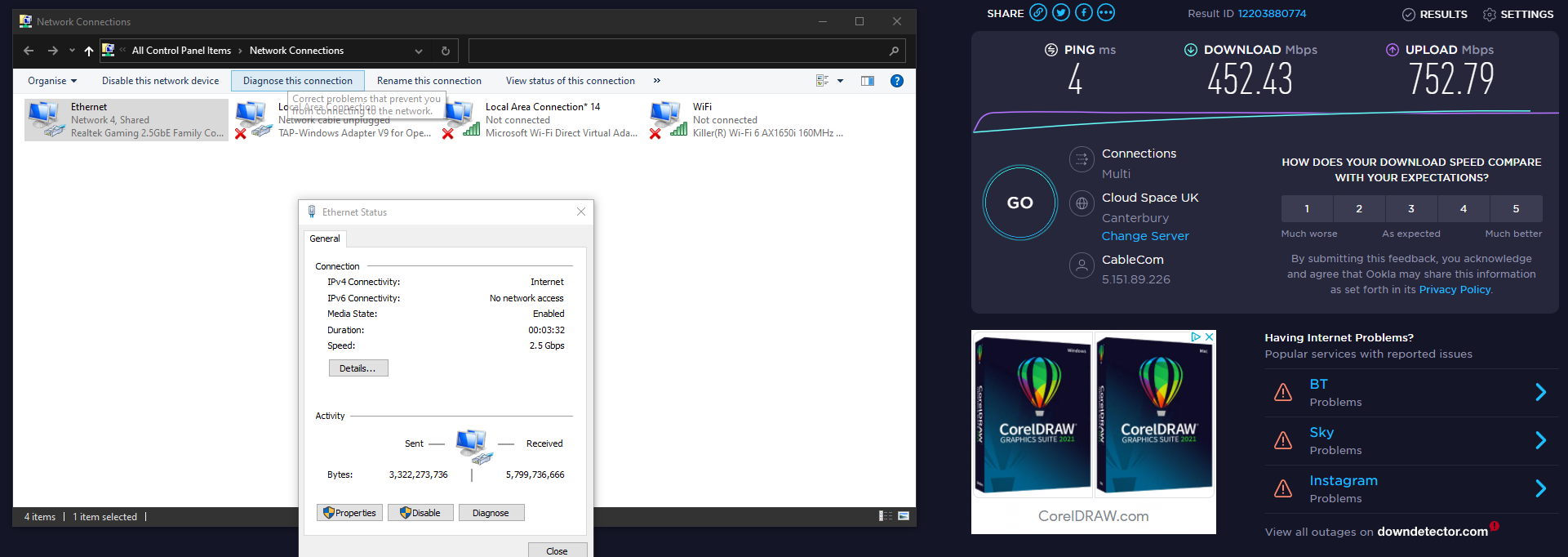

  8. thanks the hybrid solution worked great I just wanted to build a functioning network for my dorm that's it. the 2.5G NIC is connected to my laptop and I can now access both my server and the internet. another reason I wanted this is to be able to re-route some stuff like plex on my ovpn server back home so my brothers can watch.
  9. so is the correct way to get another nic and pass it in for wan. have my lan on the 2.5gb port? if I do this can I connect my unraid server to the lan thru a virual nic so i can use the full 2.5gb rather than connecting it to the lan thru the mobo gigabit?

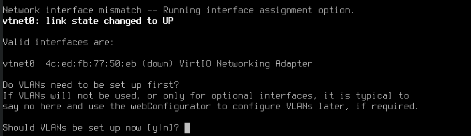

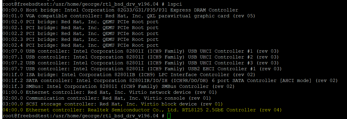

  11. ok so I made a freebsd vm and i can see it this is the nic but I found from amazon.com reviews says that its not compatible with freebsd but i found drivers from realtek website for freebsd 7 and 8 and i am trying to get them to work

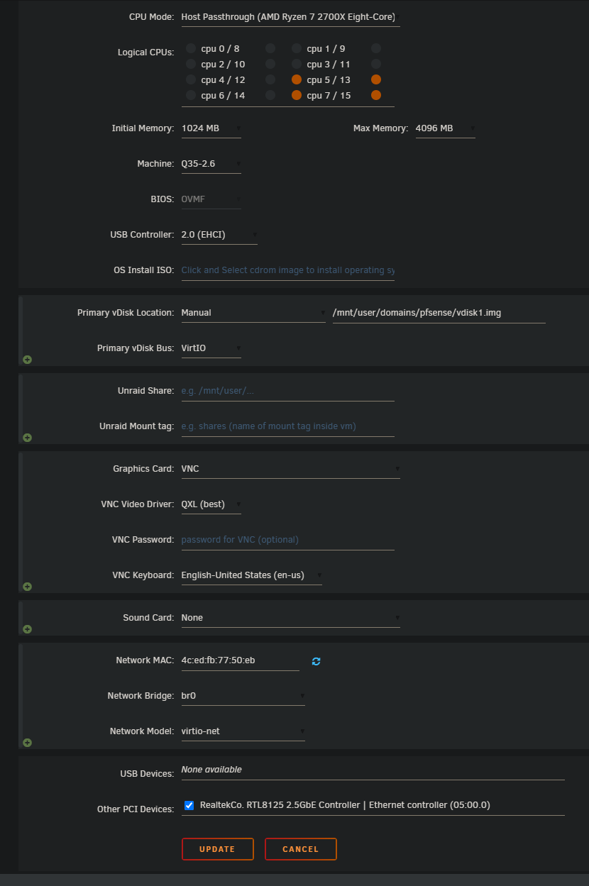

  12. I have 2 nics the onboard and the pcie only the onboard for the wan is virtual the lan is a passed thru
