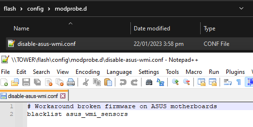

Just open your flash and go to *\flash\config\modprobe.d Create whatever file you like with .conf mines "disable-asus-wmi.conf" In that file paste # Workaround broken firmware on ASUS motherboards blacklist asus_wmi_sensors reboot and random fan stops resolved. I'm not the correct person to explain exactly wtf it does or how it works. But I assume it just makes unraid/linux not touch that fan controller

I can also confirm the fix has resolved the same issues I was having.

it was a fan issue with asus x470 boards and the fan controller that's now in the base unraid/linux image bug out causing all fans to stop after a random amount of time, within a week or so. I have a file in 'config\modprobe.d' named 'disable-asus-wmi.conf' With the text of '# Workaround broken firmware on ASUS motherboards blacklist asus_wmi_sensors' So an update while I was awaiting a reply. I re downgraded back to unraid 6.10.3. tried the usual stuff and failed. Re updated back to 6.11.5 did the usual thing and now it works. I have no idea. but it has persisted through several reboots and transcoding now works on the GPU. Best guess something just stuck initially and fixed itself when I cycled the down/upgrade cycle

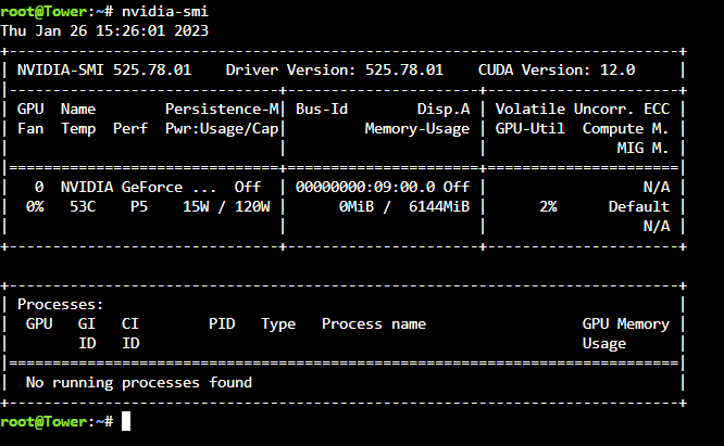

I enabled then killed it. (someone else was having power state issues) Still failed Tried un installing then reinstalling as per instructions and this also fail. Same with force update the weird thing is everything else works Driver picks it up OK an so does nvidia-smi (I did try downgrading versions) Same issue with the plex docker from plex. I would expect this to work but somethings weird So update I think its something to do with /proc/sys/kernel/overflowuid its weird even logged in as root I don't have permissions to delete it or modify permissions

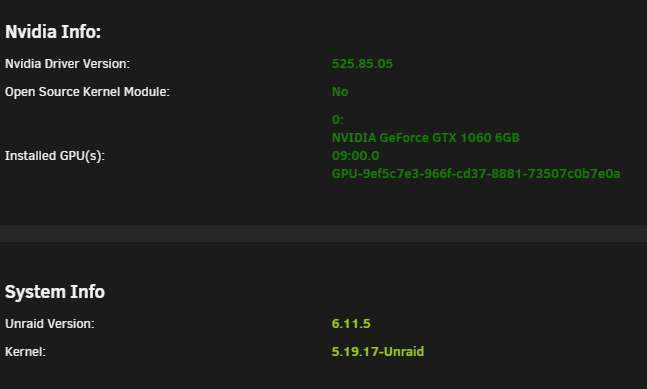

I think I'm finally stuck. updated to 6.11.5 (after some system fan issues) updated the nvidia driver to 525.85.05. I can see it in the plugin but I cannot use '--runtime=nvidia' it just fails with bad permeameter or if I check it I get the below I have tried full uninstall/reinstall with reboots. changing versions etc. Now it did work once when I was looking around with other peoples issues 'nvidia-persistenced' then '$(pidof nvidia-persistenced)' But now it just wont take at all. Im sure its something silly like it always is haha. any help would be huge. diagnostics attached tower-diagnostics-20230127-0816.zip
